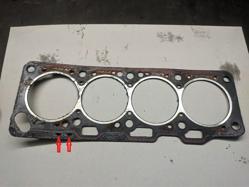

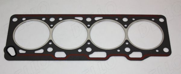

did you inspect the gasket carefully to make sure its correct and not blocking an oilway?
Comparing the Head gaskets, the marked holes were missing within the new head gasket, however I assumed that these do not pass oil through as they are past the red gasket material + the shop I bought it from confirmed that it is for the HZ engine model. Could it be these two holes?
is that a mech tappet engine ?
id agree i think its outside the area that matters
According to Haynes no, its a hydraulic bucket tappet type.
