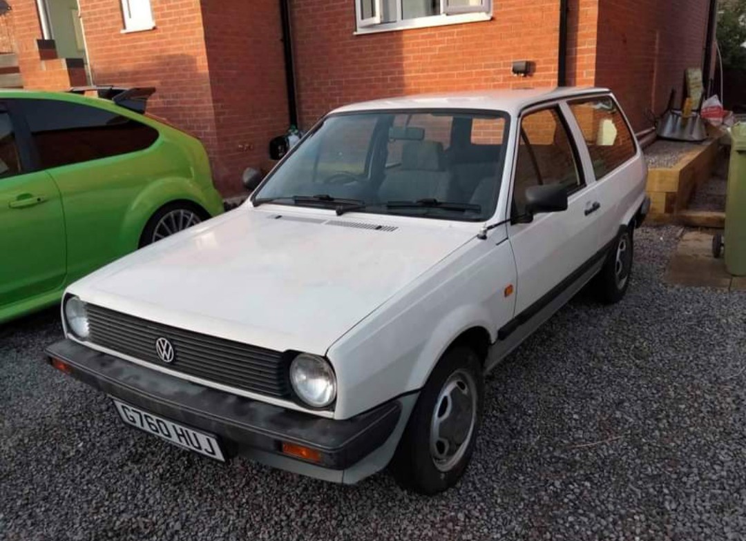

She's a G reg "fox" 1043cc. (We haven't got a name for her yet)

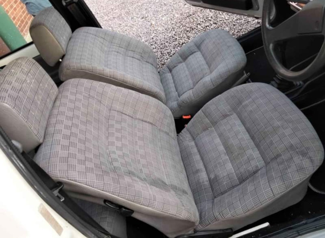

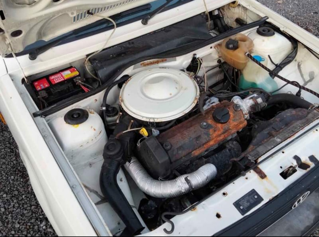

Inside is pretty much immaculate apart from a bit of a wet front carpet (there is a hole in the battery tray shock)
She needs a little bit of work but I am extremely excited to get started. I am not a mechanic by any means but I have owned plenty of modified cars in the past. I am really keen to learn more and more and get better with cars generally hence why I bought a bit of a project.
The car is being stored at my cousin's unit (he is a welder fabricator by trade) and he is going to teach me a few bits here and there.
The car was taken off the road for 5 years and has been stored since. In 2016 there was a couple of advisories for ball joints and top mounts and brake pipe corrosion. A little welding is needed on the two rear quarters and the battery tray but apart from that I think we are looking pretty good.

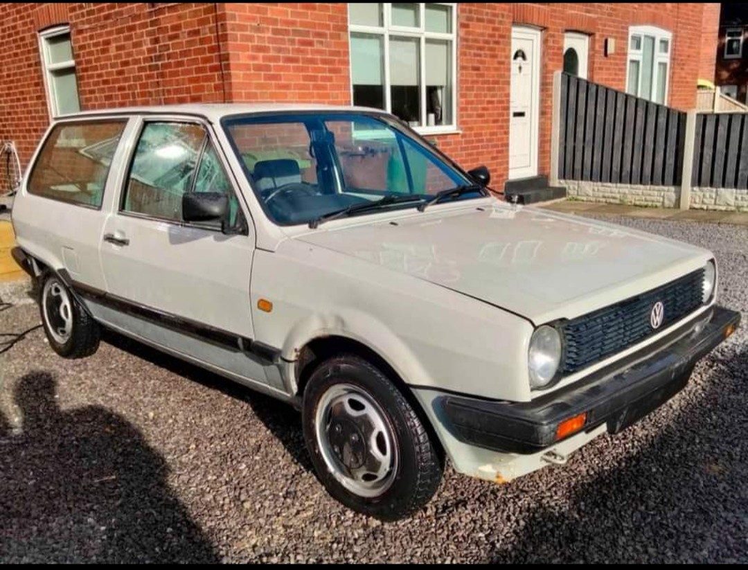

My Breadvan is an 1989 Fox and is virtually ‘as standard’, which is how I bought it back in 1999.
The only addition is a black surround on the tailgate window, which other versions  of the MK2 have fitted.Looks like yours has had some side trims fitted on the doors and the bottom half painted a different colour.The base model  Fox didn’t have neither of these out of the factory.
If it’s leaking into the footwell you may also find water is getting in round the windscreen surround rubber in the bottom corner, they rust there as mine did.
Mine also had rust problems around the front jacking points so water was getting in from all directions!
It also had the same heater problem, that’s caused by a faulty heater resistor.
