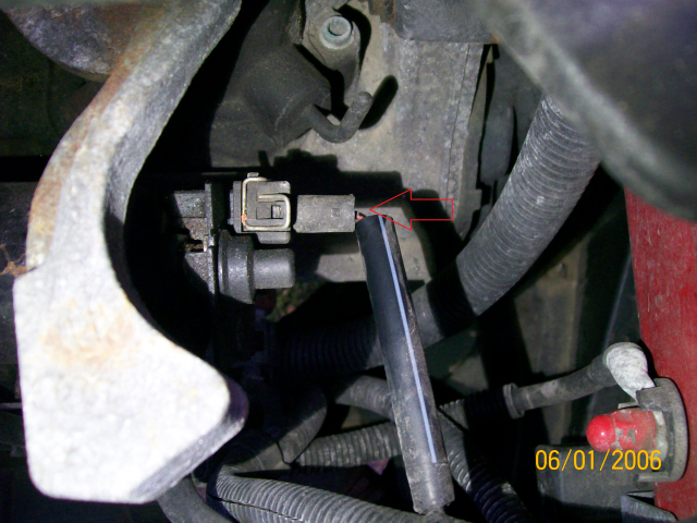

Down by the gearbox, this is on a 1.2 Fabia 64bhp where the battery isn't too much in the way, single wire inside the black PVC sleeving tube with the white line along it:
Yeah mate that looks connected
Give it a gentle pull, in case it just looks it, but is almost broken off.
Alternatively, get someone else to try starting the car while you try to push that wire into the housing a bit to help make the connection if it's nearly busted.

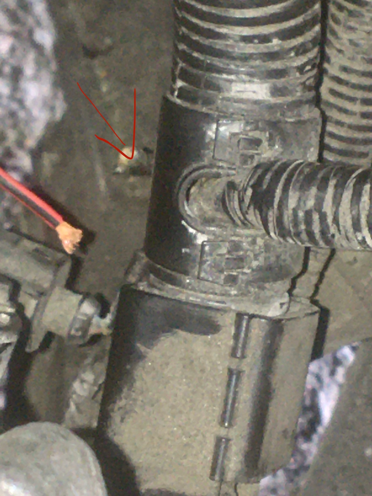

Hi Pete mate that wire that was connected to the starter is lose at the other end where does that go
Edited by DavidG
Ah, not seen one break there before!
I think ultimately it goes all the way to the ignition switch in the cabin, but you should be able to trace it through the various bits of trunking and sleeving in that corner of the bay, and hopefully re-join, or splice a length of new wire to both ends if it won't reach.  Will need to be similar conductor thickness.

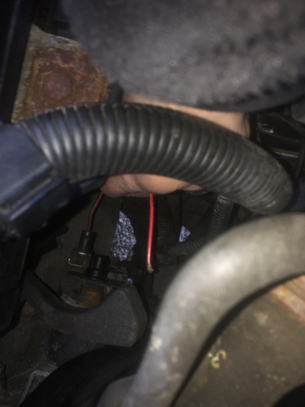

Yeah it looks like it will be easier to get to from underneath will I be fine to try hold it in place as I get someone to turn the ignition on
Yeah, it's only 12V. Might spark a bit but won't hurt you.
Yeah I will have to watch the gear changer as well it right in the way

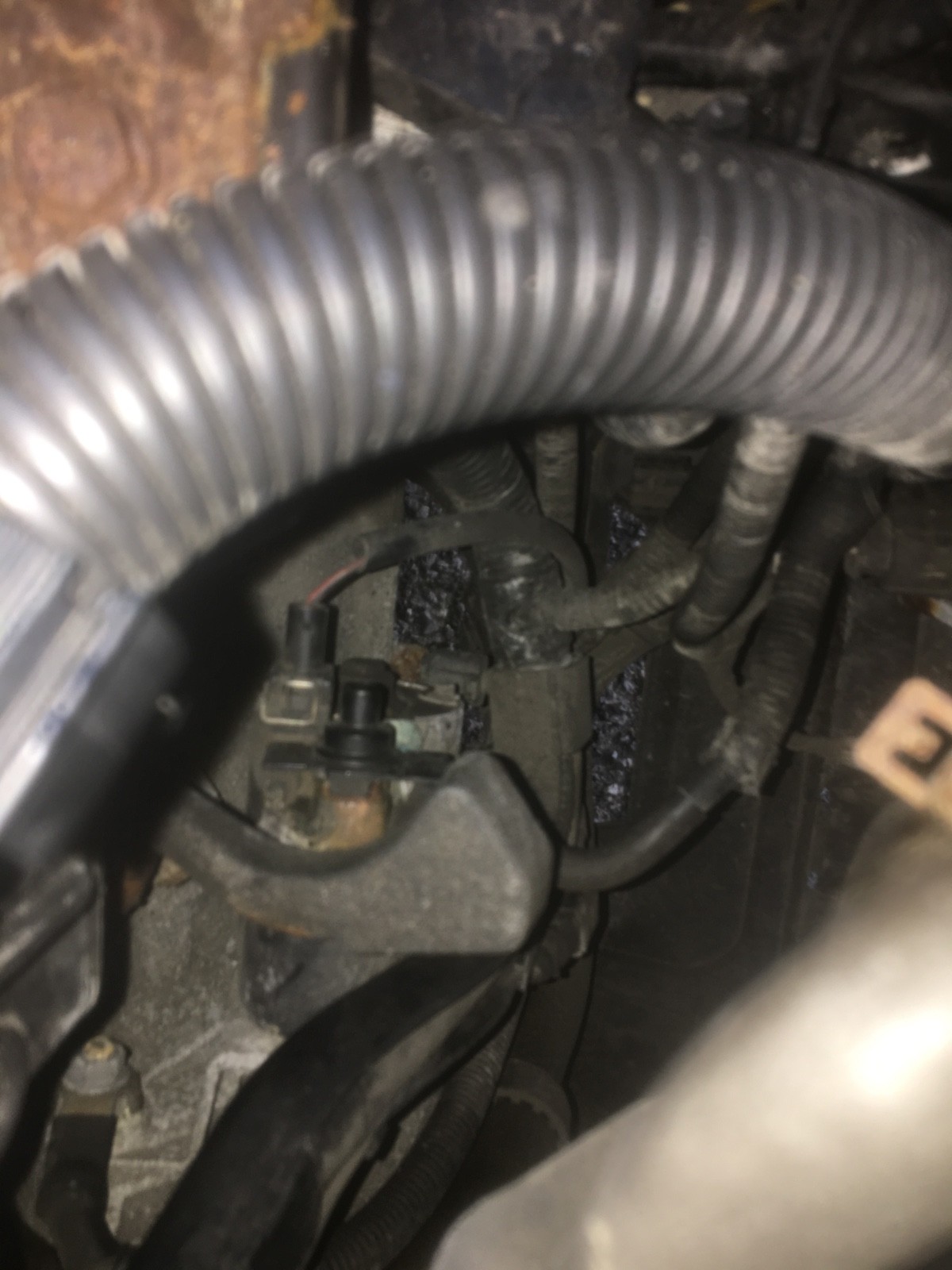

I’m guessing this is it mate
Any ideas what watt splice I would use mate would it matter ?
note the decent crimp tool comment....crimped well they will be fine , pinched on with poundland pliers maybe not so much
make sure whatever you use is sealed from the rain
