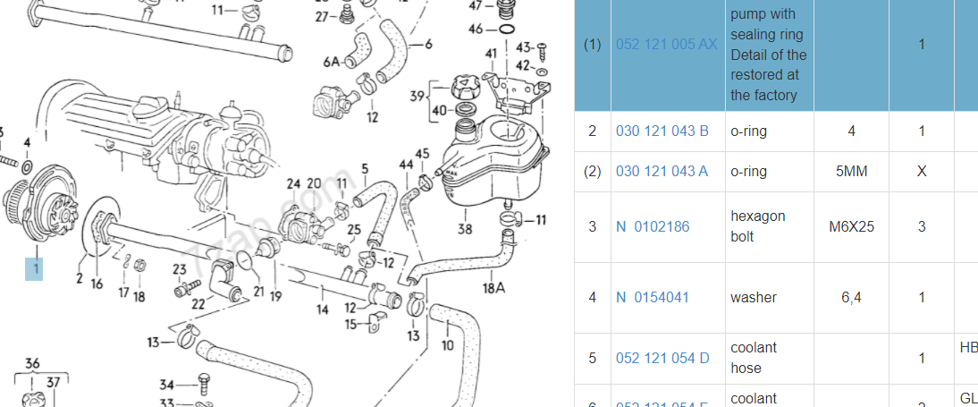

It looks to me like it's attached to the block the other side of the water pump
by two nuts.

you can see the nuts in the pic....part number suggests its an o ring thats available if you search that number /although the picture looks like a gasket?
Ah I think it's 16 on that diagram, just found it part no 052121091A. The o ring I guess is for the water pump on the other side.
yes makes sense
