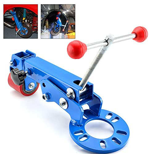

I can't see them working on the straight rear arches. Whenever I've done them, I've just used a bit of plastic piping as a former and rolled the inner lip over it.
