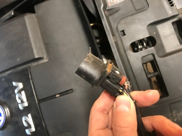

1. What is the little bit below the coupling and what does it do. It is now in bits and I just wondered. It looks like a small fuse perhaps? Picture attached

I think the bit in the connector is a bespoke tuning resistor to bring the sensor into a standard operating range.

Did it just fall off or did you " whack " it off?
You could just re-solder the calibrating resistor back onto the sensor...
John ;-)
A good question. I was tempted more than once to just hit the whole thing.
Actually in trying to get the connector off of the bracket the plastic surround came off and the resistor dropped to the floor. I don't think it was originally soldered, just a touch contact. The aging and now cracked plastic is beyond use now!
Anyway, the sensor threw a fault before this, so expecting to change the whole thing anyway. The resistor bit is certainly beyond easy repair.

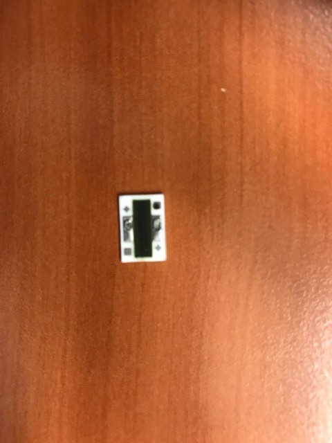

Looking at the photos ..seems like the resistor still has the marks as to where the "feet" were soldered before , and the "feet" on the body look good , maybe this was your original fault after wrestling with  the downpipe?
If it was me I'd fire the soldering iron up...
John ;-)
mmmmm was just thinking about that too. Soldering iron - not a big job and might solve the problem.

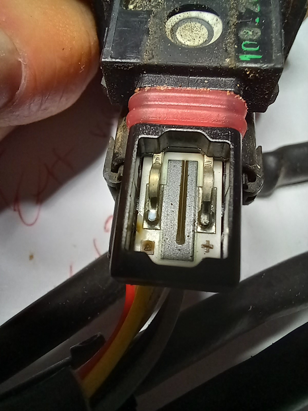

This is what that area looks like on an undamaged one, soldered joints as very well observed by John.
I think this is probably a good spare but the part numbering is a bit obscured by rust, might respond to a clean-up should it be useful to investigate further.  Think I might even have another somewhere..

Good work by you and John here; sounds promising. Was there a clip-on cover over the resistor weatherproofing it? There should be.
I did manage to read the part number from the one I photographed above; it appears to be a Bosch 0 258 007 357 which does seem to be the correct one.  It looks far from new, but the 'business end' looks a suitable colour rather than a sooty, oily mess, so probably works.  PM me about it if you do get a re-occurrence of fault code. 👍

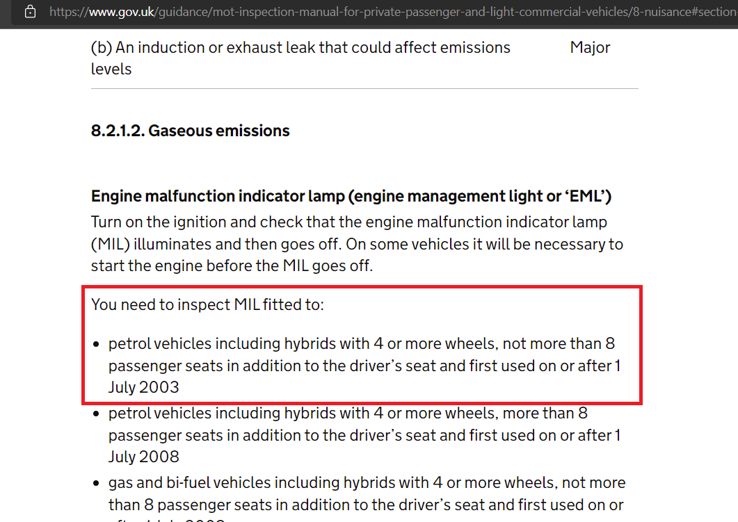

I can probably fix that for you, at the risk of antagonising the tester.
The MOT test manual suggests that the car is too old for them to care about the MIL:
Wow and never knew that. Very handy as my car is a 96 1.4. No lights at the moment and MOT also next week!

There is no MIL/EML on the 96 speedo so no need to worry
