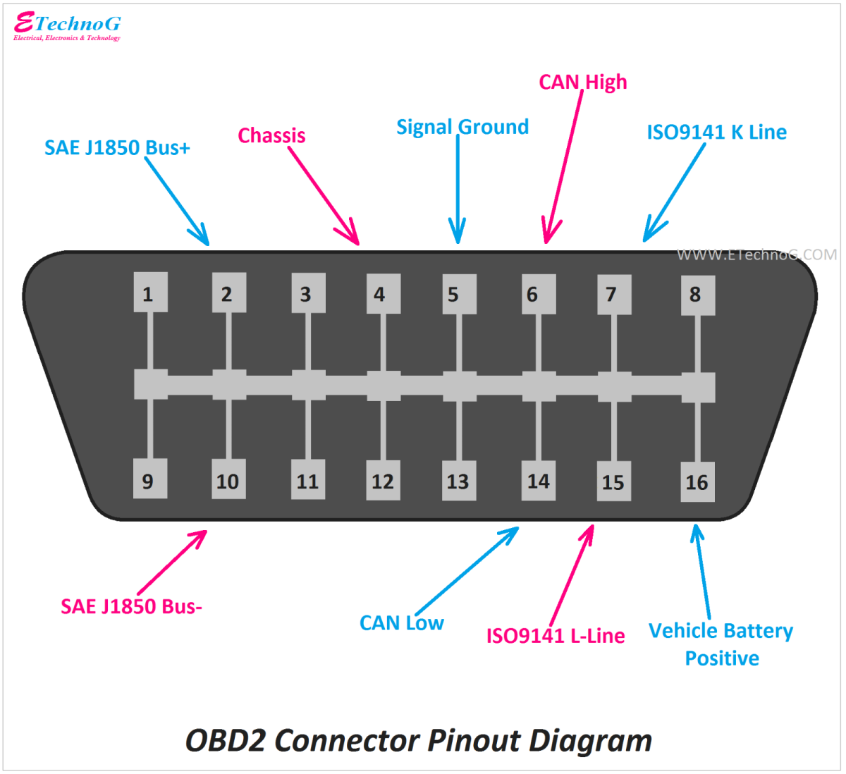

Have a look at the OBD connector and see if you have contacts in #6 & 14 I think you will find there is, that means you do have CanBus
Oh, awesome! Thanks a lot man, you're the best 🙂 I'll give it a try tomorrow!
