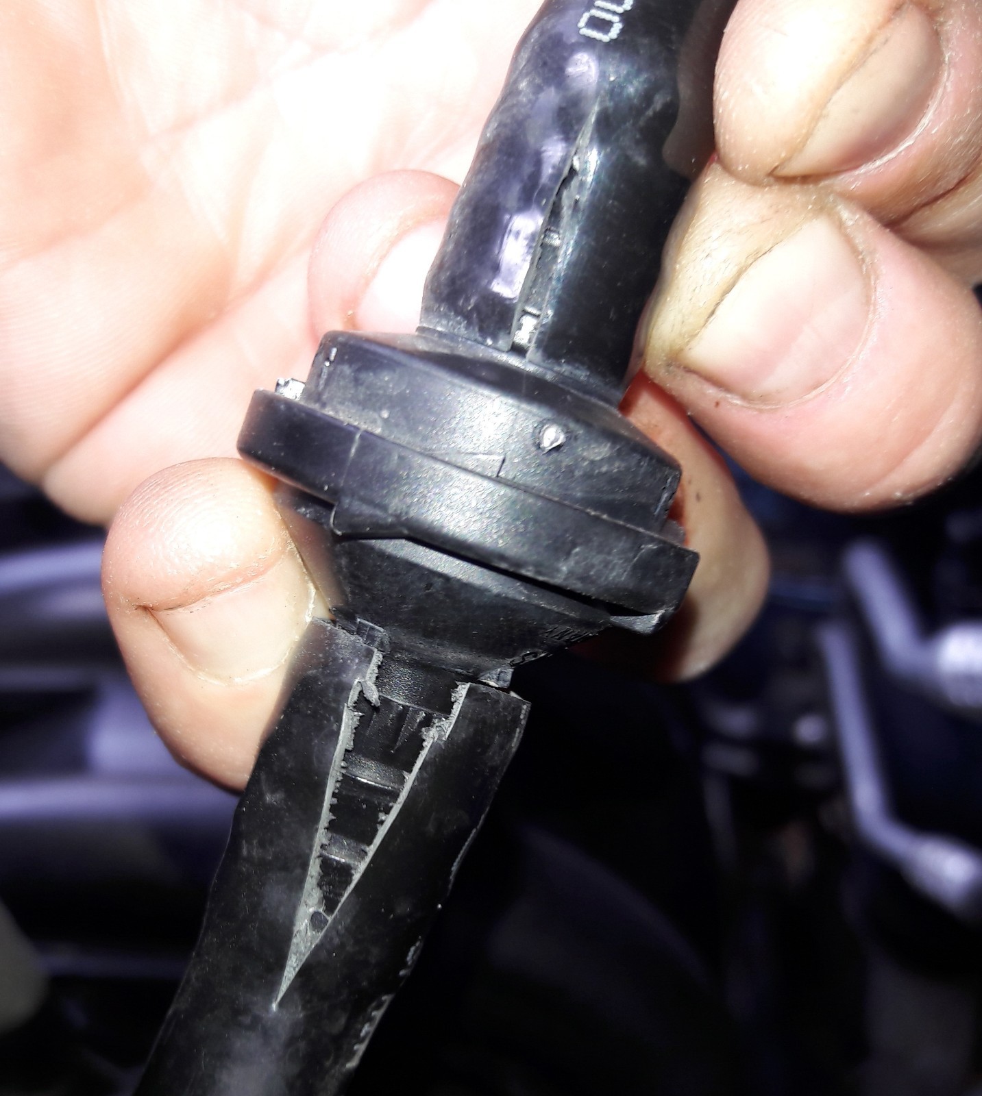

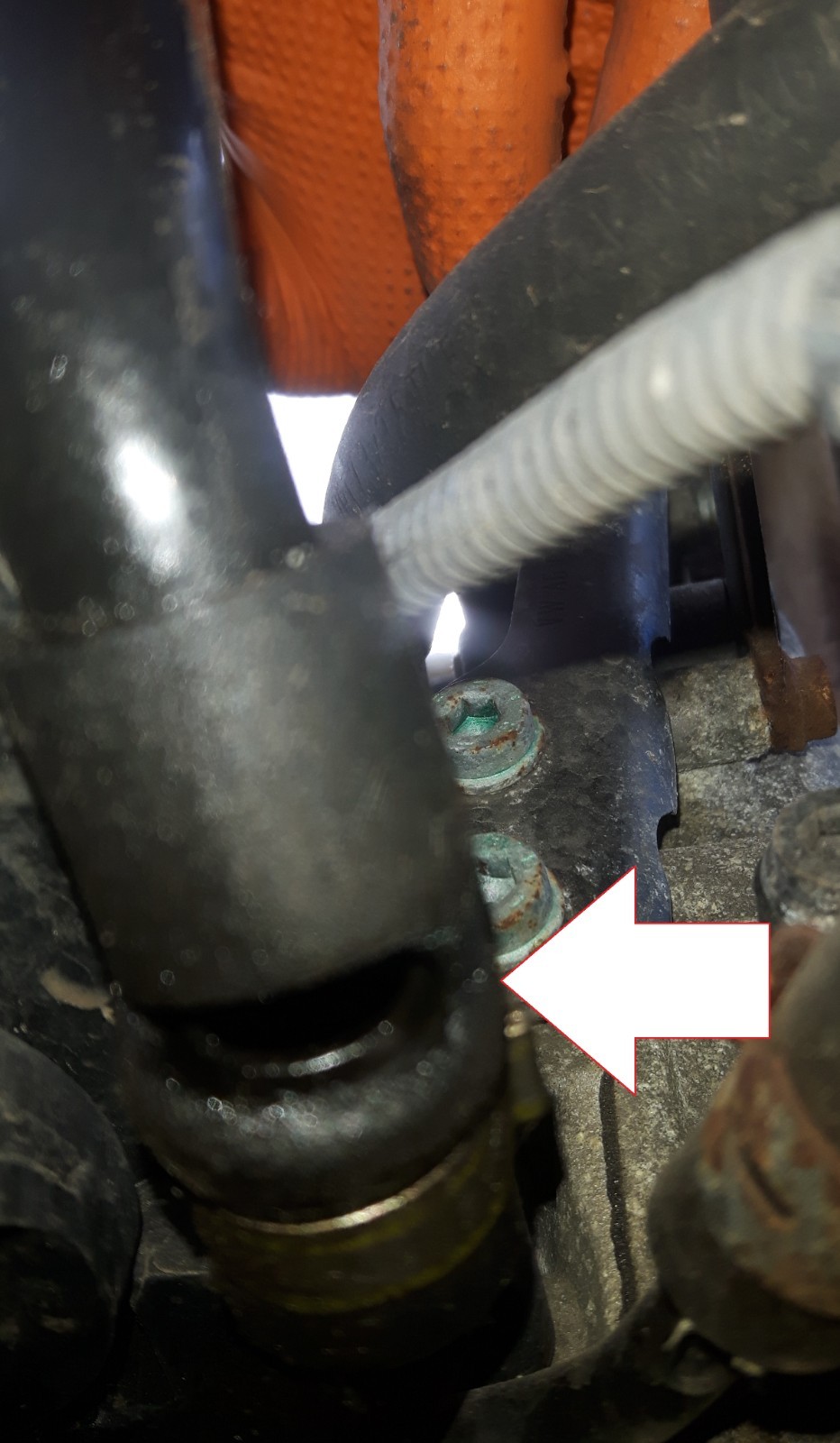

Double-check the brake servo vacuum hose at all the junctions of the hard plastic sections. The non-return valve connections seem to be a particularly common point for trouble.  Feel with fingertips on the underside as that often seems to be where they crack worst. Post a photo or two from above/below ideally.
This is a particularly bad one I found on a similar engine:

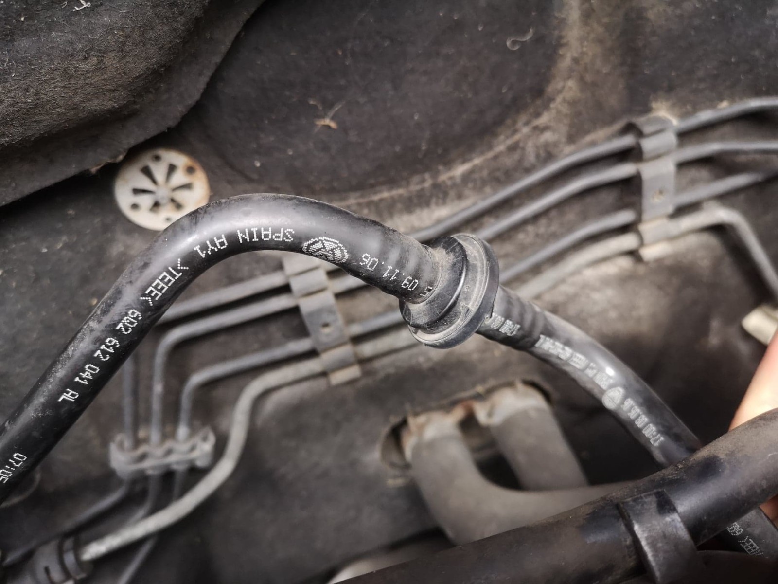

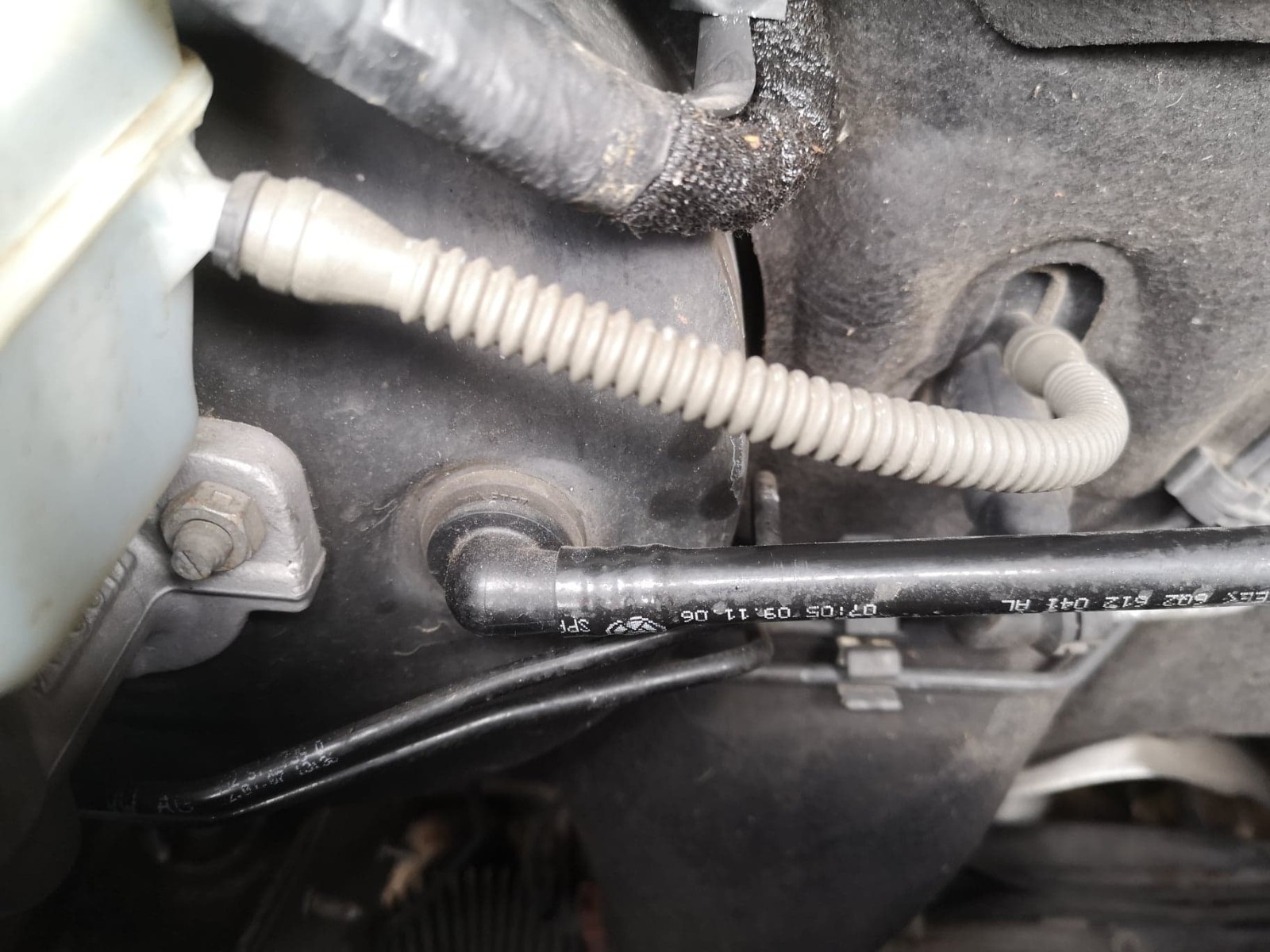

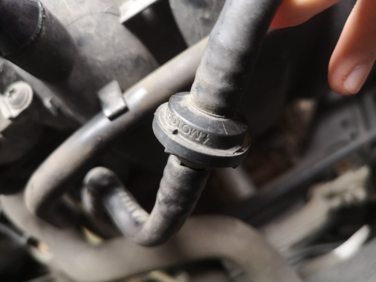

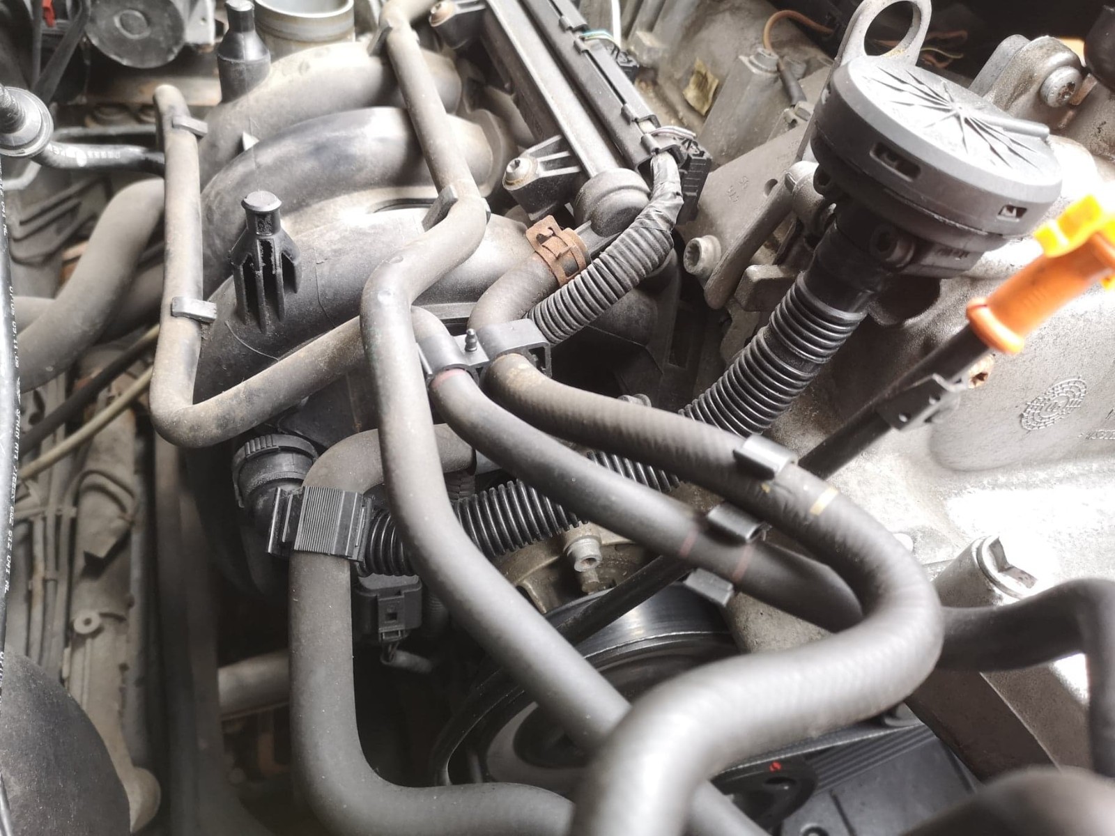

Hi Pete,
Thanks for the speedy response. I had a look and a feel all the way along this hose yesterday afternoon, but couldn't find any cracks - pics below. img2.thumb.jpg.5231c101bdc008237a8d123990381499.jpgimg1.thumb.jpg.a021591b3ef9647b449d26de906b5785.jpgimg3.thumb.jpg.1489f351fb3a8958ca751270b7a0ecdc.jpg

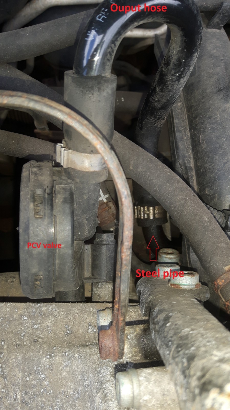

The other place to look for an air leak is on the output hose coming from the PCV valve. Here are a couple of photos from above and below showing where I mean.  The soft rubber coupling pieces don't appear to be sufficiently oil resistant to last:
You may find that moving the hard plastic pipe around while the engine is running affects the idle by opening/closing such an area of degradation.

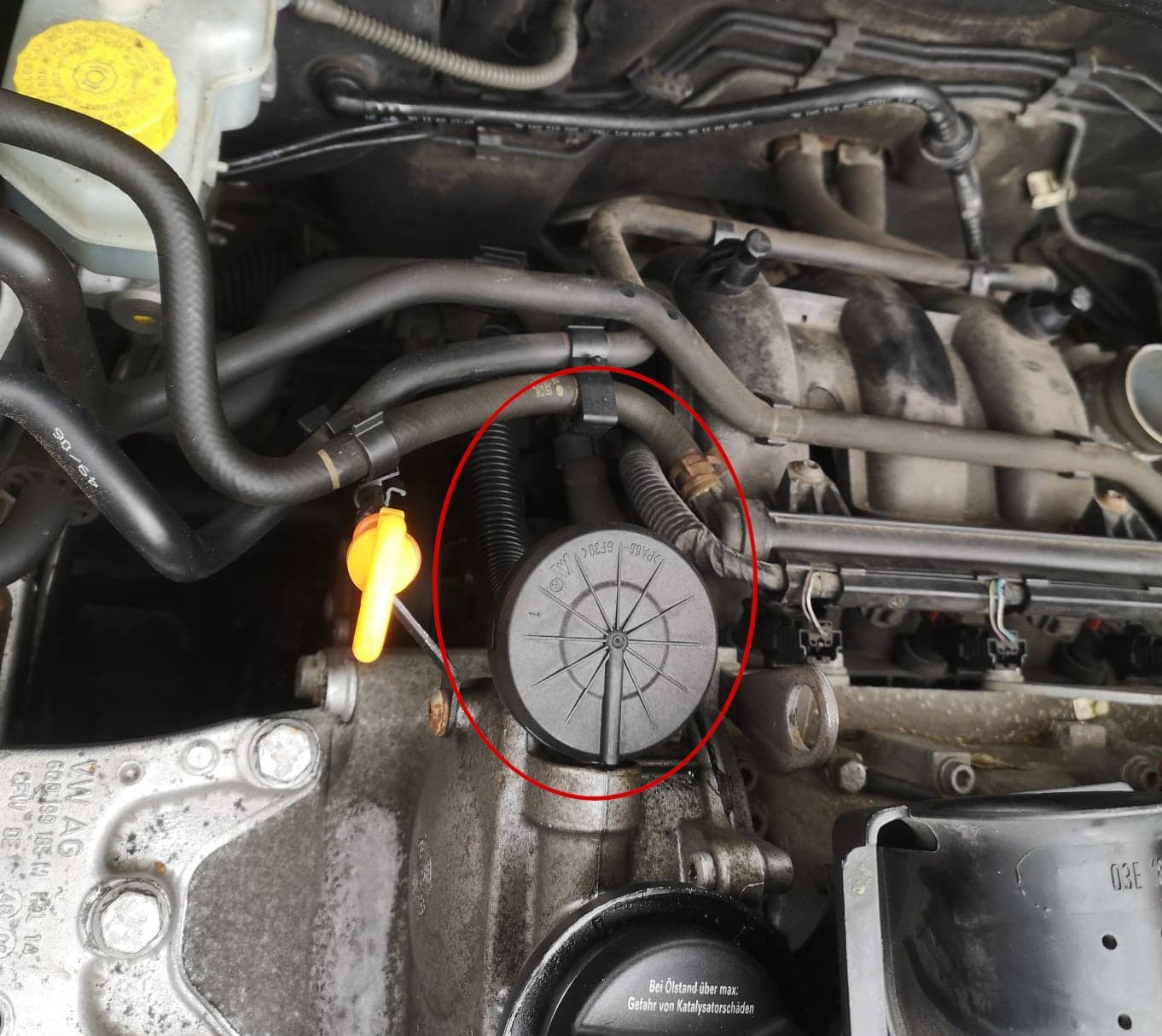

OK I've left the throttle body alone. Had a look at the PCV valve and associated hose - it's different to the one pictured above. The tubing is hard, ribbed black plastic, and I don't have the soft rubber couplings. I checked all along the hose, including the connections at both ends, and can't find any splits.

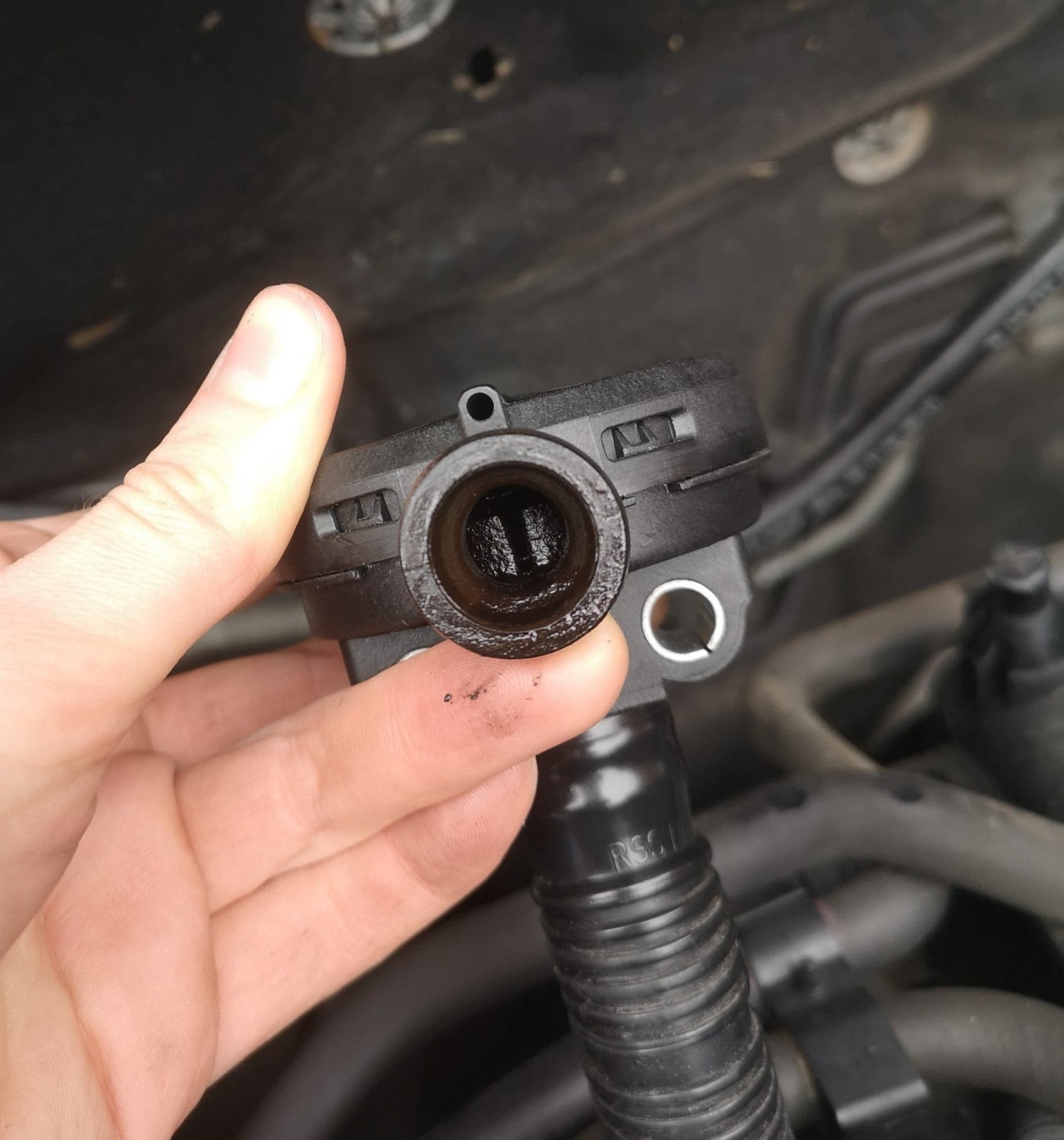

I'll be honest, this is new territory for me - out of curiosity I disconnected the PCV valve to have a look at what state it's in. From what I could see of the inside without taking the cap off, it looks like there's a fair amount of oil built up in there:
I've had the car ~6 months and only have a limited service history, so I have no idea when or even if this has ever been changed. Time for a new one?
Ah, sorry, I made a 50/50 guess on which variant of 1.2 engine you had and guessed wrong.
Normal for it to get oily.
With it back in place, engine idling, try blocking that little hole just above the main entry, nicely visible in your last photo.
Doing so shouldn't make any difference to how the engine runs, but if it does, it probably indicates that the rubber diaphragm inside there is bust or leaking.

Once I'd put it back, I blocked the little hole both when the engine was cold and when it had warmed up, but there was no change to the idle either time.
