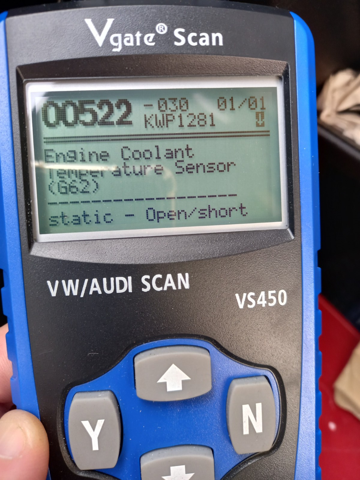

Hi hope you enjoyed stanford Hall. I have an update I plugged in my code reader and as in photo following fault code came up.?

This has happened to me now. I've ordered a pair of new sensors as i wanted a Hella blue anyway, i think they are the best now VAG and Beru are no longer available. I've linked my tank connector out, it makes no difference, i think this is the latest side story in my cluster issues saga. The cluster PCB is still available from DE.
