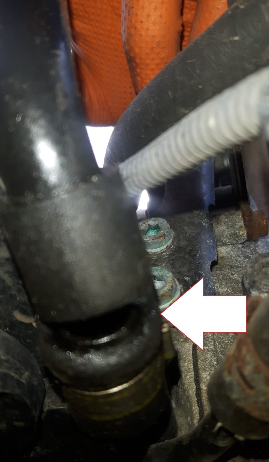

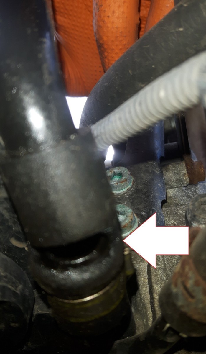

Check for leaks just beyond the PCV valve. The pipe that conveys its output back into the inlet manifold has some rubber coupling bits that can rot through and leak. This is a phone-camera view of just such a leak taken from below looking upwards.

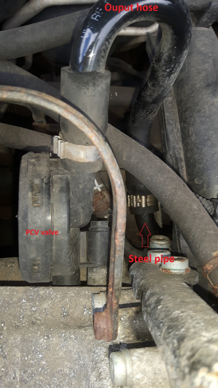

Thanks for your reply, I can't figure out where on the engine in your pic is, possibly it's the metal pipe that has a rubber section each end from the to cam cover to the inlet manifold?  There;s also one from the vent valve (disc shaped), cam chain end of engine?  Cheers, Chris
PCV valve = crankcase vent valve, near dipstick.
This is on a BMD engine as far as I remember. Not sure how similar a BBM is.
