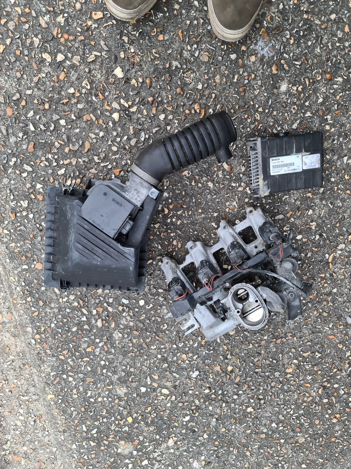

Hi all, I have acquired a 3F (GT) inlet manifold with rail and injectors, the airbox with MAF, and ECU all for free. I'm looking into what else I'm going to need to convert my SPI system on my AAV, to the MPI system from the 3F. Any help will be appreciated. I know I need an engine loom if anyone has a GT loom for sale, I'm guessing I need a flange that goes on top of the throttle body. But I'm not so sure, if anyone has any diagrams also that would be very helpful!
Thanks 🤟🏻

    top hat for the tb , aux air valve and its pipes , loom  ,relays, 3 bar pump

    also need the gt /g40 coolant flange and distributor   another option would be fit the inlet with inj and get a speeduino ecu and have your own mappable ecu - sell the other gt bits to recou
another option would be fit the inlet with inj and get a speeduino ecu and have your own mappable ecu - sell the other gt bits to recoup some money , but thats a fairly advanced job
