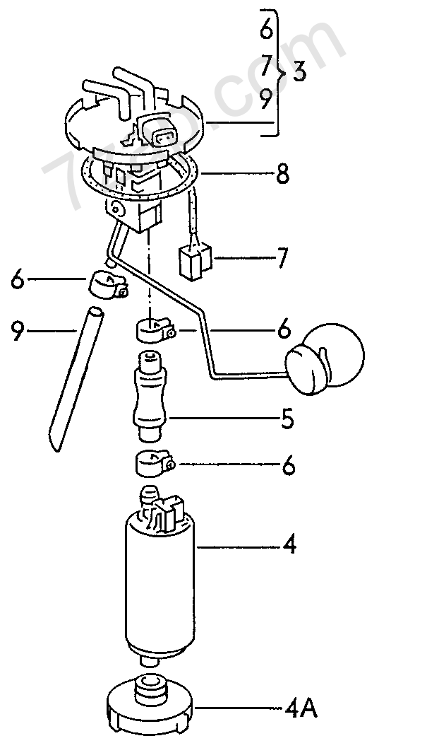

Ah, so on a look of the diagram (and my hazy memory) there are two rubber pieces in tank, numbers 5 and 9 below. On an image search they appear to be hose with the same ID, but I can't find a number anywhere. Long shot but does anyone know this and can save me lifting that git of a sender out of its hole in the tank?
Found an answer to my own question - the barb on the top of the lift pump is 8mm so im going to assume its 8mm ID tube for 5 and 9. Just got to pin down some good R10 hose for it now. Suppose I may as well replace the lift pump too while I'm at it as well...

Work email is broken so took the opportunity to do the in-tank pump. As expected the old vibration damper piece (5 in the diag) had started to get gungy so its been replaced with some R10 hose. The fuel return line looked and felt fine so I've left it as-is for now.
What was surprising is the lifter pump had dropped it's screen filter (no bad thing for removing the awkward git of a thing though to be honest). I wonder if some of the really intermittent hesitations I've been having are down to the filter being sucked up now and again and restricting the pump inlet?
Either way a new VDO pump and filter went in
