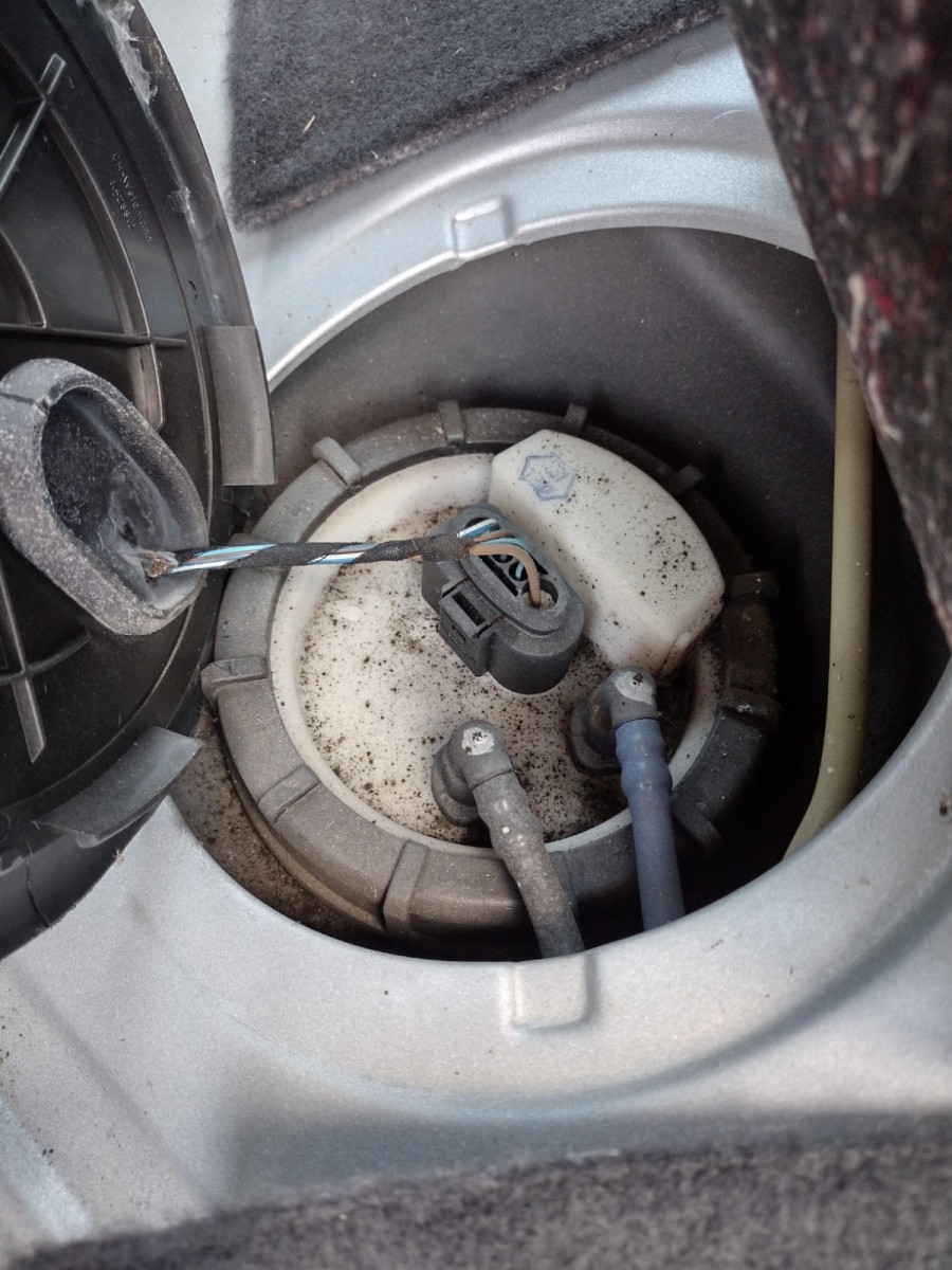

Thanks nige8021. I'd just had my fingers crossed that 6Q0927904E simply plugged into connection under back seat (see picture). More of a challenge to cut and splice but learning opportunity. Many thanks.
Don't cut into that connector it's the fuel pump !
