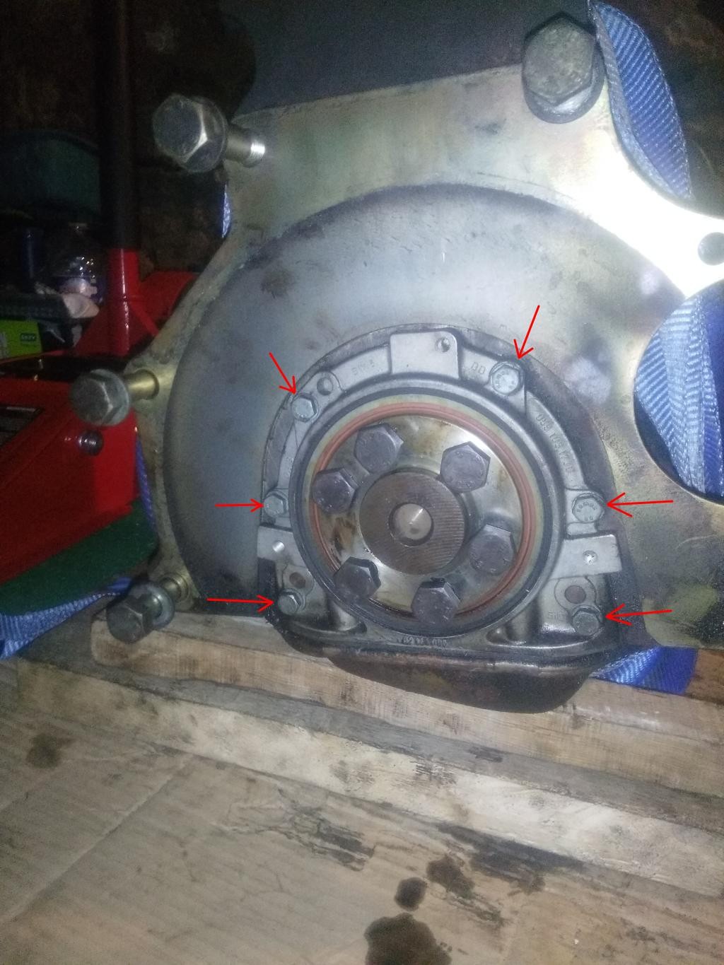

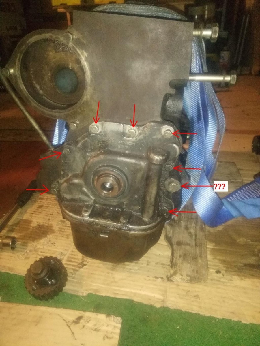

I'm looking for the torque wrench settings in Nm units (if possible) for the following bolts. These are located on the engine bottom end. The engine codename is MH (which is similar to 2G/AAV but with a carburetor). I'm not sure of the "English" naming of these parts so forgive me for not giving you their names (seems to be "sealing flange"). Feel free to provide their names if you can 🙂
1st part : Looking for the torque settings in Nm units for the bolts marked with a red arrow
2nd part : Looking for the torque settings in Nm units for the bolts marked with a red arrow (I've added a question mark on one arrow because I'm not sure if this bolt is concerned or not).

  • Looking at the manual for an early 6N engine the same bolts are 10Nm and I can't see any reason why the earlier engine would be any different.   For reference the cover at the flywheel end i
For reference the cover at the flywheel end is named Sealing flange with oil seal  and the other one  Sealing flange/oil pump
