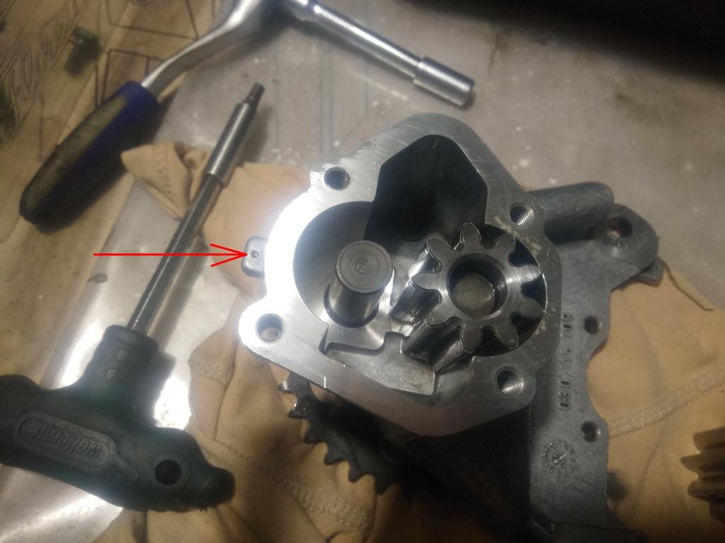

Hi all,
I've been cleaning the oil pump of my engine (1.3 MH) and decided to open it so I can clean a lot more inside (hard to stop cleaning when you started to clean everything even if you know it's gonna be dirty afterward). Then I've noticed several notch or timing marks inside the pump. I didn't noticed that there was also 2 other timing mark/notch outside on the pump body.
I'm not aware of any kind of timing procedure for the oil pump. I mean, once you've disassemble it then you just want to assemble it back and it would be fine. But looking at those marks, I'm a bit confused on how I'm gonna assemble it back then. Are these mark intended for a particular timing procedure of the oil pump ? Or can I just assemble my oil pump without worry ?

Here is one of the mark on the pump body (030 115 109 has a single mark while 030 115 109 A has 2 marks) :
Here is another mark on the pump body :

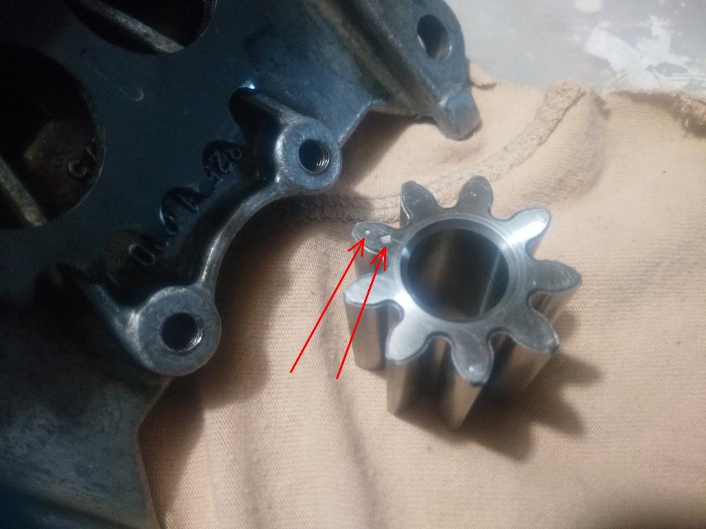

Here is a mark on a part inside the pump ("gear" in English ?) : This mark is oriented inside the pump (meaning you don't see it when you open the pump but only when you remove the gear)

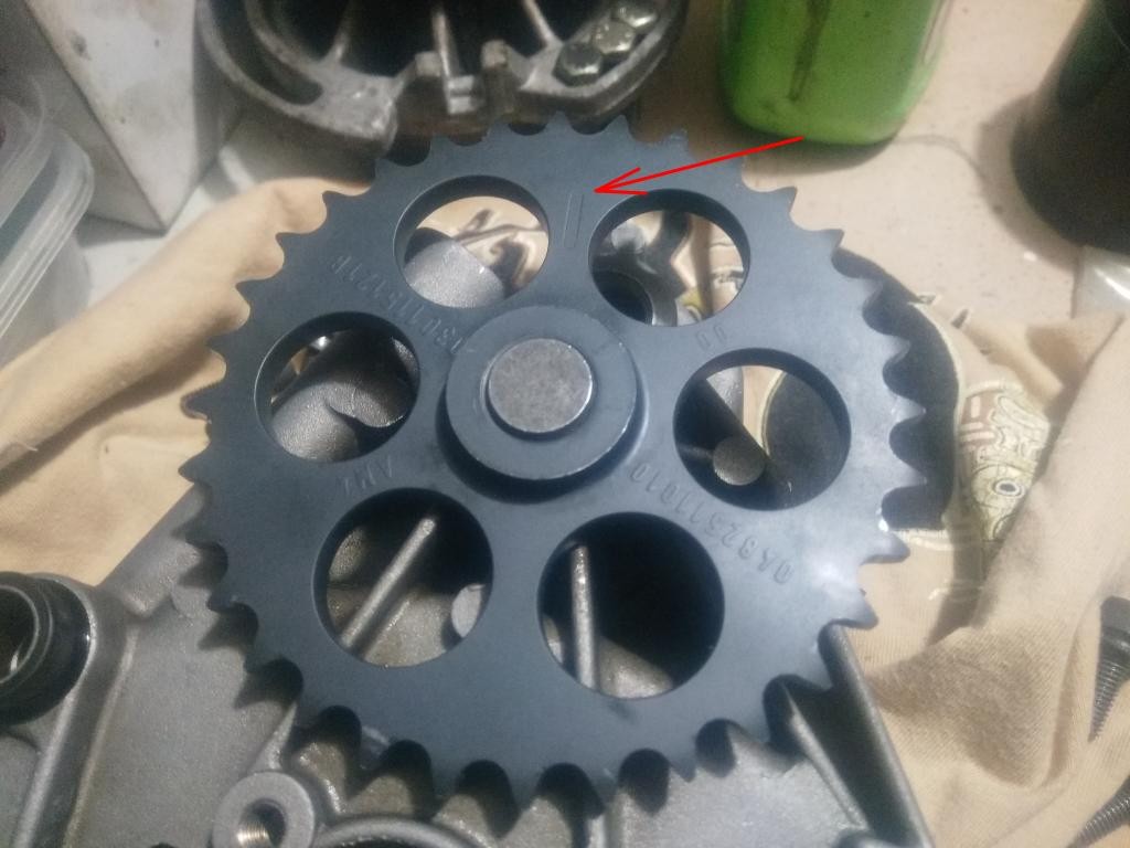

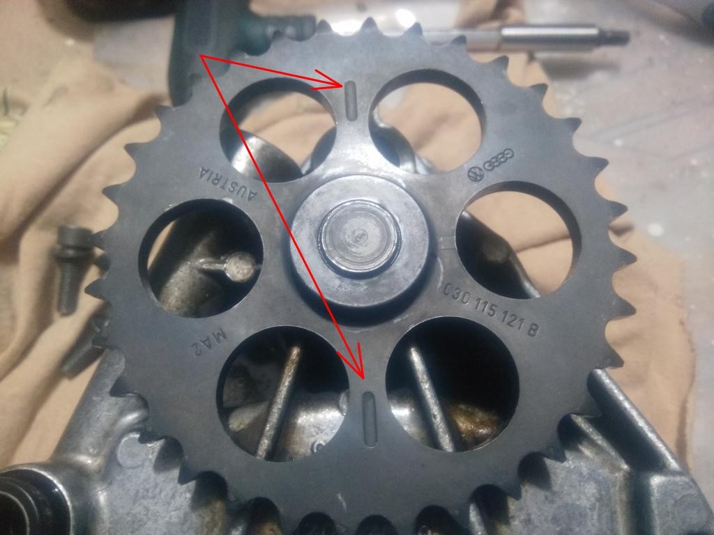

I will also check the drive chain tomorrow. I've cleaned it but didn't looked for a notch or a timing mark on it since I'm not aware of any timing procedure for the oil pump...
Can't think of any reason for those marks, the oil pump isn't timed to deliver at any part of the crankshaft rotation but to deliver a constant feed.

Nice to hear that there's no timing procedure for the oil pump (would have been surprising for such simple designed engine but a confirmation is always better). I've checked the drive chain and it has no mark on it. Moreover it's sides are the same - which means it has no orientation. Maybe these marks where meant for the orientation of the pump's parts and of the pump relative to the engine.
