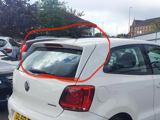

Is this spoiler possible to remove

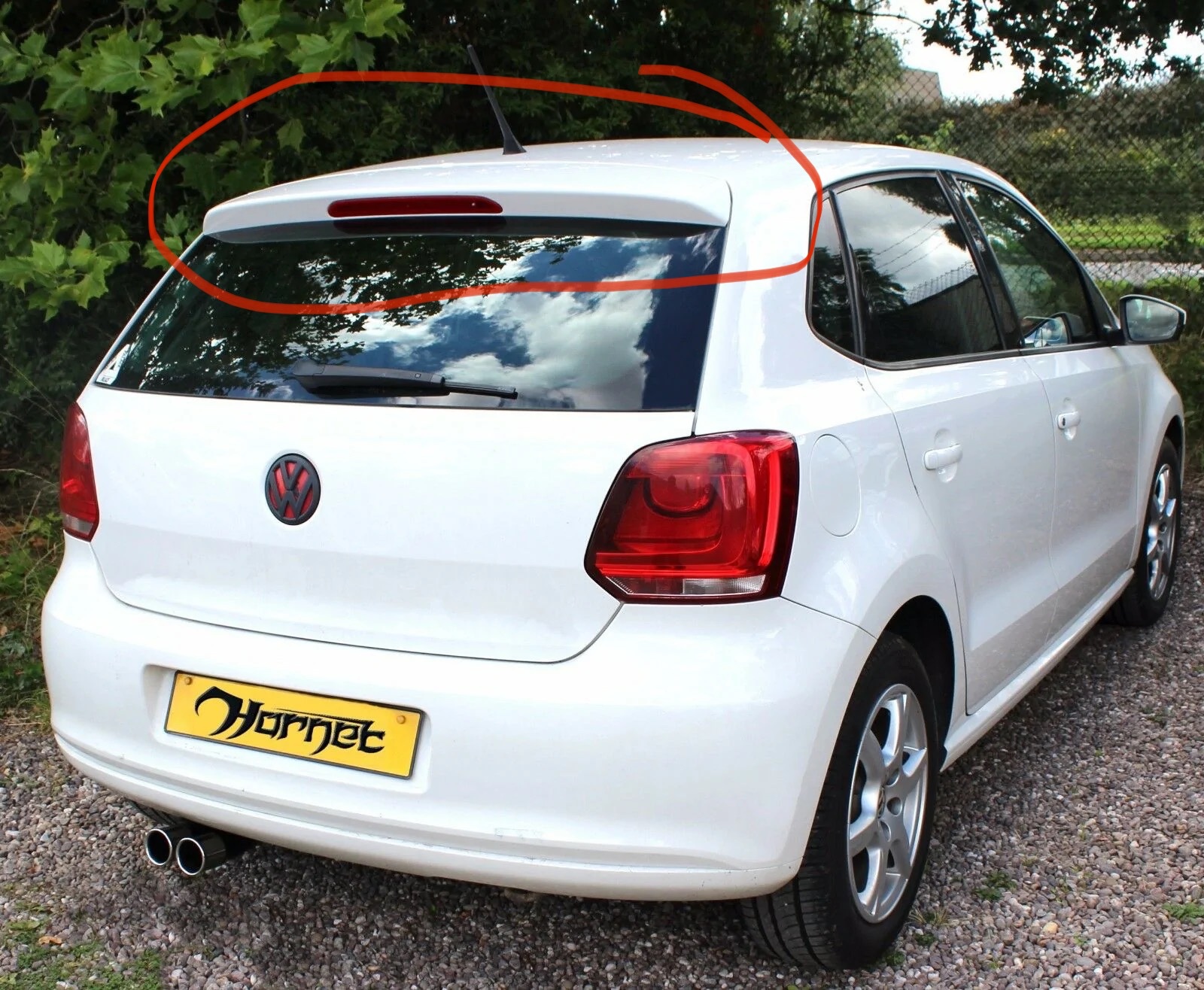

I’m not wanting to hVe this spoiler thingy on my car, it seems to just be held on by 3m or some glue of some sort and was hoping if removed it would look just like the stock lip on a polo (2nd picture) . If you are is removable will it be relatively simple or is it not worth the time ?

It is held down mainly with a bonding agent there are some clips in the main section
– Lift middle piece of roof spoiler and release from fasteners located on underside. 110mm either side from centre line of tailgate and 215mm from the first two
Remove middle piece of roof spoiler
There is an adapter plate under the spoiler that can be removed but it will be damaged and needing a replacement
The side pieces are just bonded on and will need a cheese wire to cut them off so will most likely damage the paint
– Cut through fastener between adapter and side piece of roof edge on adapter
– At top, position cutting cord  under side piece of roof spoiler .
– Cut through adhesive sealant using pull handles -V.A.G 1351/1--3- and cutting cord .
– At bottom, position cutting cord  under side piece of roof spoiler .
– Remove side piece of roof spoiler.
