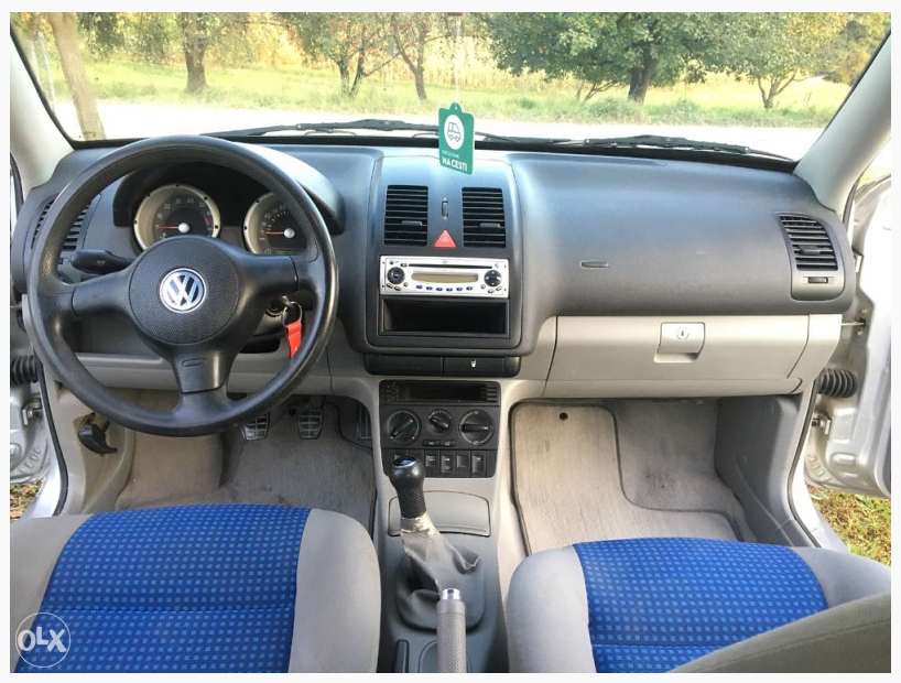

This is how my dashboard looks in my polo. It has the same tachometer and has power windows also (picture from the Internet)

The 6k dashboard looks like the 6n one, but it's different in pretty much every dimension, so I can't really see it working. If I wanted to sharpen mine up, I'd probably be looking at a 6kv2 Cordoba dashboard. I'm not sure how you'd get on with electrics though as the SDI's are very basic on that front, and I think the petrols have a fair bit more going off.
