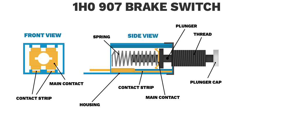

Okay so I got some free time and disassembled the switch. I cleaned the contacts in it and I think I figured out how it actually works and fixed the problem. I drew two illustrations to show inner workings and hopefully help someone in the future.
First of all, this switch is an NO (normally open) switch type which means when it is not actuated, switch contacts are open and do not close the electrical circuit.brake_pedal_switches.thumb.png.a208e98752a787a8356e7bd1467e39d2.png
After I assembled the switch I tested it with a multimeter and found out that the switch closes (shorts) it's contacts when the switch plunger is pushed almost to the end. This is actually logical because if you take a look at the first diagram and take a look at the contact strip, we can see there is a bulge of copper at the end of the switch. Switch actually works by sliding main contact above ridges which we can see on the front view illustration. Those ridges keep main contact from closing the circuit, but when the plunger is pushed all the way to the back, main contact closes the circuit.

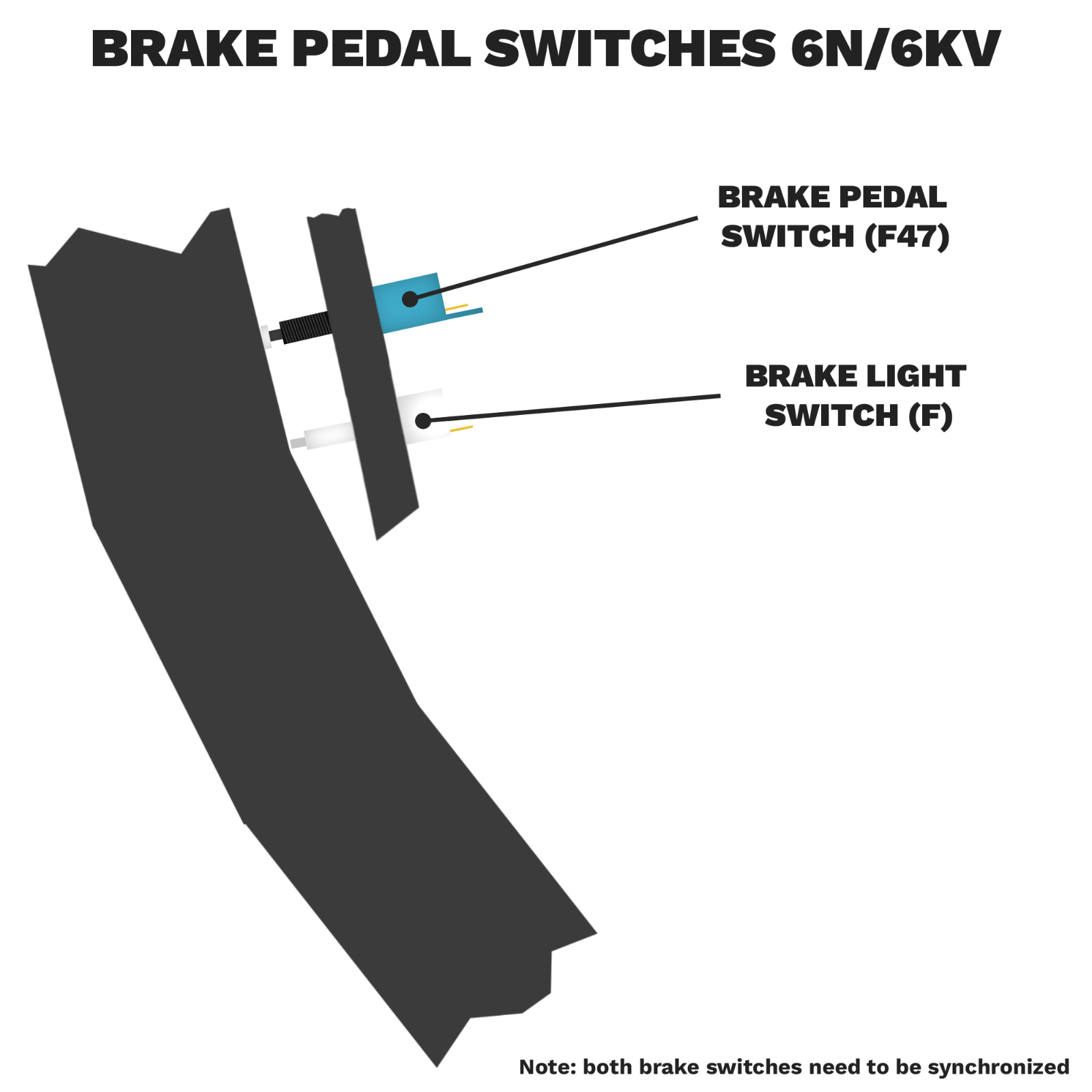

Now to the fault code. What I found out is those switches need to be synchronized, which means when we press the brake, both readings inside VCDS should read 1. In the second illustration, I tried to illustrate how both of those switches should be mounted. I was adjusting my F47 switch and taking look at the VCDS to see when both switches will output 1. After some time I got it working, when brake pedal is pressed, both bits inside VCDS read 1 at the same.
I hope it will help someone in the future.
