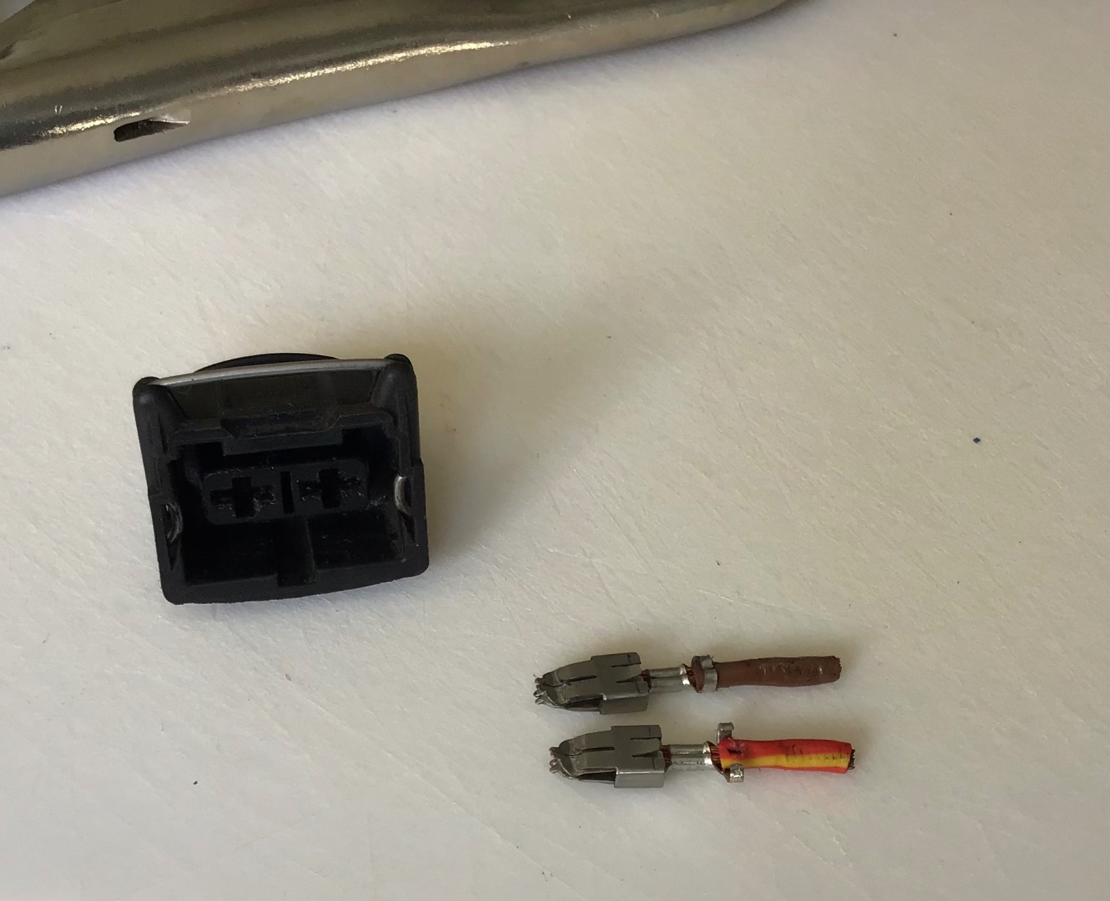

Looks like the fuel pump has stopped working. I have a replacement genuine vw but the connectors have been cut off as seen in the photograph. The one on the car is a generic which requires a different terminal connection. Any suggestions please on where I can get replacement terminals for the ones in the photo?
Can’t put a phot on from my iPad! Forgotten how. Getting too old for this. Any help please?
Edited by c.w.pritchard
Added photograph
Got it at last.
