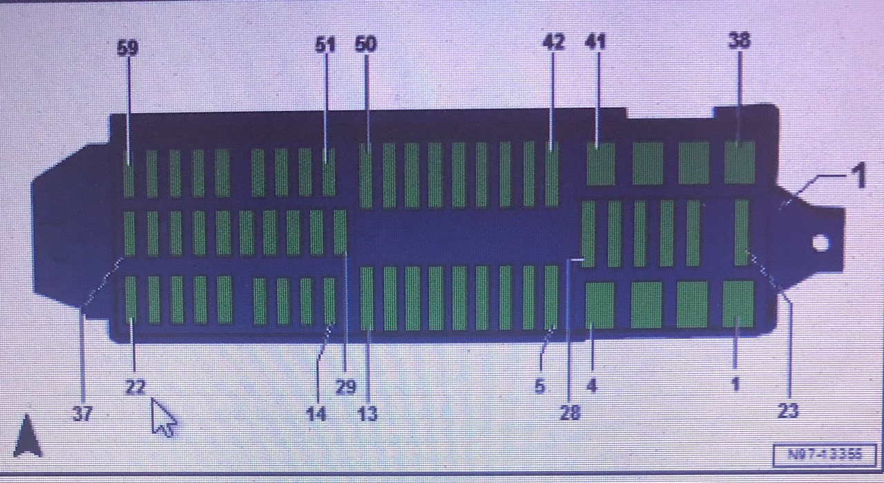

My Polo Mk5 heated rear window has stopped working, can anyone show me a diagram of the fuse box and the number of the fuse to check to see if it has blown please?

The dealer wiring diagrams don't list any fuse specific to the heated rear window, but there are several fuses for the onboard power supply unit that controls the HRW #1 40a, #2 40a, #3 30a, #38 40a, #41 30a & #51 10a   looking at previous models and the HRW fuse was a 30a so I would check those first. #3 or #41
Here's the layout for a RHD fusebox

Many thanks for the diagram and info, I will have a look tomorrow.

Update: Just checked, fuse #41 has blown, I’ll get a replacement today and fit, hopefully there’s not an underlying issue which caused it to blow in the first place.

@nige8021 Yes sorry… New fuse fitted and its working fine.
