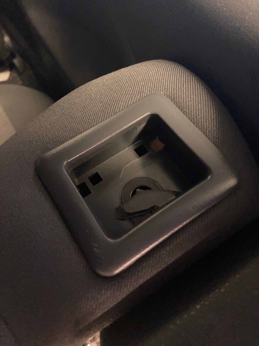

I seem to have broken the O/S plastic pull handle/lever that releases the back portion of the back seat so that it can lay flat. It can be found high on the back seat near to the parcel shelf. Does anybody know what the part number might be for this and where I might be able to find a replacement?

Thank you so much for your detailed response. I'm so very grateful to you for taking the time to write with all that info. Consequently I am very sorry that I didn't include pictures in my first post as I feel I may have wasted your time? 😐
I have now attached a couple of photos in the hope this helps. The car has an '04 plate.
Thank you once again.
Best wishes.
The broken one being on the offside....

Not to worry, your car is what would be referred to on this forum as a Mk6 (See Here: https://www.clubpolo.co.uk/forum/207-polos/) (The VW Model designation being 9N).
You are right, my advice above is about as useful to you as a chocolate fireguard. My knowledge is limited to 6N Polos I'm afraid but you will probably find someone else here significantly more knowledgeable than I.
This post may help you, it has part numbers and photos.
https://axleaddict.com/auto-repair/How-to-fix-a-Broken-Rear-Seat-Release-Latch-VW-MKIV-DIY
