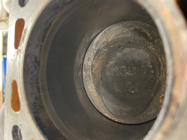

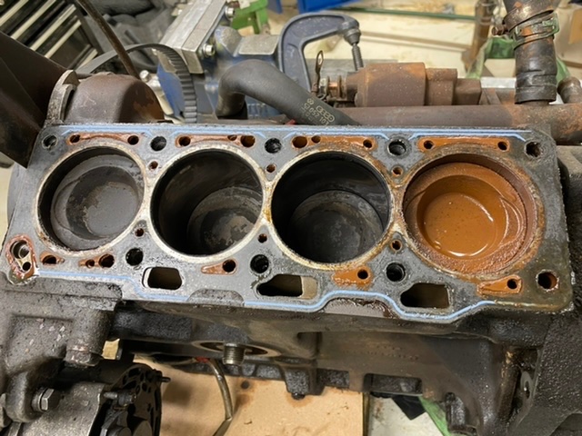

I just pulled the head tonight. 4th cyl was flooded, leaking also marginally into the 3rd. Otherwise the bores looks fine and I can barely even see, let alone feel any step at the top. It’s only a visible line in some vague places but otherwise just a feint change in texture. Head and block seem totally straight still. I think the head bolt just came loose. I think I’ll leave the bottom end alone for now.
cyl 2 and 3 as pictured was a visible line but couldn’t be felt with a fingernail atall.
