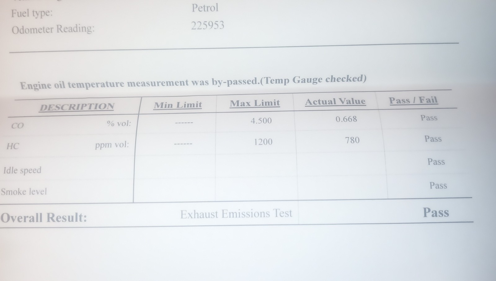

MOT time and the twin Dellorto DHLA 40's passed with no tweaks.
Nice and steady 900rpm idle.
0.668% CO which is ~14.22:1 AFR according to
https://www.mgexp.com/article/co-to-air-fuel-ratio-afr-table.149
The AEM wideband unhelpfully displays about 14.8 AFR for that.
This is 44 idles in .3 holders in 31mm chokes using the idle air bleed circuit for balance. I had to go richer idle holder because of E5 petrol.
The HC (unburnt) is tolerable with low vacuum from twin carbs and electronic ignition advanced a lot.
In other news, the floor pan needs some welding, so a Fail.

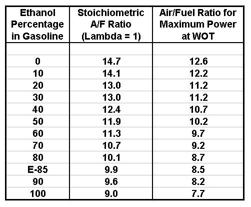

Though I'm fairly sure it's worse emissions starting with the choke or when the accelerator pump squirts at high load and I'm seeing 12.6:1 AFR whatever that really is. I wonder if the AEM/garage difference is because of the 5% ethanol?
This table seems to suggest that ~14.4 A/F ratio stoich would match 5% ethanol E5 petrol (linear interpolating between 0 and 10% rows) and max power for wide open throttle would be at 12.4:1 AFR.
Think the wideband measures only O2 and then calculates. While a 4 or 5 gas analyzer senses all the gases so knows exactly the CO% (after calibration in free air).
It does confirm my seat of the pants feeling that the mixture was a tad lean for gentle driving (above flat road cruise, like leaving a roundabout) which is why I upped the idle jets to 44, and then also a richer idle holder.
Surely for 80% Petrol, 20% Ethanol blend,
it would be same as (80/100)x14.7 + (20/100)x9.0
= 13.56 parts of air to 1 part of fuel for stoichometric AFR.
And for max power same
(80/100)x12.6 + (20/100)x7.7 = 11.62 AFR
