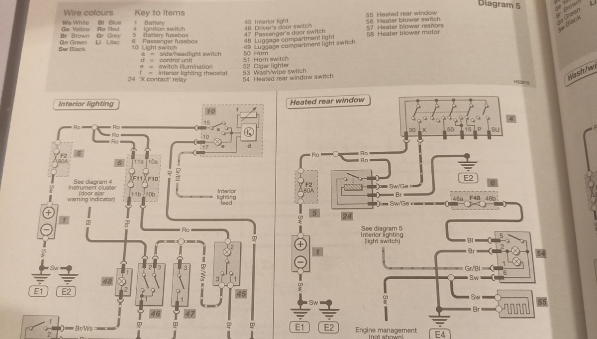

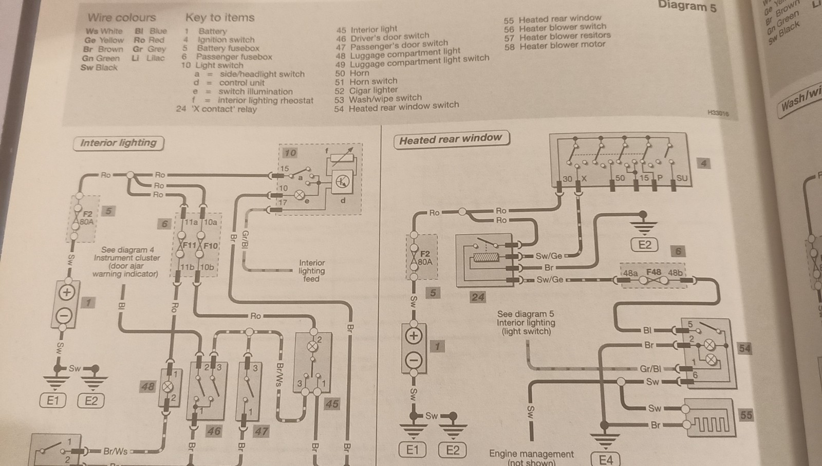

Dash light illumination and interior lighting feed is usually grey-blue...
It is on Mk2 Polo and T25 van and 6n 2000 to 2002

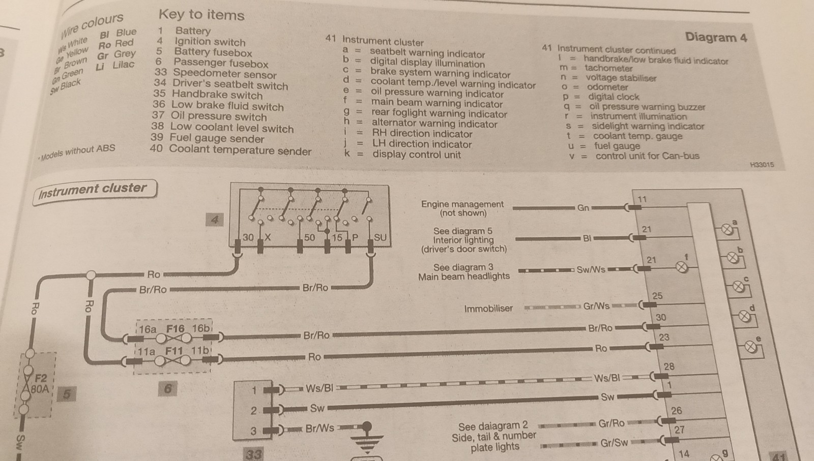

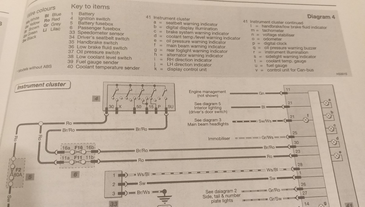

Here's a diagram. It's on a dimmer, which could work as a buzzer volume control!
Also pin21 of 6N instrument cluster is driver's door switch (Black wire).
