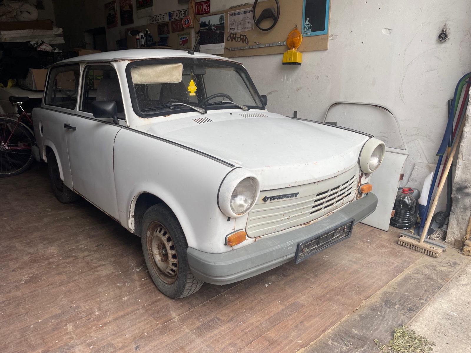

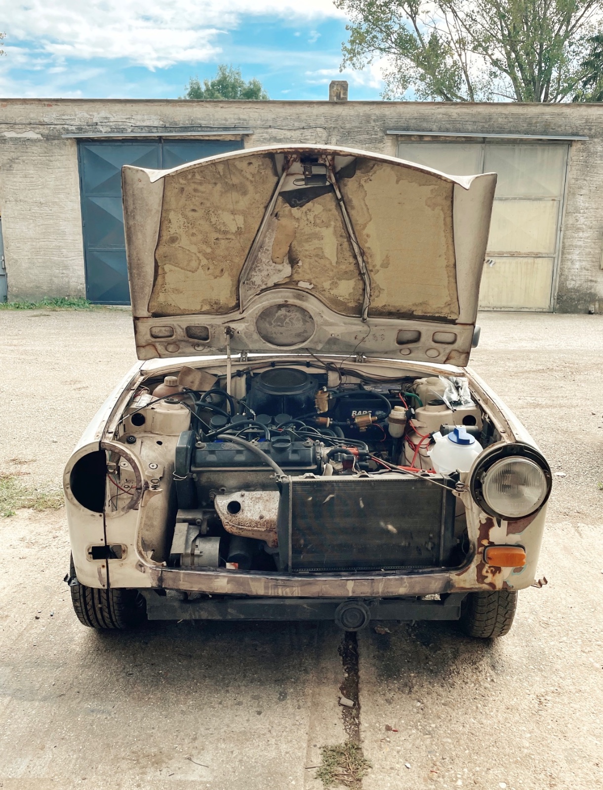

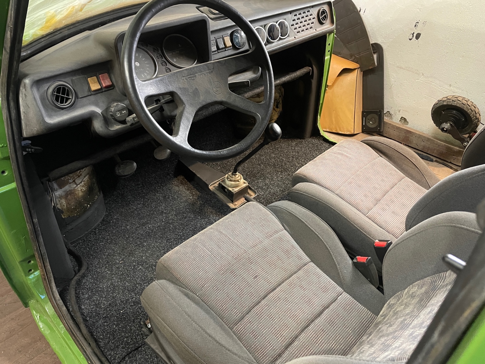

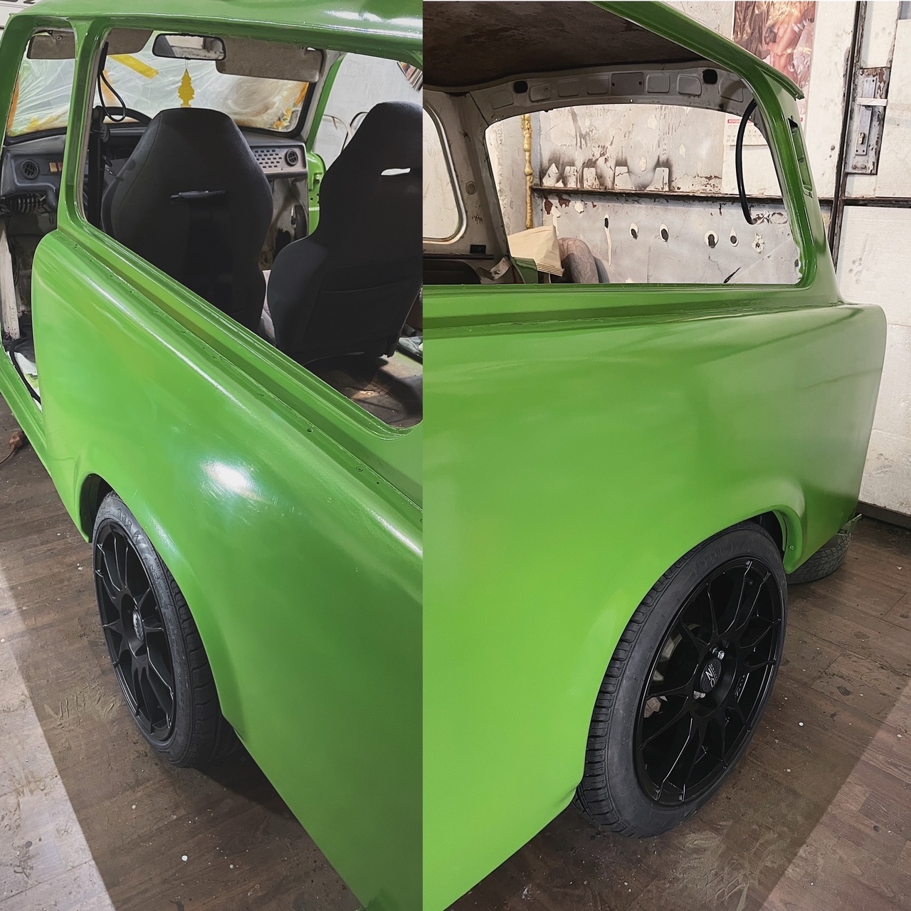

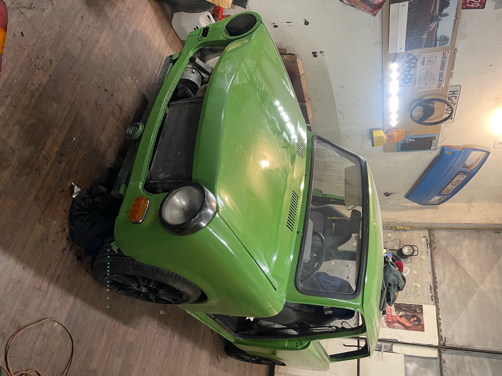

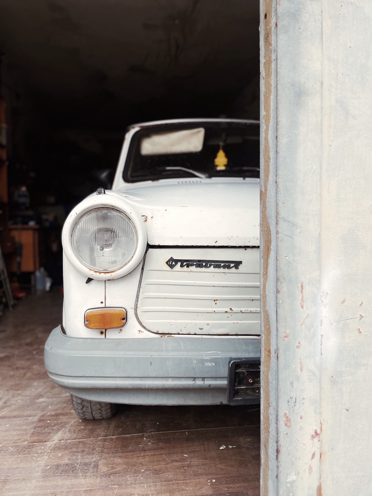

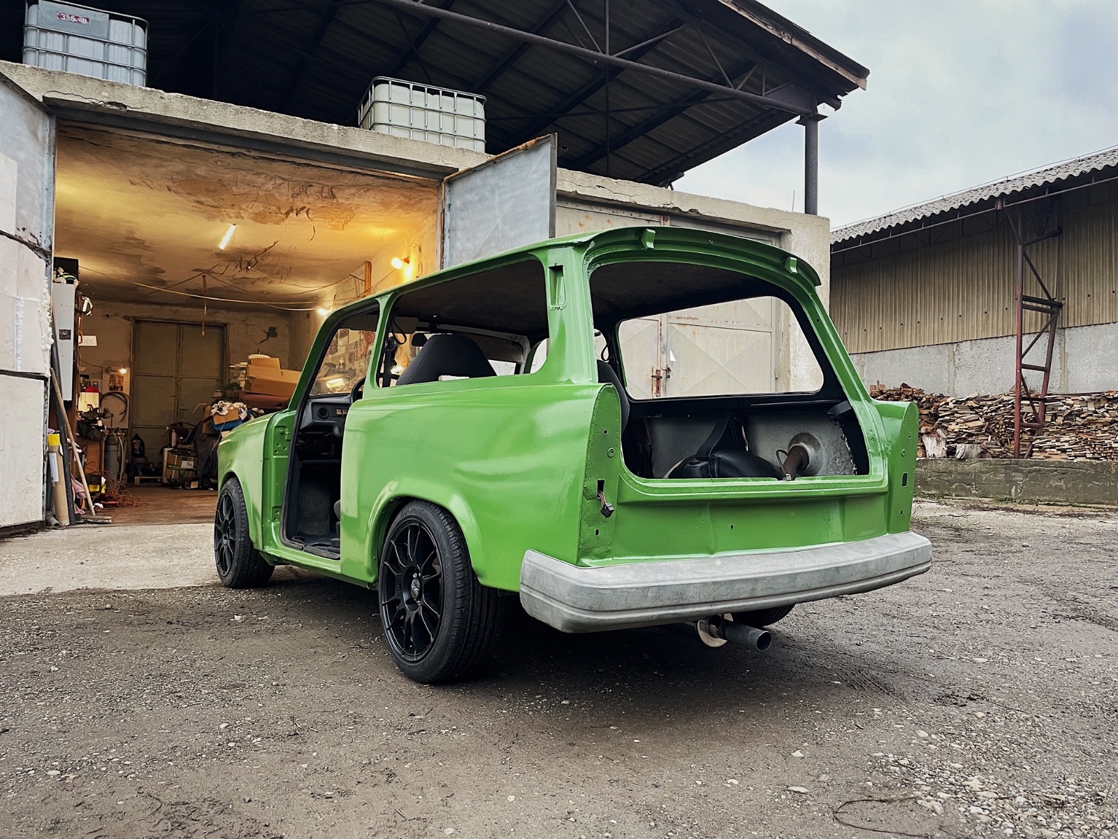

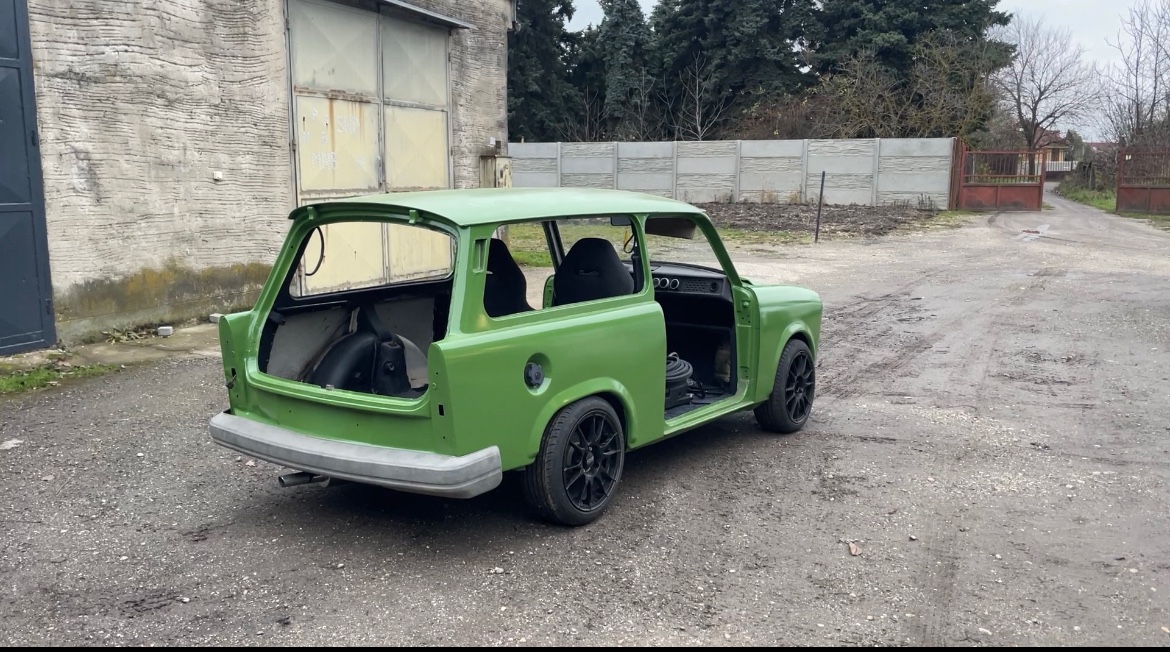

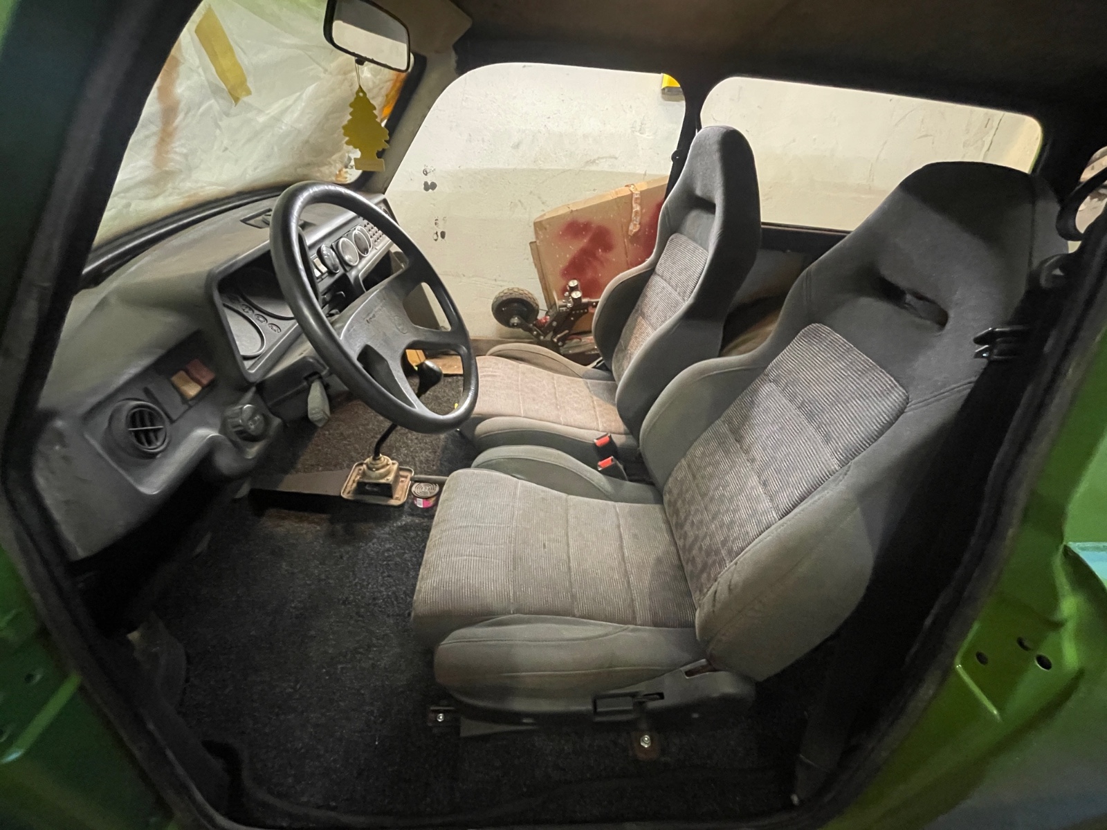

Hi i finally had time to upload some info,photos about my project
Trabant 1.1ย
ย
at start i had plan just use bike carbs from cbr600 with 1.1 engine ๐Ÿ˜ this motor worked with this carb swap but it was not enough for me ๐Ÿ˜
ย
i decided to buy 1.3 gt engineย
and upgrade it with supercharger eaton m45 from mini
now its still under construction
upgrading fron axles,interior and moreโ€ฆ
front axle will be something like โ€œhybridโ€ ๐Ÿ˜‚ parts from opel corsa B,vw polo 86cย
wheels oz ultralaggera r15x7
front suspension opel corsa B coilovers
rear new dumper for trabi with spring from octavia coilovers with custom spring mounts
ย
397D28E6-5E5E-4DC6-847C-C30CC33A8BAC.thumb.jpeg.42f012e75a00ff7625a35f51482ae8f6.jpeg9CC4008F-C893-4BEE-858E-6094220C19DA.thumb.jpeg.d33f6ea35509406e24a9d9ab93e0749d.jpeg008F84A1-50AC-485F-B615-9AC06751CA4D.thumb.jpeg.a4acb74c3ec449c215a0b90300ddf705.jpeg

Is that an original VEB Heidenau tyre on the driver's side?ย
Need to check it ๐Ÿ˜the old one on steelies?
idk maybe is it
why?๐Ÿค”
Yes, on steelies. Just the tread pattern looks primitive. I remember Trabis heading out of East Germany and going to all corners of Europe in 1989-90.
Might be 30 years old, after a 17 year wait from ordering.
