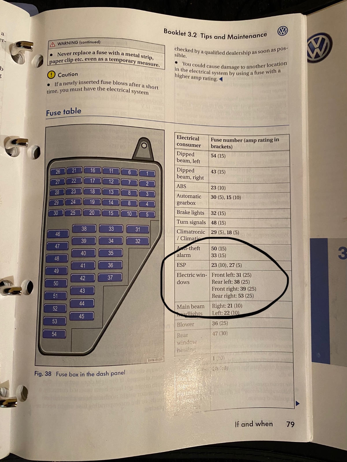

I took a look at the manual and removed the cover from the fuse box but I can’t make sense of it. I have taken pictures on my iPhone but I can’t upload them as they are more than 2 mb which this site won’t allow.
How should I go about resolving this and yes I am completely clueless about cars, electrics and anything technical.
Sorry and thanks in advance.
edit: I was able to compress these photos with an app and attach it here👍

  • The relevant fuses are highlighted here.      If all three of those are OK, it may be that the driver's side motor module is in need of repair.  This link may be handy. 🙂

Thank you Pete 1 for your quick response and for your insight. So I shall check the fuses first and if they still don’t work then it looks like aIll be contacting you for a repair.
Thanks again Pete 1 👍
