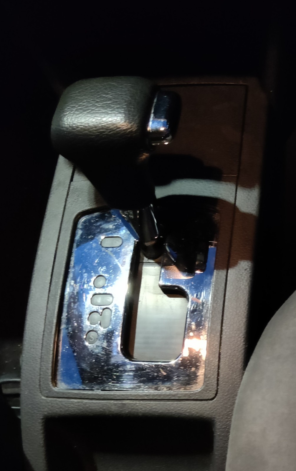

DSG's don't have a torque convertor, so if it is DSG, we can rule that out. Are you sure it's DSG and not the older tiptronic box though? I think the tip was a 5 speed, but they're not one i'm up on.
To be honest I have no idea what type of gearbox it is, other than I know it's a 6 speed auto, the sticker in the engine bay says a 9N BUD (see pics), if that helps.

I can/will look up your transmission type after I've eaten in about an hour.
Your transmission code is JUF, which is a member of the 09G family of gearboxes.

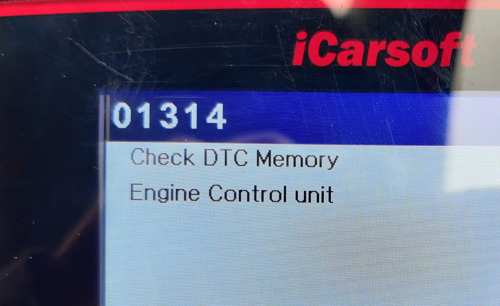

I tried the icarsoft to see if there were any error codes & if I'm correct, I think at least one point to the ECU (see pic), but there were a few other odd bits, which I'll try to show or list.
But am I correct in thinking that this could have, possibly been altered by someone to get the emissions or fuel economy sorted?
That suggests, I think, that there is one or more fault codes logged in the engine ECU.
Not sure why it isn't just telling us what they are. Or perhaps your next post will.
There's this code 00819, which I think is an air-con pressure sensor, from looking online, but only about £10 - £15 for the replacement, but not urgent, compared to getting it running properly.
This scanner is really good, but all codes come on separate screens, but there are a few, so bare with me.
