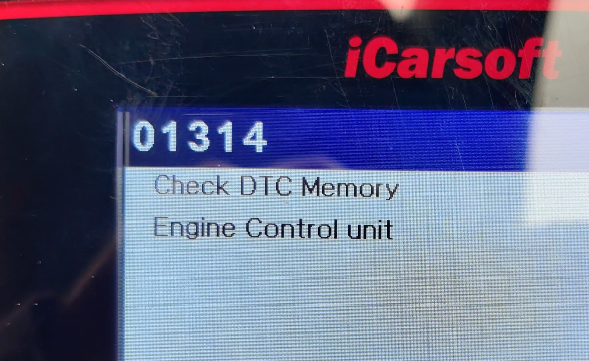

Engine ECUs are usually very reliable, but for some reason this one seems not to be telling the diagnostic system what faults it is aware of. None of the fault codes you've listed are from the engine ECU, they are all from other modules.
Yet the 01314 code says to me that there are codes in the engine ECU which are likely to be key to solving this.
I will look at wiring info for you when I get a chance, to see if anything suggests itself about how to proceed.  I would always tend to blame wiring problems ahead of electronics failures, though of course the latter can happen.

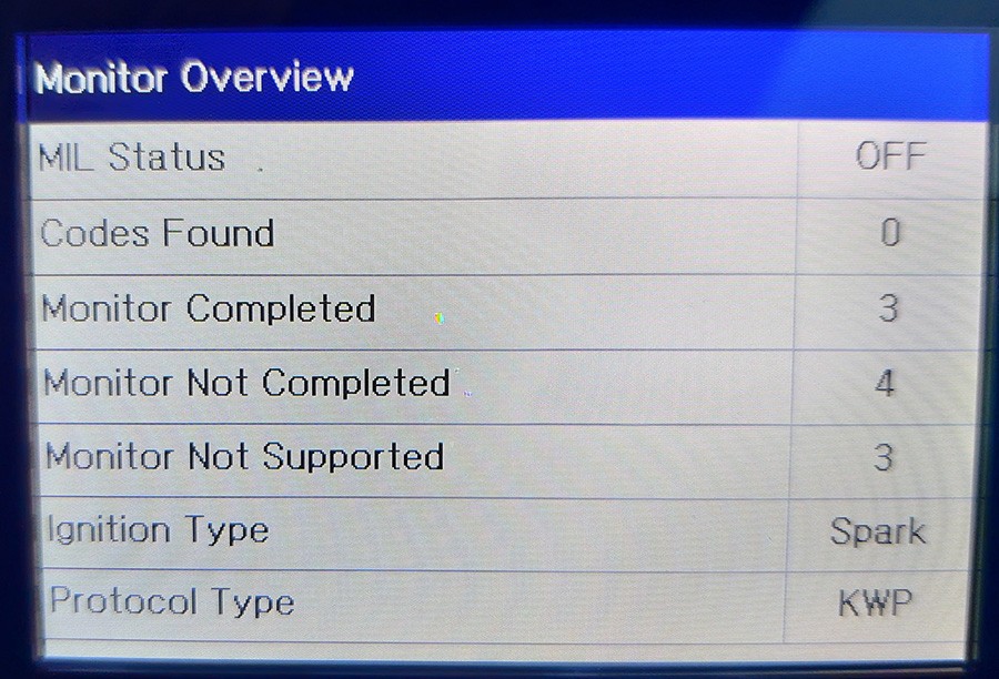

I've just had a chance to go back out to the car & try the OBD2 & this is what it showed, but I don't think it will help much, other than showing that it's not picking up any codes.
It would be good to get a VCDS on it and see which modules that can/can't see. VCDS Lite will suffice, I think. Shame you're not a whole lot closer.
I'm guessing that the engine ECU is one of the the four "monitor not completed" items.

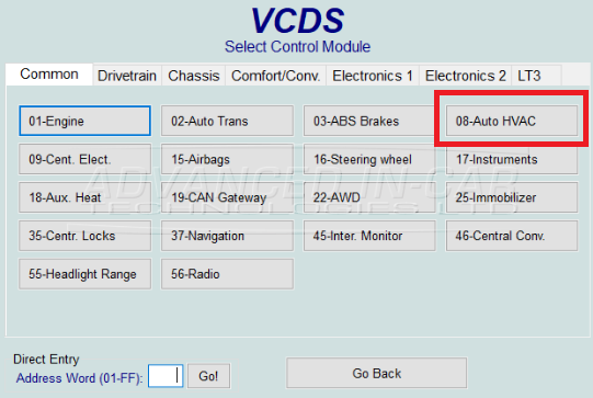

If you scan the HVAC module what does it say? Can't imagine it can be anything relevant, mind.
Maybe keep scanning the engine and transmission modules over the next days, hoping to pick up an intermittent fault before it clears itself.
HVAC Module?
I'm not the greatest when it comes to knowing this sort of stuff, is that something I can get it to scan separately?

Sorry, technical name of A/C control module, number 08, should be able to scan separately.
Will probably give a few errors, like recirculation flap motor, G65 pressure low etc.
