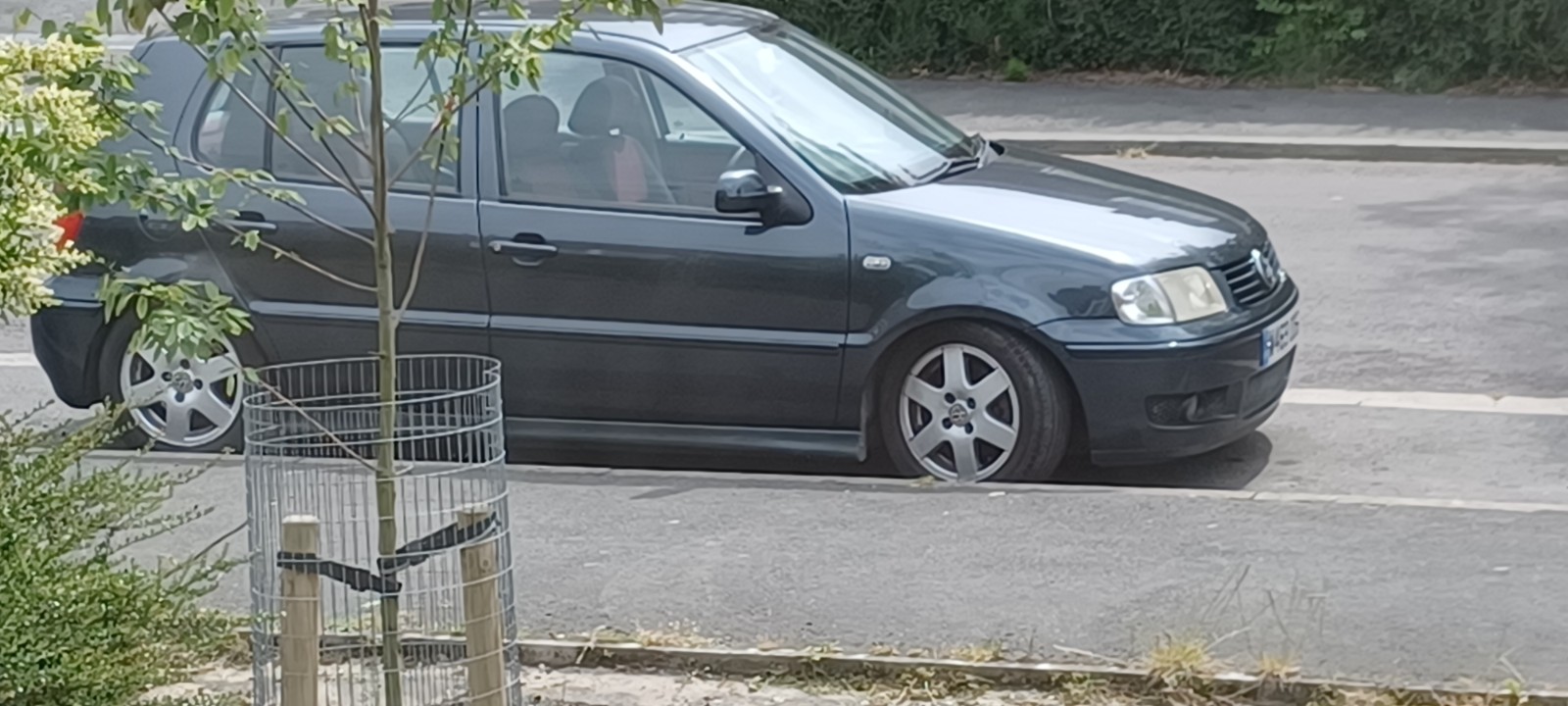

Hi all not long done my first engine swap went from ahw to afk straight swap no need to change anything  now I have the ahw sitting there begging for a build so I have been reading and searching but I can only find one person who has done this with the 1.4 6n2 block everyone else have done it with the afh head 1.6 bottom is there any one out there can help me with parts list thing I know I need are
1.bottom end sourced
2. gti head bolt ebay
3.ahw head got
4.gti water pump ebay
Thing I need help with
1.cam belt witch one ?
2.will ecu be OK or should I go with a standalone I don't mind as I plan on doing a supercharged build in the near future 😉
Is there anything else I'm missing before I start ordering
Not the best pic but let me know what you think
Thanks in advance

You need to know if the block to head height is different to choose the cambelt.
AHW has a tensioner (and small belt for cam to cam) so that cambelt might be okay. Beware the crank pulley keyway is a weak point on AHW, so check for play or fit a new one.
ECU ideally needs a remap to compensate for 200cc difference - even with same camshaft - may need bigger injectors too.
Supercharging will also require compression reduction (like a spacer plate and
two vernier pulleys), custom fuel and ignition map.
