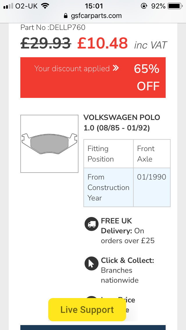

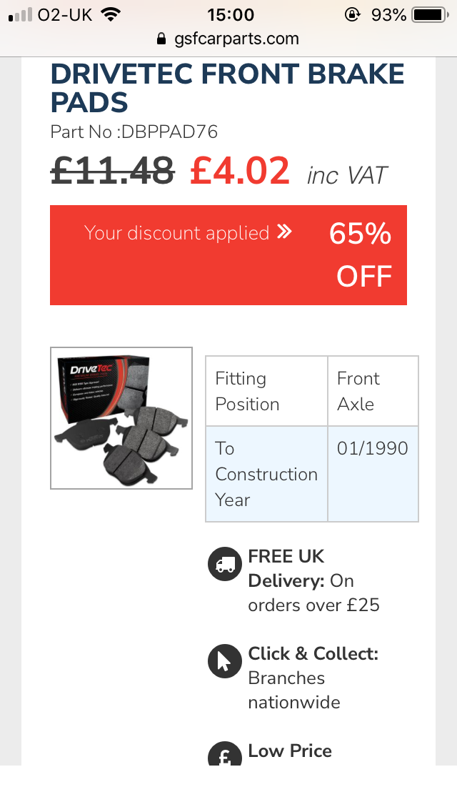

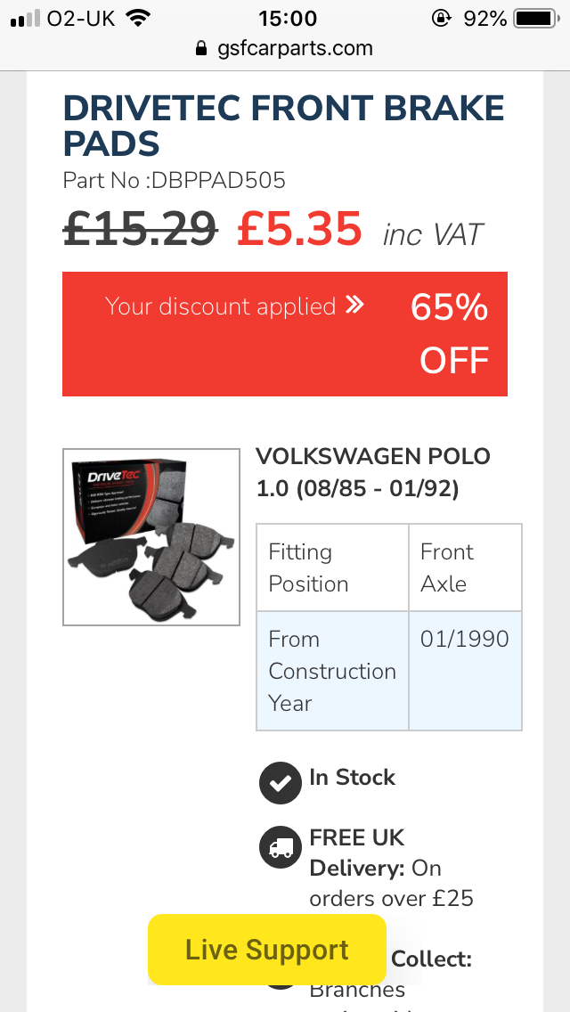

I need new pads for my 1990 mk2, gsf seem to have a few listed and I was wondering if anyone knows which are correct. Mine is regd March 1990, so I was assuming it would be the ones up to 01/1990

  • These are the shape of the ones fitted on my 1L August 89 G plate Mk2 Breadvan, (Teves VW II Caliper?) and the last ones I fitted were Delphi LP505.   https://volkswagen.7zap.com/en/rdw/polo
  • as far as i know...   theres early square pads for like 1984 only ...   all others that look like those in the pics 84 ish onwards   g40 same as 84 onwards but thinner to
  • Just ordered pads and discs from local factors, I’m almost 💯 sure it still has the original discs at 110k.
https://volkswagen.7zap.com/en/rdw/polo+derby+vento-ind/po/1990-9/6/   Shows all the variations, which on chassis number
The VW part number for mine shows as  867698151,   which cross references with the Delphi LP505. The G40 seems to show a similar shape of pad, but a different VW part number and cross reference, probably due to the thicker disks fitted on those models. The ‘squarer’ pads with pins were on models pre 85,I think.
If yours are the same as mine then make sure you have the four pad fitting shims to go with them, they look like strips with a tab in the middle.You can re-use the existing ones if present and  ok.
Edited by mk2tastic
as far as i know...
g40 same as 84 onwards but thinner to accomodate vented disc
try somewhere like avs car parts , give em the rego and they will sell you decent parts , not sure id want £5 brake pads on a car with already sh1t brakes
