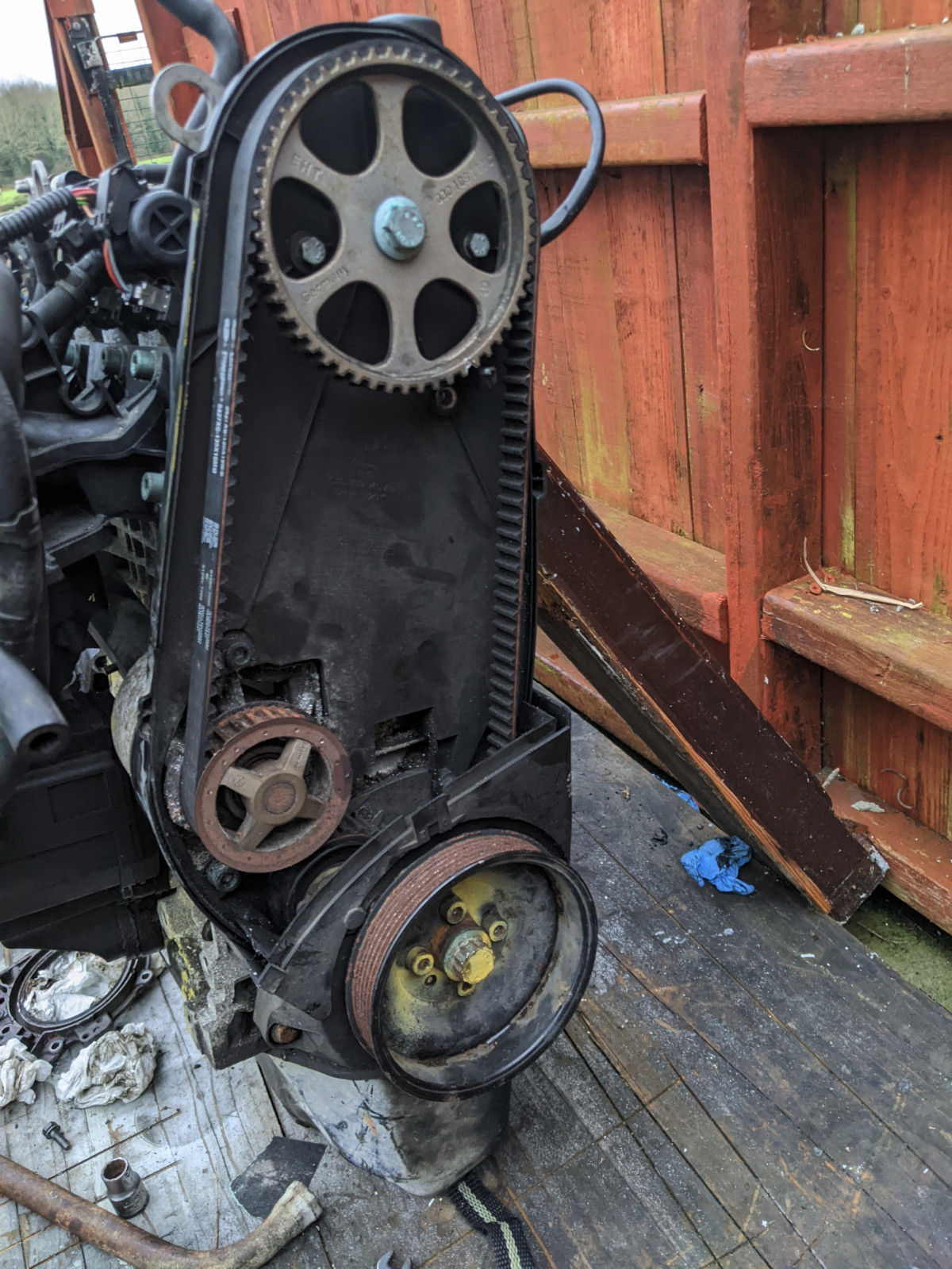

There appears to be no way to attach the engine mount bracket on the new engine. The plastic cover covers the whole right side of the engine?
Do I have the wrong engine or am I missing something obvious. It is an AUC 2001. I cant find anything online about an alternate way for it to be mounted?

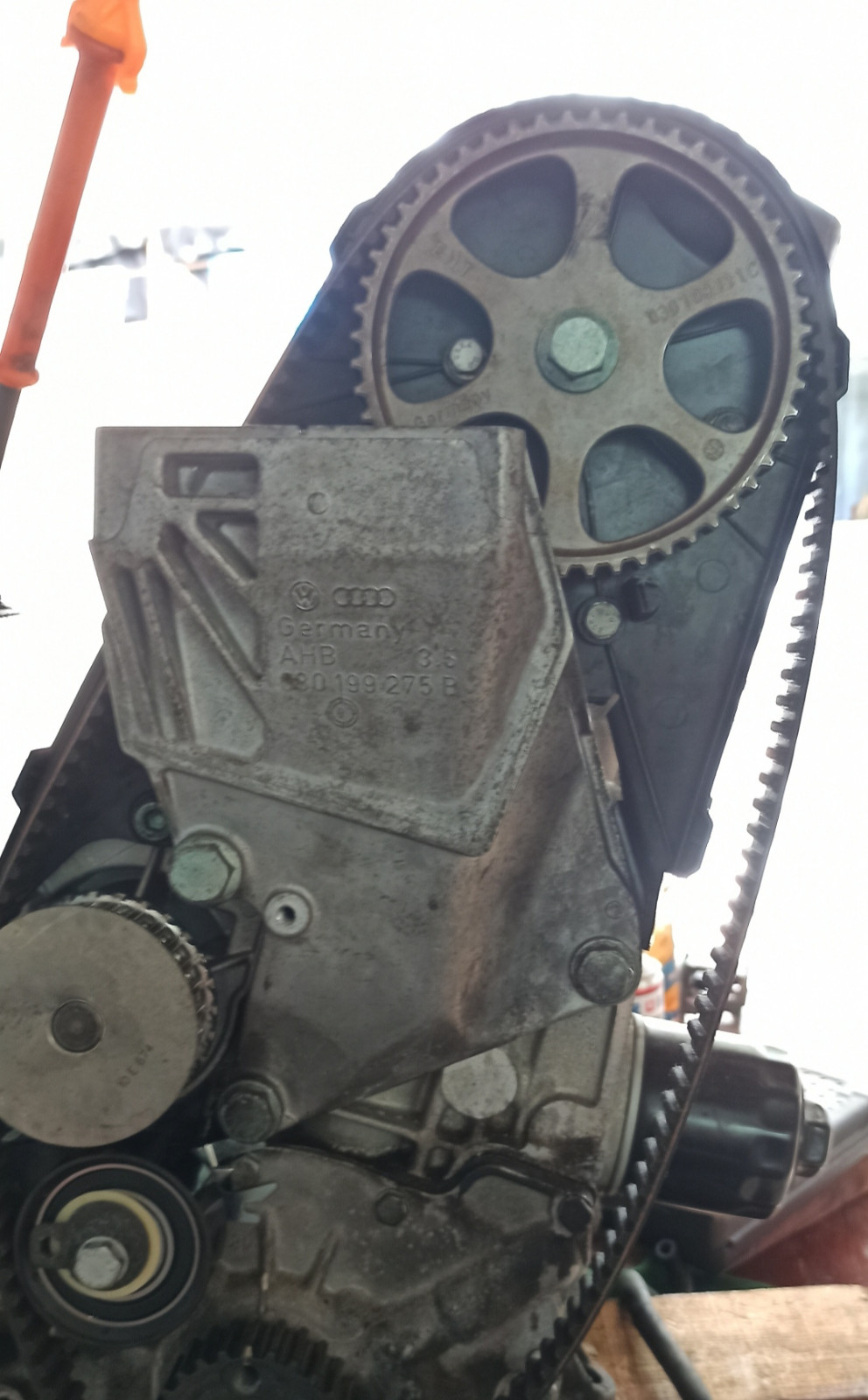

  • I have 1l ALD engine and if the mount is the same as mine you re missing a piece
Here's a pick of an AUC engine mount
https://www.ebay.co.uk/itm/255276088732
Clearly needs 3 bolts in a triangle pattern, so unless there's another L-shaped piece to go around the side of the block, I fear it is wrong engine.
Engine number and code used to be on block front right on old VWs.

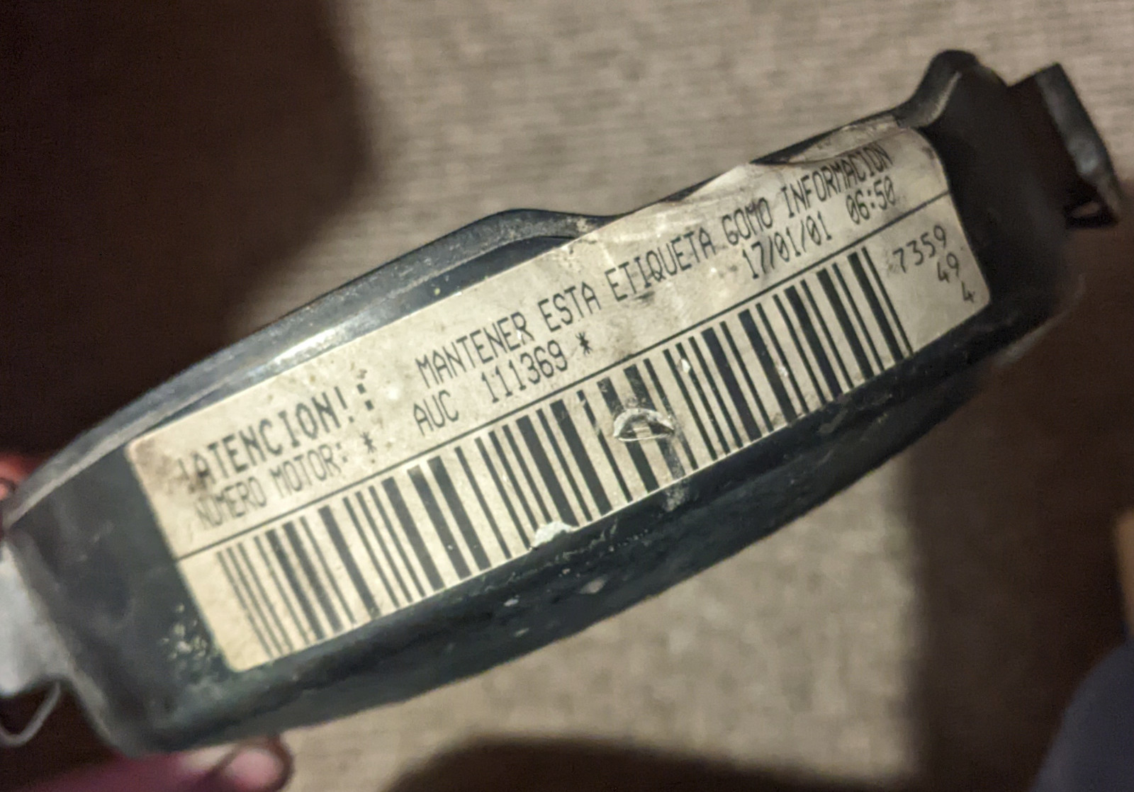

I have that piece from the old engine but there is no way to attach it as the crank cover is in the way. It says AUC on the cover sticker and everything else on the engine is exactly the same. I can't find reference to an AUC engine anywhere that doesn't have the normal mount.
Could it be wrong plastic piece behind the pulleys?
(and surely not an AUC cover on a different engine, though not sure what)
