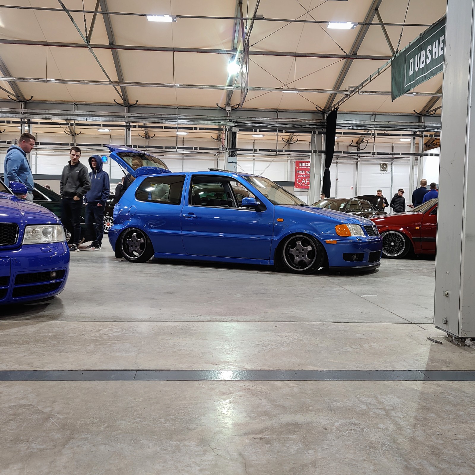

I am collecting a complete 6n 16 valve tomorrow. The shell is shot but I have a wild notion of putting the running gear into my 1.9sdi 6n2. Obviously it's a diesel to petrol conversation but also planning to run bike carbs. Have about 2 months to get it done so any snippet of information would be amazing
