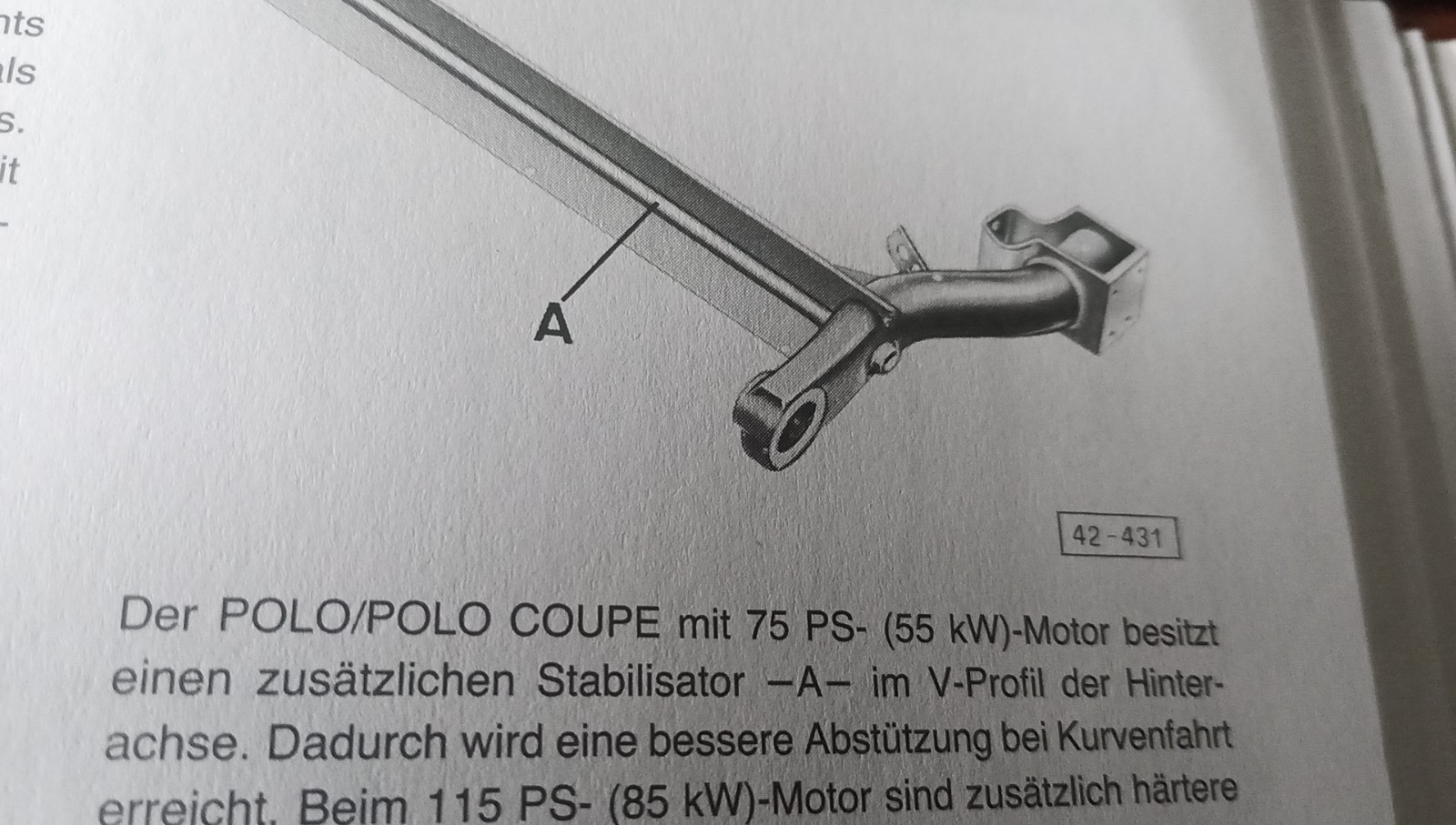

I didn't want to do that simpler way, as my Polo SP rear beam has built-in anti roll tube (A).IMG_20230315_162636_0.thumb.jpg.3f5a05d77aa9da4f3acf1ff502bee574.jpg

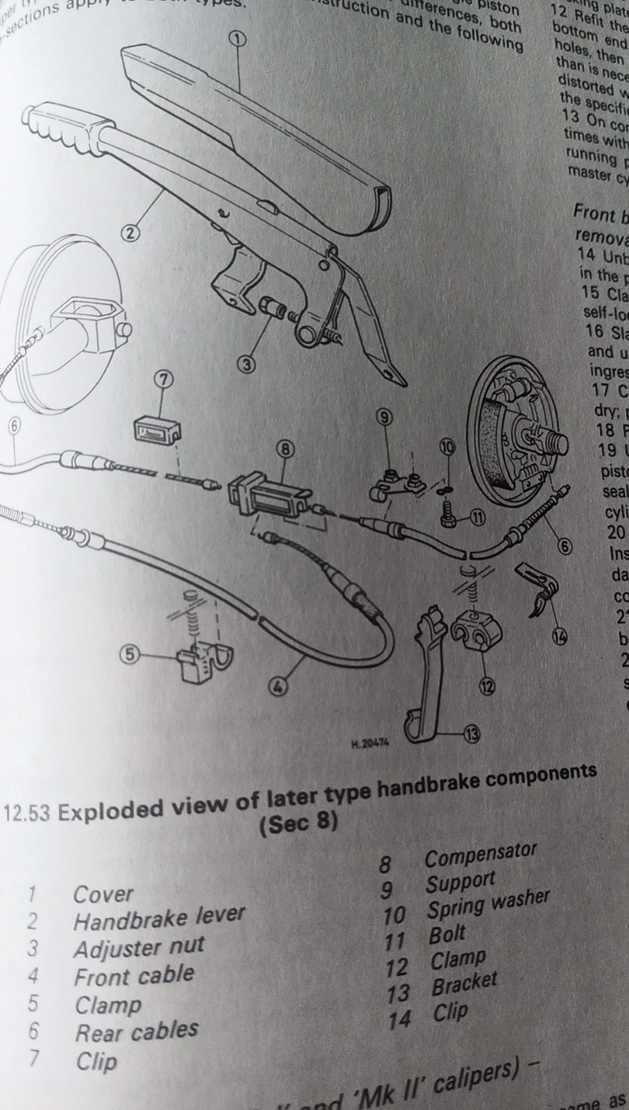

This is the mk2f compensator (8) and new brake cables you would need to fit to existing axle.
New handbrake too?
I think original clamp and clip 5,7 and 9 are vital for holding cables.
But 12,13 and14 could be improvised.

can you just weld a tube to a rear subframe that doesn't have a rear anti rolbar?
It's increasing torsional rigidity, so I don't see why not. But an MOT tester may object to welded "repairs" to a highly stressed component
that is in any way corroded.
The tube passes through the trailing arms, so you would need to be supremely confident in making the holes and welding thick tube to survive the bending forces.
Though I have wondered if a rear sway bar with appropriate track could be bolted on, something like a Whiteline BJR01Z, with mounts attached to a plate in boot floor.
