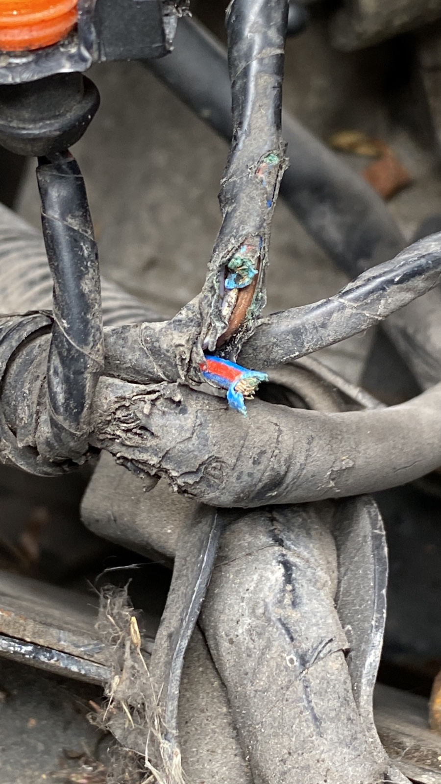

have replaced the rear sensor as per fault code but the light is still triggering with the fault.
is there a way to test wiring from car to O2 sensor ? What voltages should I be finding on which pins ?
also is wiring failure a common issue ? Or did I buy a crap sensor.
TIA
  • Views 561
All Sorted, main 12v power to sensor broken
