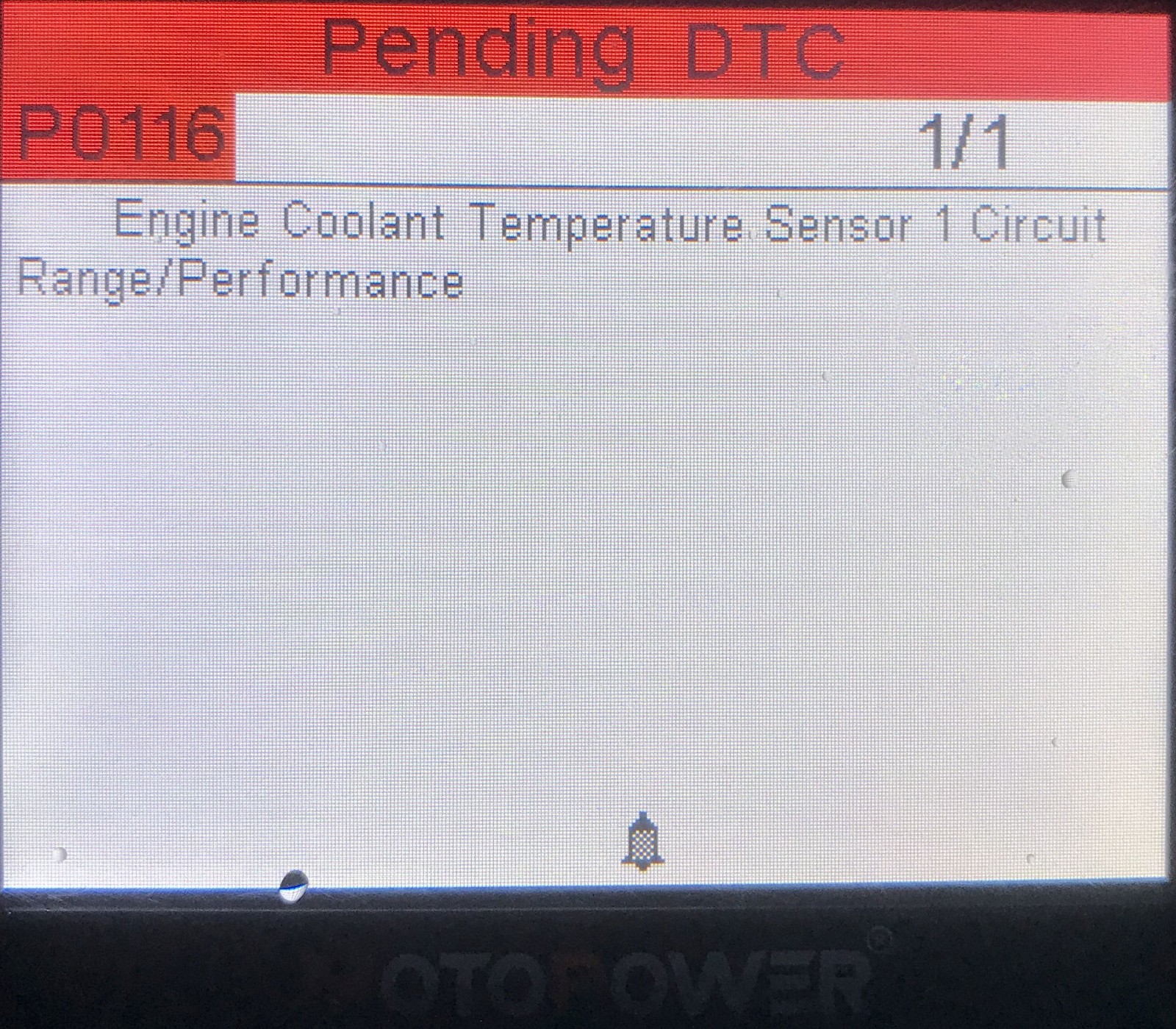

Yes I have a simple OBD2 reader which I'll hook up tomorrow and see what if anything comes up. I live in Esher which according to Google maps is 64 miles from Abingdon.
Code coming up as pending is P0116 which according to my reader is Engine Coolant Temperature Range. I get confused with the Mark's. Its a 2007 car which is a Mark 4 or 7?
Any ideas?

This forum has a slightly confusing way of categorising the marks, it's basically both of those! 😁
Might be worth trying another coolant temp sensor, or trying to start the engine with it disconnected to see if it works better?
Ordered a new sensor and I see if that helps.
Many thanks.
Replaced coolant sensor and cleared error codes now runs much better although there is still a slight hesitancy at times. Could it be wrong mixture still in engine and/or the ECU catching up and I need to do a few more miles? I'll run it a bit more and check the codes again later.
Surprised the coolant sensor could make that much difference!
