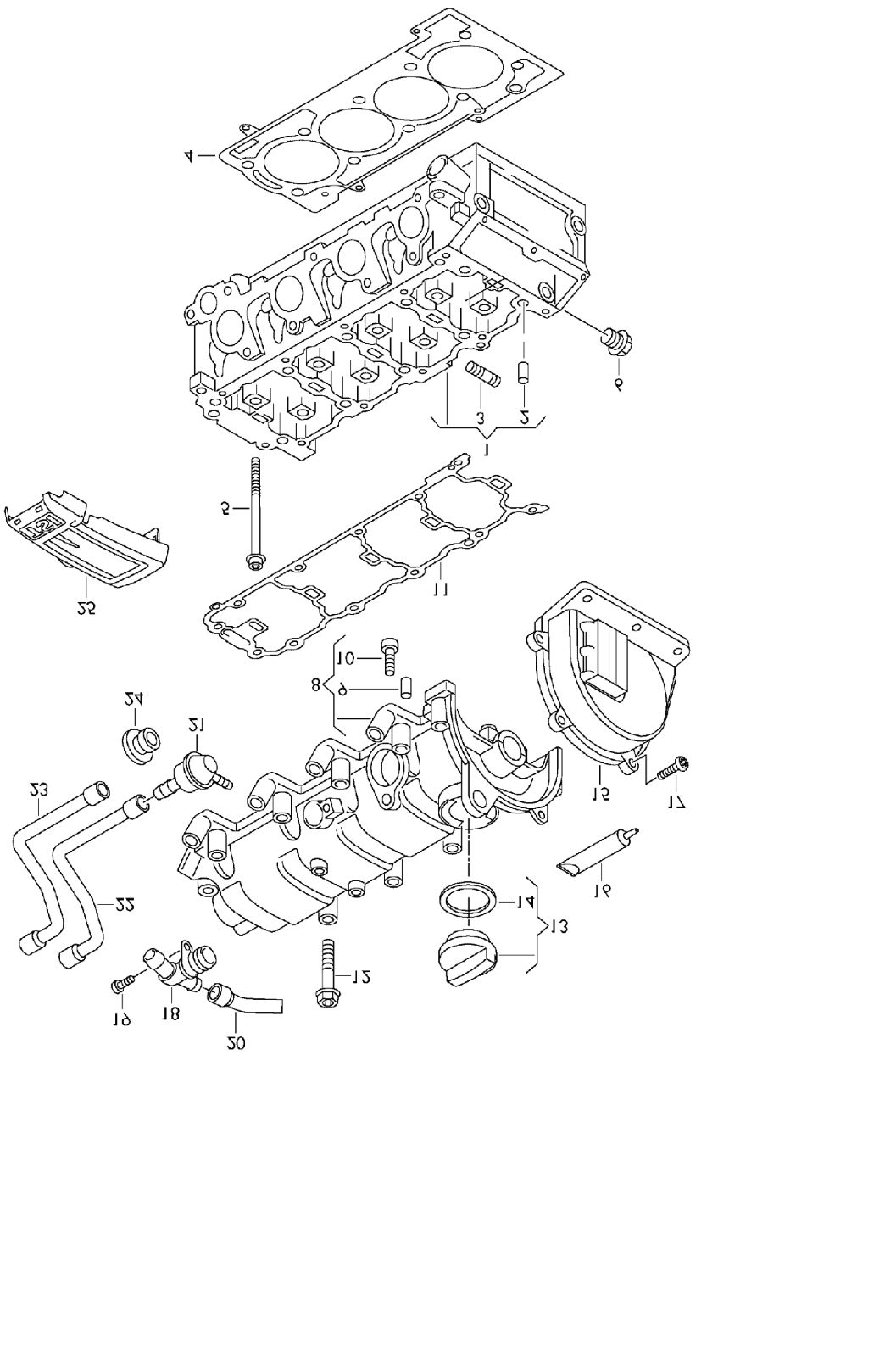

  • This image from an SSP document about the first generation of the 3-pot engines may help to understand the breather arrangement:

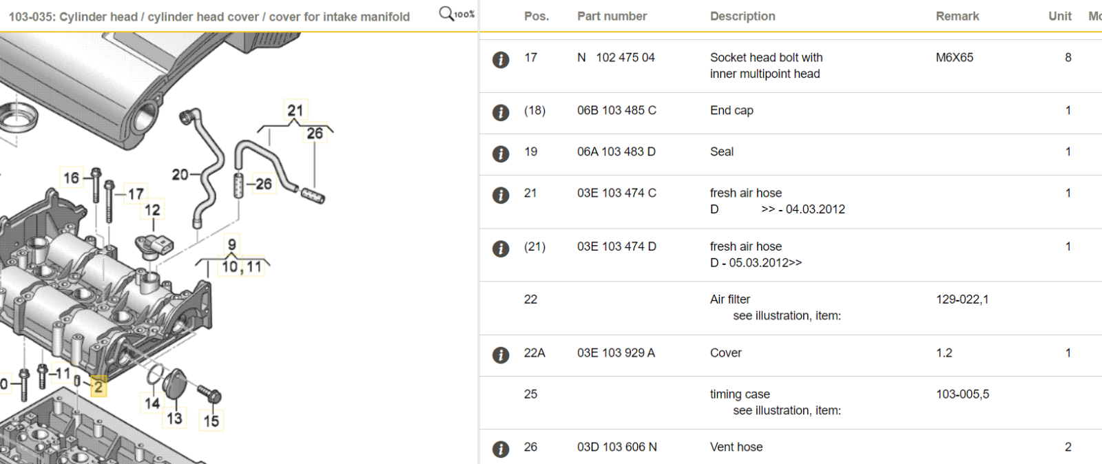

  • Try https://volkswagen.7zap.com/en/rdw/polo+derby+vento-ind/po/2011-672/1/103-103037/   20 and 22 are vent hose (pasted as upside down mirror image, but good on 7zap)
  • @dvderlm's diagram shows hoses that allow air into the rocker cover; the one you have identified from the PCV valve is the breather hose that recycles the crankcase fumes back into the inlet.
Worth checking that you can blow air into the rocker cover through that #22/23 hose. It has a pretty small ID at the rocker cover I think, so don't expect much flow, but it shouldn't be blocked.

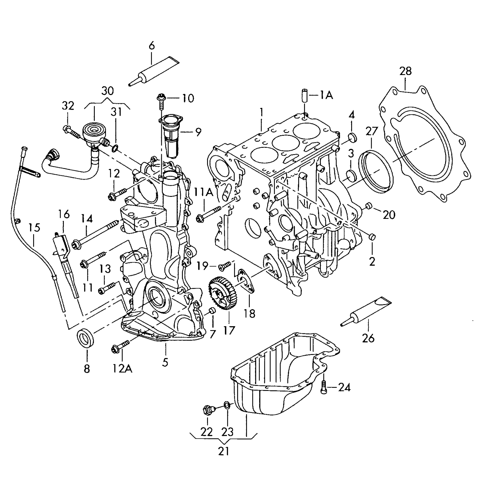

*actually the pic he posted is not for my engine - I think that's the FSI. I assume the equivalent bit on my engine is #30 in the link I posted.

I assume the PCV valve on my engine is the assembly at #30?
Yep.
Here's the correct pic and part numbers for the fresh air hose stuff on your engine:
