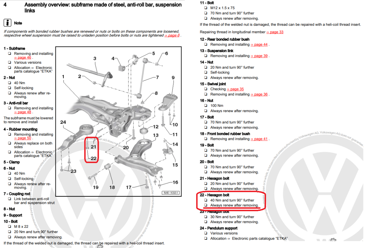

I doubt it will help more than a well planned polite approach, but this is the info that says unambiguously that that fastener should not be re-used. I can't see that they would/could have done the job without removing it.
346544470_Screenshot2023-05-1219_23_48.thumb.png.9cd4f4d69b5963b328f07f9663e678b8.png
