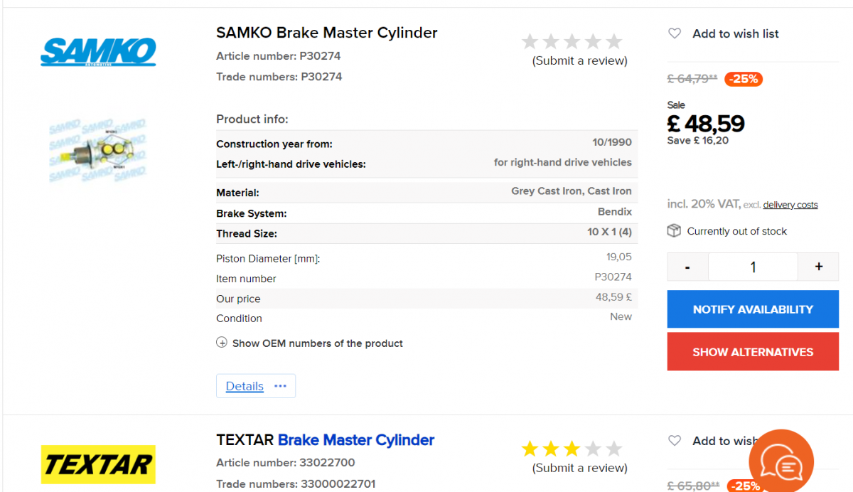

My master cylinder has recently failed I’m utterly failing at looking for a replacement, would this master cylinder work as a replacement?
car is RHD, 1.3 ltr engine, with no brake servo

yours shouldnt have that switch
ive seen others use a mk2 golf one , not the same diameter but they work , might be a harder pedal , could get you on the road again
theres a place called past parts that can rebore your old one and fit new internals , its about £60 though

autodoc germany suggests this is correct?
  • 2 years later...
partsinmotion are still listing a couple of pattern master cylinders for the GT. They look like they;re all 4 outlet though, so you'll probably need to put a blanking plug in one of the parts. People used to use various larger diameter ones to upgrade the pedal feel, so there should be options there.
Thanks, anyone know which larger ones?
