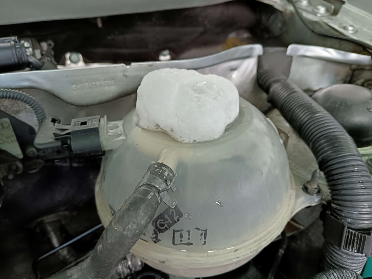

Someone help diagnose the problem please. 1.4 TDI
Water is foaming at the coolant bottle from starting the engine? When temperature rises and I close the coolant bottle, coolant pipes become hard which I think coolant system becomes pressurised.
Fitted new water pump, thermostat, radiator fan switch and heater matrix although heating inside the cabin is not as hot as it should be.
Is there any way the head gasket can be tested without removing the head? There is no oil in coolant system and no water in oil either.

You can buy testing fluids that change colour in the presence of exhaust gases, which would be one form of confirmation.
You may even be able to smell that foam and notice that it smells of exhaust fumes?
Looks to me like you have a type of HG failure where combustion chamber and water jacket are no longer being kept apart. So combustion products are being forced into the coolant when engine is running. You may find coolant goes the other way into the affected cylinder when the engine is off. If this gets bad enough the engine will crank extremely roughly when you try to start it, as it tries to compress that coolant instead of the usual air.

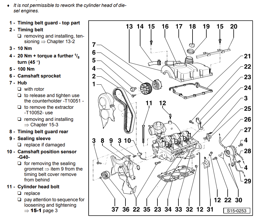

What is the tightening torque for the middle main bolt on the cam sprocket? I undid the bolt which was not necessary.
100Nm by the looks of it, item 5:
