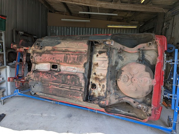

You might want to speak to Steve Lea.  He is welding Haysey's red G40 at the moment and has it in some kind of jig.  Have a look at 20230903_163807.jpg
His username is Sleag40.
Bumper iron bolts front and rear are fine if the shell is properly stripped.
Two bolts in the top bumper iron threads at the front, and two of the little bumper attachment threads for each side at the rear. (the ones just under the boot seal) Replaced outer sills, parts of inner sills, jacking point and many other repairs with it mounted like this. If you're worried about it distorting when structure is cut away, bracing or strategically placed axle stands (or both) can be used.

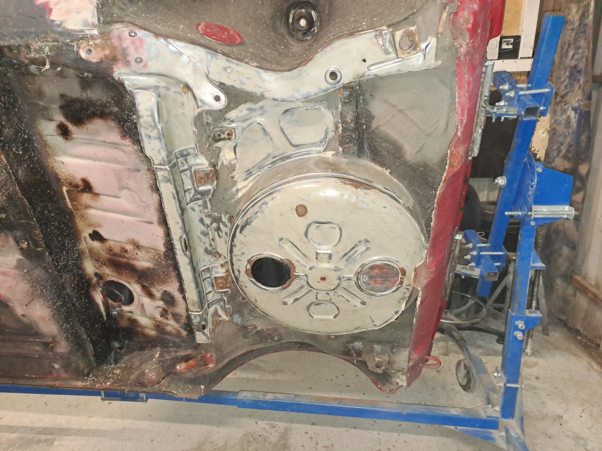

Hi all. That's awesome Steve! I assume when you say to strip the car properly you mean take out everything and unbolt everything (doors/boot lid/suspension) the engine/gearbox and interior is out already. Should the glass come out too? I think there's a bit of rust below the windscreen but dunno if it helps to stiffen the frame slightly? The fella from the jig company said to use M8 bolts on the rear. Looks like you've reinforced around the rear bumper mounts, don't suppose you've got any pictures that show what you've done. So good to know that getting it on a jig is doable. I know I've still got a lot of work (and learning) to do but thanks for showing me that it can be done. Cheers to Yeti Schneil and Steve (sleag40) for all your help and advice 🙂👍

If you zoom in on the brackets at the rear, you can see the two bumper mounting holes on each side are linked. Some 2mm sheet with a hole to take a bumper bolt on each side welded to a piece of box section. The box section then has two L shaped pieces of 2mm sheet welded to it to connect it to the rollover jig.
My jig is away having a bearing fitted to each pivot point as the simplistic design wears out the pivot point holes in the uprights when the jig has had a bit of use. When I get it back I can get you some better close up pics.👍
