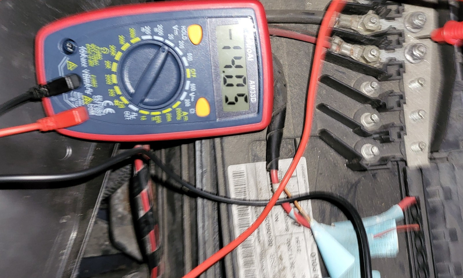

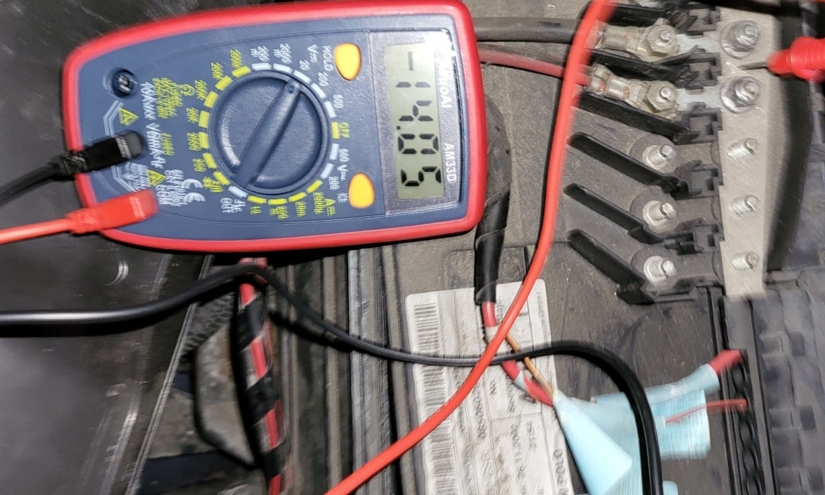

Checked reading with multimeter and I do get a bip but reads low, 002 -008  not sure if thats normal.

There must be a solid 12.5V (or whatever the battery reads post-to post) all along the top of those fuses otherwise nothing in the car will work.
I don't understand what you're doing wrong with your meter, where is the negative probe when you're trying to check this?  Earth point nearest to battery suggested.

Thanks Pete, will double check again and let you know. Apologies I'm a Newby and clearly had my negative to close to positive. Will update you as soon as I can.

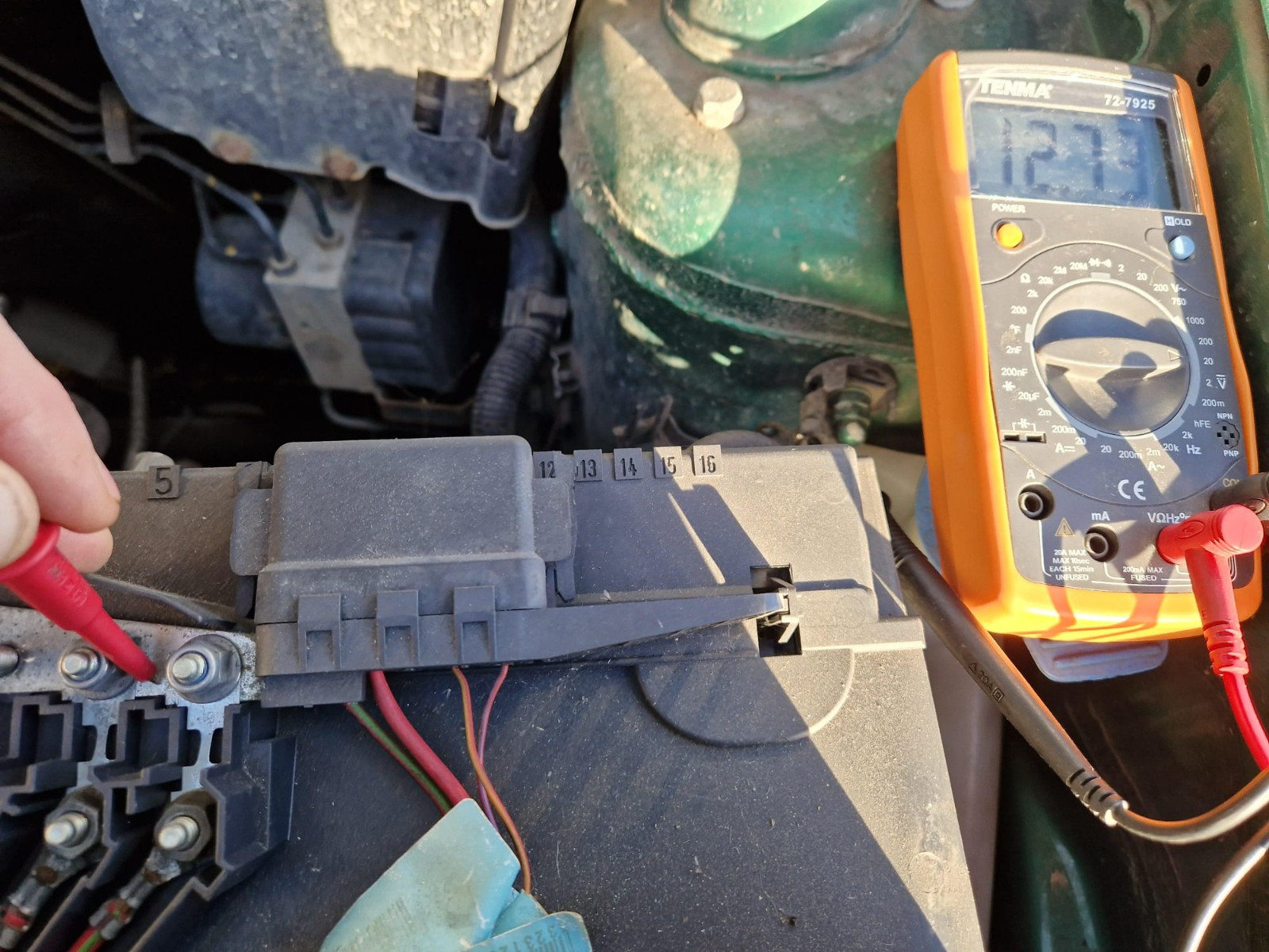

Checked again, and all seems to be correct all along those fuses. Any idea what else could be checked
Some odd looking rewiring has happened there. ABS strip fuse missing, full speed fan strip-fuse missing...

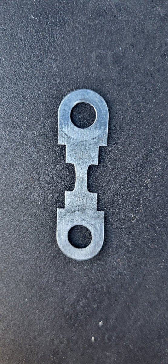

If I were you, I'd undo the nut that holds that red/black wire down onto the strip fuse in position 3 and the one that holds it onto the main busbar (where your probe is shown above), and extract the fuse, just to see if the fuse then breaks in half or something.  Can be really hard to spot a hairline crack, and your photo isn't sharply focussed enough for me to zoom in without it blurring.
Thanks for all the advise, I will do that tomorrow and will provde some better pictures. Is it possible to move them cables on to next available slot on that strip as well just to test if that plater fuse is gone.

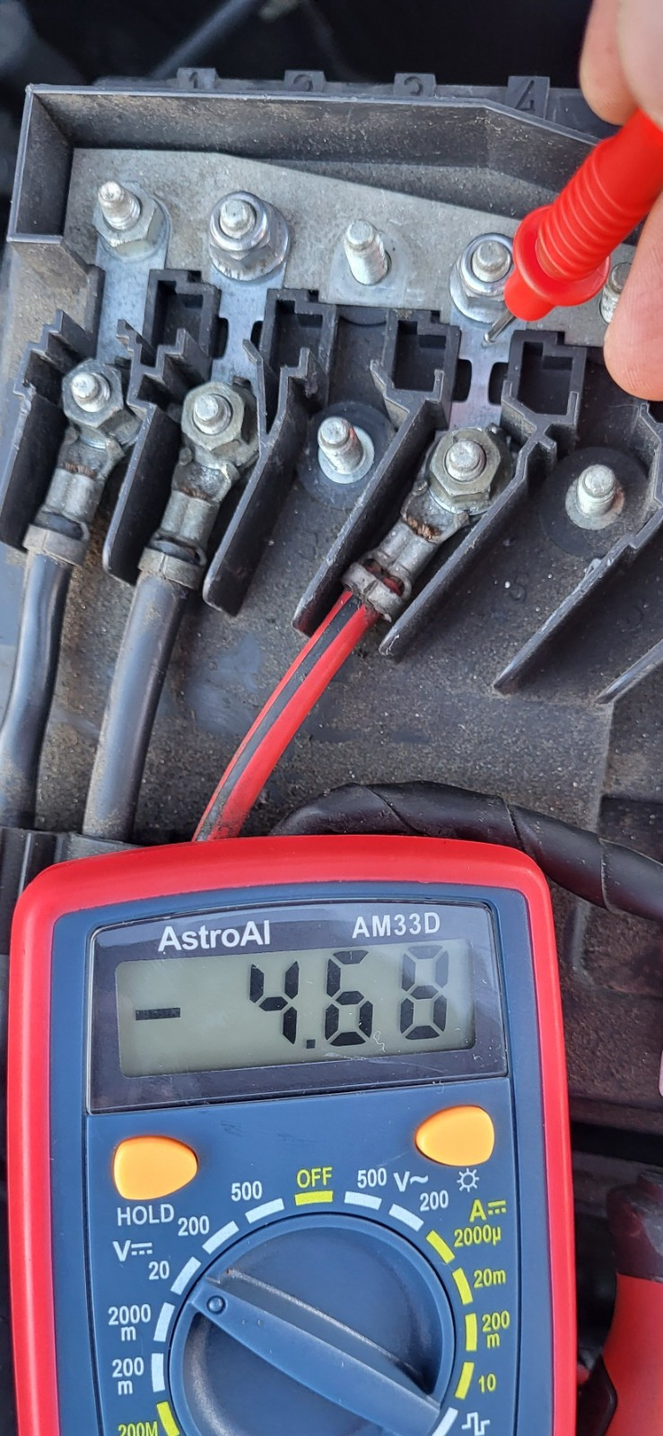

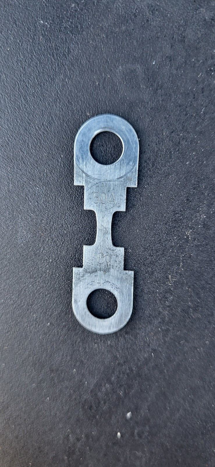

Hi Pete
Checked all this morning and the fuse seems to be ok, I could not see any crack on it. I did clean the fuse and tested strip again and I do get solid 14v now on the reader with engine on and 4.68v with ignition on
I have oy move to different t slot for testing it is now sitting in its orginal location. Here is also picture of the fuse itself

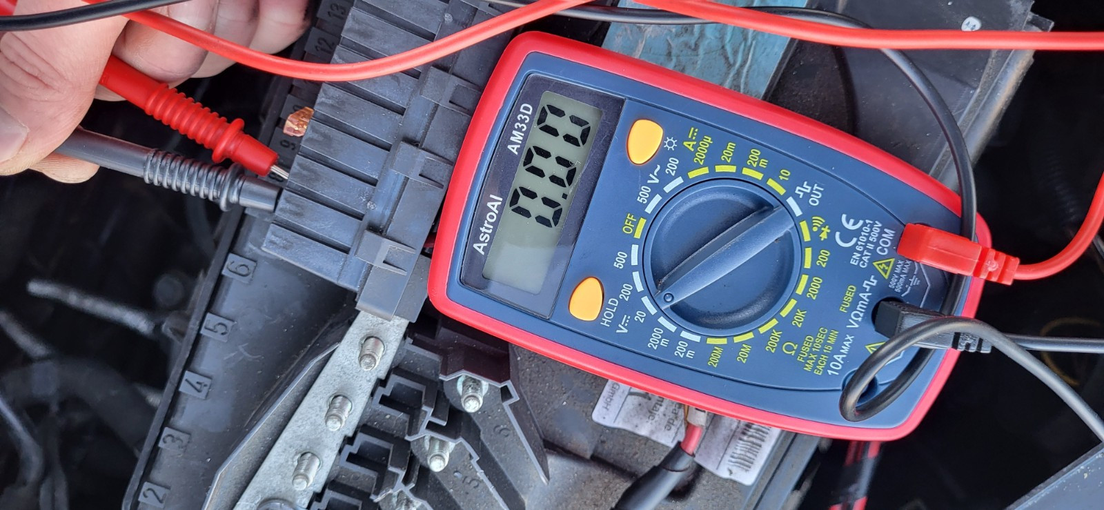

One more thing I've notice is I'm not getting any voltage readi g from this fuse Port where 30amp fuse is located, not sure it this is relevant
And last thing I just noticed is when have ignition on battery icon is flashing on the dash. This battery did died on me couple of weeks ago (when the faults with stearing was already happening) since charged car is starting no problem
Firstly, please swap the plugs at the meter so it reads positive, for positive voltages. Black should be in COM.
Where is the black meter probe when you read that 4.68V? It needs to be on either battery negative, or that earth point nearby on the suspension turret? Something very wrong if that's a true reading. Also black probe needs to be on battery negative, red on fuse socket (one or other side) for measuring the fuse port.  Only one contact of the two will have volts when fuse is out.
Hi, tested again and realised the 4.68 voltage was reading when i have move to next available slot when is back in its organial it is reading 12v,black was connected to batter negative.
Also fuse is now reading 12v when swapped out Black to COM
