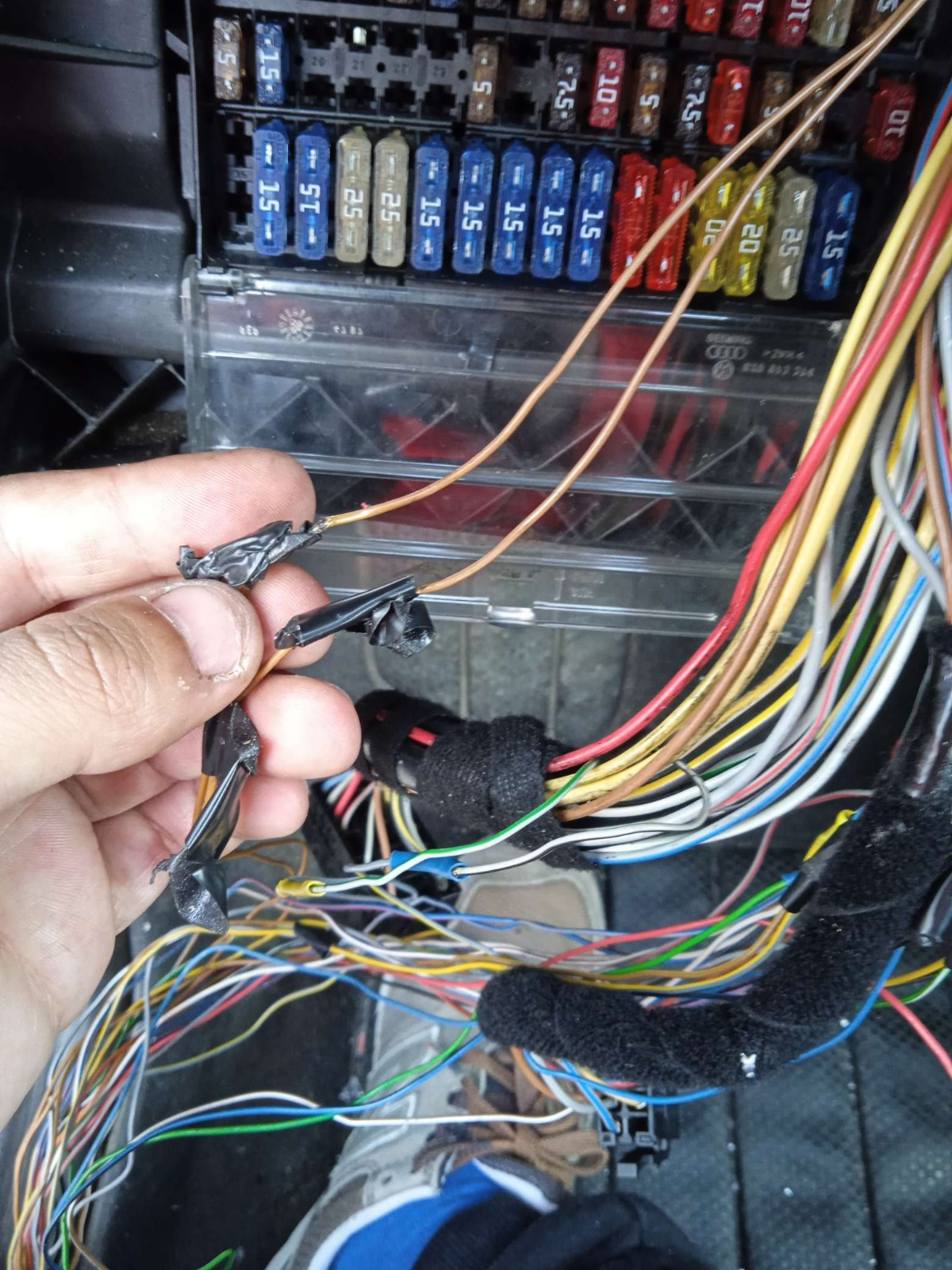

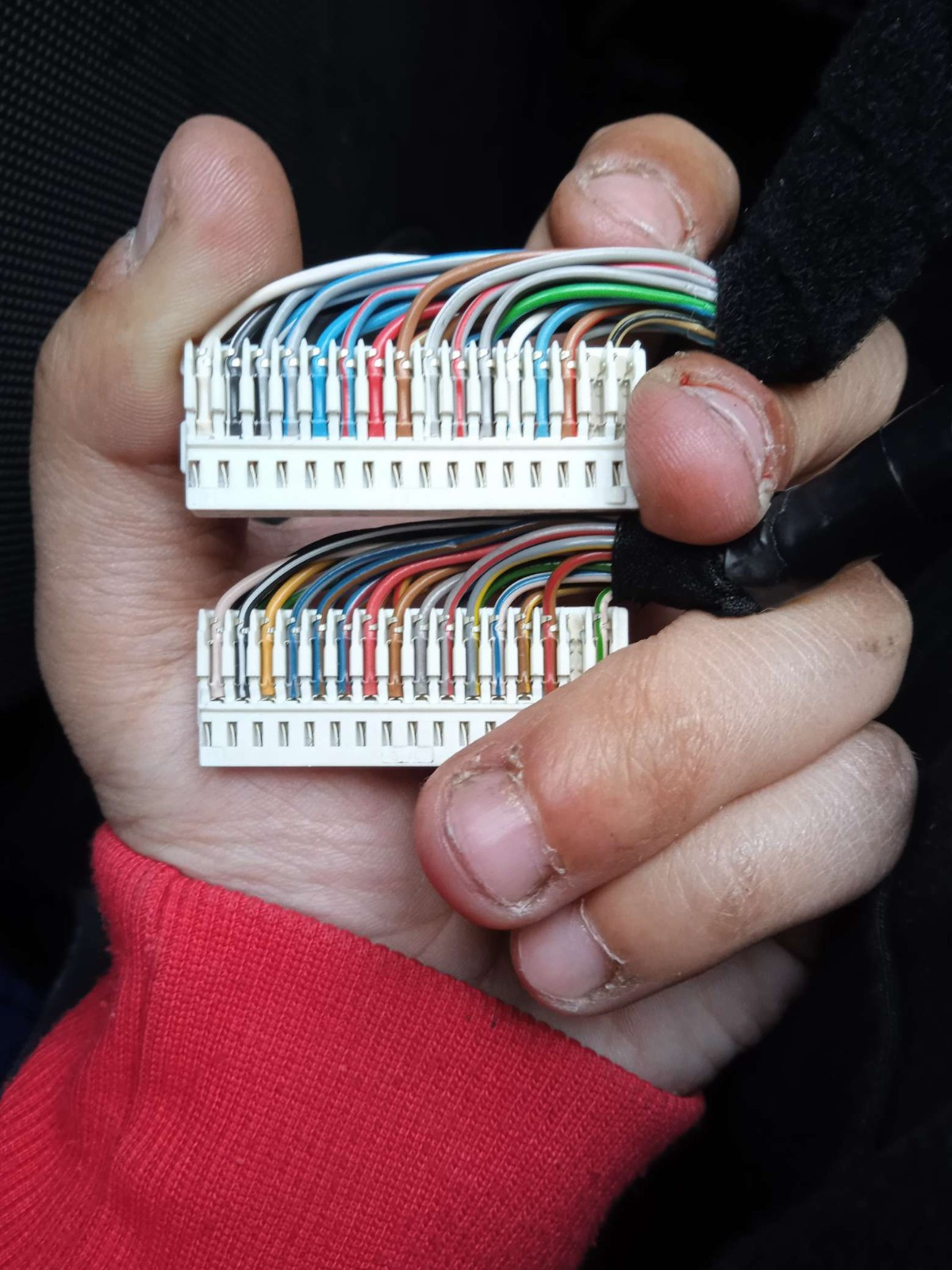

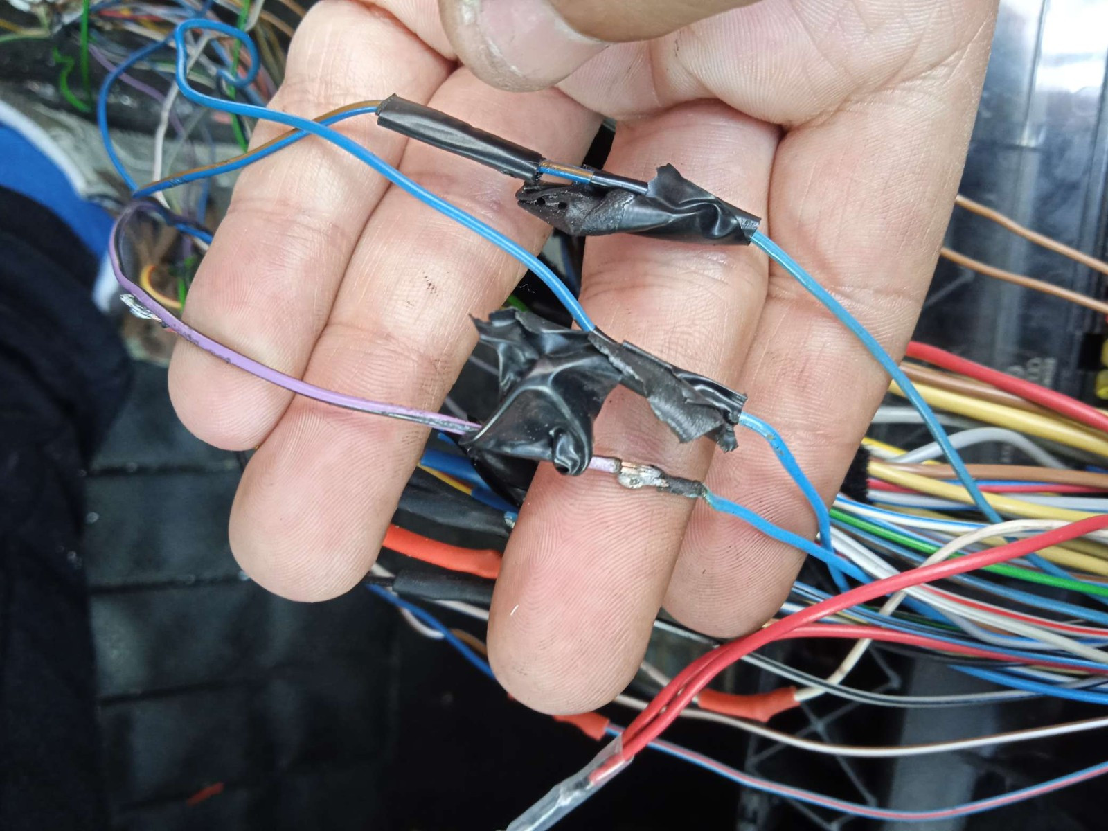

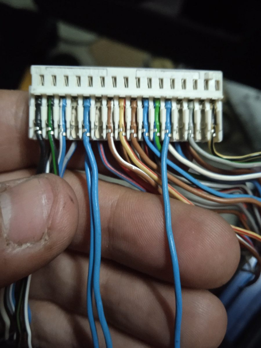

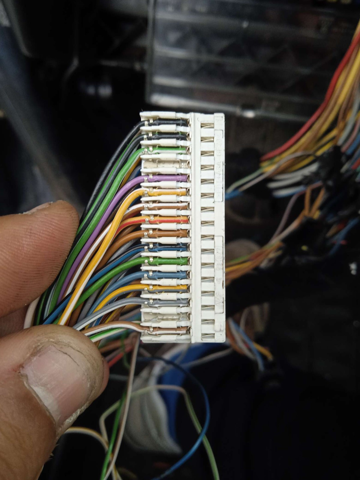

So Im fixing my wirring but made a mistake a cut them all whidot checking The Collor now  i have 2  Browns i dont Know The position and 3 blues .  Compress_20240312_151212_2889.thumb.jpg.43f6b25ae8b508dc7f2d5bd498ab3812.jpgCompress_20240312_151213_3500.thumb.jpg.858a0db1f18cc941002cdb62be108957.jpgCompress_20240312_151215_5621.thumb.jpg.fdb33bf294ff2fa3a683768534732c97.jpgCompress_20240312_151607_7157.thumb.jpg.af0f7f8679946771f6a1b0a4367e5eb2.jpg

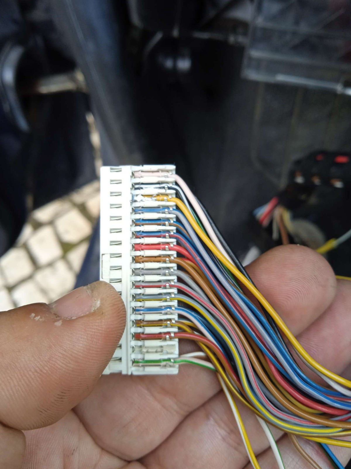

The top One os The original Compress_20240312_151214_4597.thumb.jpg.6dbebe293173bbbdc8b1623de3417935.jpg
Any Help ?

  • Looking at the OEM wiring diagram  Pin 12 Blue wire goes to the Alternator D+ terminal  Pin 21 Blue wire goes to drivers door open switch  Pin 29 Blue/Brown wire goes to Handbrake switc
The Brown wires are ground wires and the Blue wires will have a tracer colour without knowing what the tracer colours are it’s impossible to advise you

Nope They are all blue

In one of your previous pictures you can see one of the Blue wires has a White tracer
Pin 29 Blue/Brown wire goes to Handbrake switch & Low brake fluid switch
So i can join The 2 Browns They booth negative

Só The k Wire negative whats The PIN off ir you know ?
This is The conection that i found 17103341906569156923201016872326.thumb.jpg.bdce993abd9d8df54515b9f9c650d8cc.jpgthis is pin 23

This is power and The ODB is getting power from this Wire
K line os PIN 25
