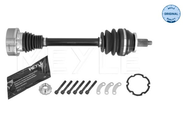

Got quite some play and noise in the inner UV on the shorter-side driveshaft.   Planning to change it on Mayday bank hol.
1 end hub side + nut,  2nd side flange with 6 splinebolts (to gearbox)
Decided just to make the job cleaner and got a new complete set, incl. 6splinebolts, rubber seal, grease,....   rather than just change the U joint itself.
Bought the MEYLE, ...exactly like this:   https://www.ic24.uk/products/g0yddb-drive-shaft-100-498-0724
Car is:  2014 Polo V 6R 1.2tsi 16v  (timing belt, not chain)  66kw/90hp  CJZC engine
1   Just would like to ask someone kind enough for the Nm torques for the 6 splinebolts  and hub nut     (1st + 2nd stages)  ?
2   Been told its just a simple replace (3 lower arm 19mm nuts, balljoint, swing-out-the-way, hub nut, 6 splinebolts )  Plop old out and new in !
      i.e.  no worries about trans oil leakage/replace.  Gbox will not leak.    Was I told right ?
Many thx for Nm + confirmation of job procedure.
Phil

    🙂  ... just to thank those who helped with info.   The driveshaft replace was fairly painless.  Easy all the way, until the rust held the old driveshaft to the gearbox (in a small 5mm recess)   6 spli

🙂  ... just to thank those who helped with info.   The driveshaft replace was fairly painless.  Easy all the way, until the rust held the old driveshaft to the gearbox (in a small 5mm recess)   6 splinebolts no prob.   This rust needed persuading to let go of the past with spray, dull chisel, hammering and time.    Then easy to finish.
