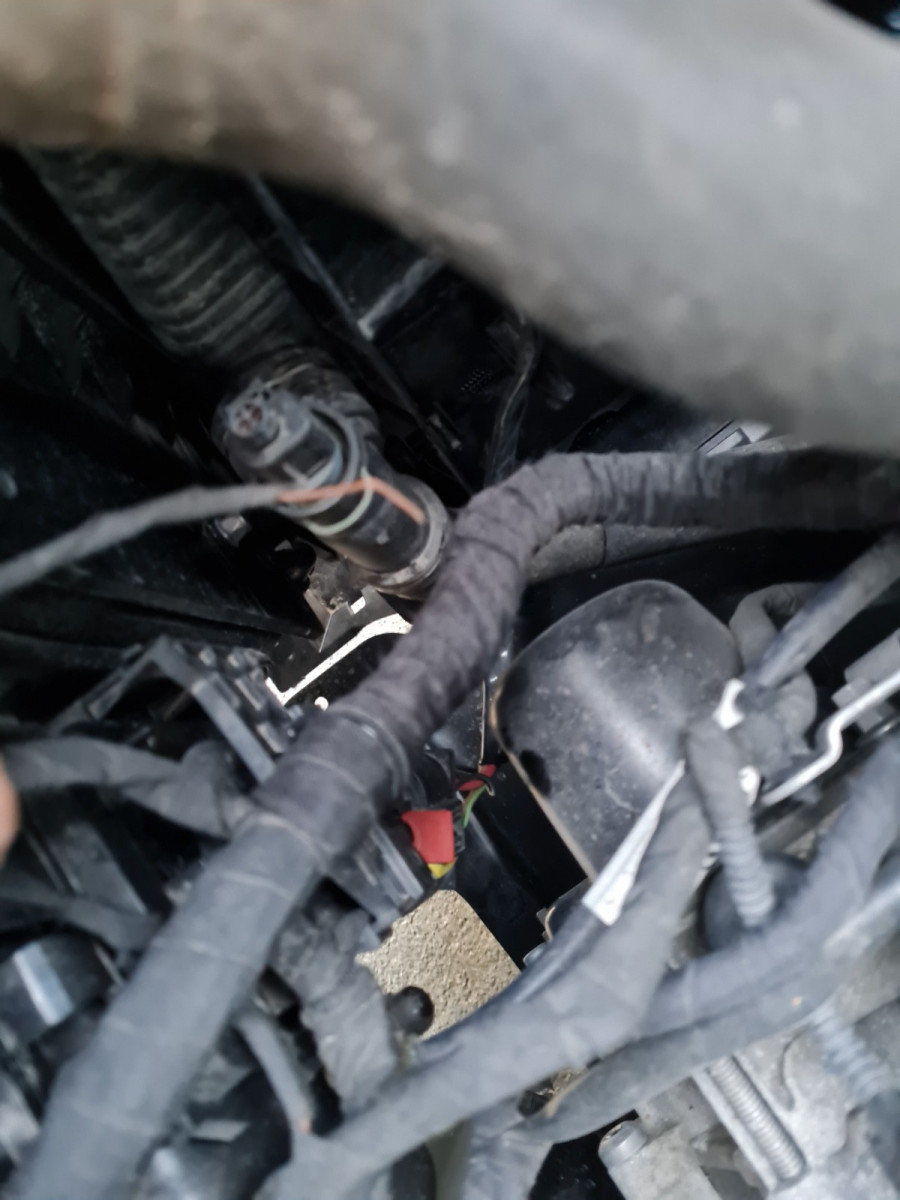

Hi all
I have a 2019 1.0 tsi auto Japanese import
The 2 pin wiring for fan thermostat switch are cut
Anyone have a wiring diagram I'm notnsure which way they go on

  • If it's obvious which connector positions the wires came out of, I wouldn't worry which goes where. A thermoswitch won't care; nor will a thermistor.
Thanks pal so I could technically put then any way around and all will work fine without eml on dash ?
Yes
20 hours ago, Pete1 said:
Yes
Thanks pal. Hope it works I've got an engine management light on at the moment I'm sure if because of that I think
