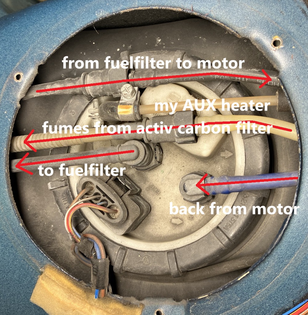

2 - I cant seem to find any diagrams of the fuel system pipework. When changing the fuel pump I had the flow and return pipes going to the pump, but there were also two other pipes that were routed over the top of the pump, where do these goes. If anyone can point me to a schematic of the pipework that would be much appreciated.

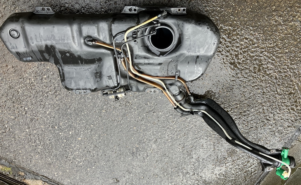

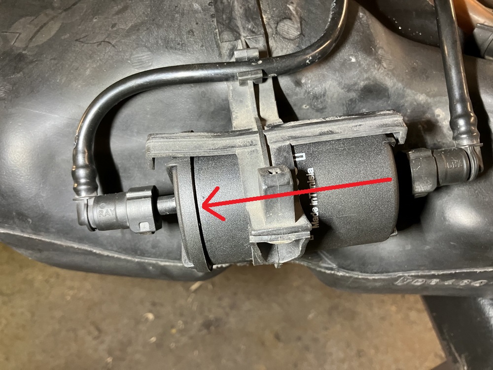

2 - The pics are from a late 6N1 which will be very similar to the 6N2 system.

Changing the relay is easier, the filter sits down, deep down under the polo above the rearaxle.

Thanks Christian. That picture with arrows and labels is exactly what I needed!!
