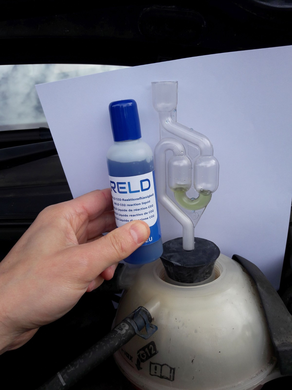

Think I’ll have a go with one of these in the next few days: Reld Cylinder Head Gasket Tester

Ok. So it's not good news. I did this test ages ago but not posted results. Wondering if you can get a false positive? I didn't over rev the engine because I was worried about doing more damage. I mostly let it tick over. When it got to about 70c on the temp gauge it just started to turn yellow (on the expansion tank side) but I was chicken to go any further. Anyway I gently squeezed the radiator hoses and it was enough to push gases through and turn it yellow very quickly.
Been thinking about false positives and coolant contamination from squeezing the hose. So I put some Reld in a small container and steadily added coolant mix from the tank - it just went a weaker blue but didn't go yellow. I heated the container up a little and it made no difference to the new colour. Later in the day I blew through it with a drinking straw and after a few blows it went yellow - more and more the more you blow. By the way I'd left the original test on the windowsill overnight and it regained a lot of it's blue colour - the yellow certainly went away.
