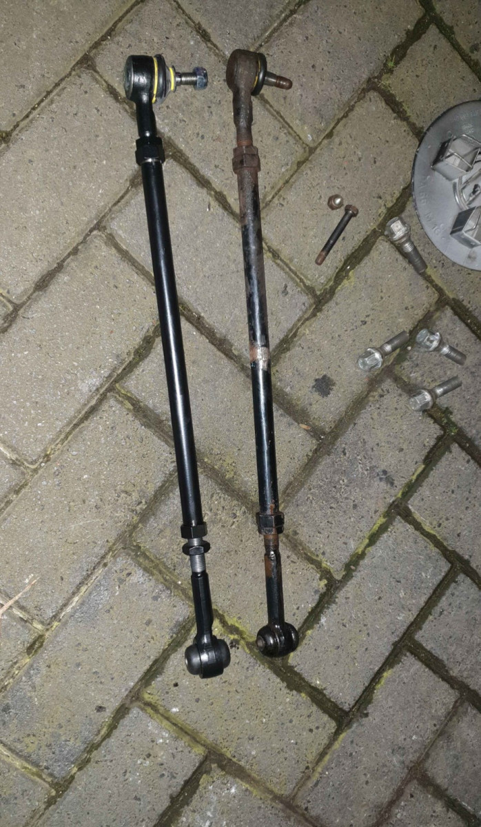

I had just learned about AutoDoc being a thing, so I hopped straight on and went to town! New control arms, steering arms ordered, discs and pads. Now that leaves the shock absorber situation.. I had a look on here for the first time ever, to see what it took to replace them, and stumbled upon the best lowering kits thread! There I learned about the H&R kit, so to make the insurance slightly happier (thats at least what I thought at the time lol), I opted for the 35mm H&R kit instead of the 60/40 kit.
A few weeks later and... everything arrived! I knew it was gonna be a big task for me to do this myself at that time, but it had to be done!

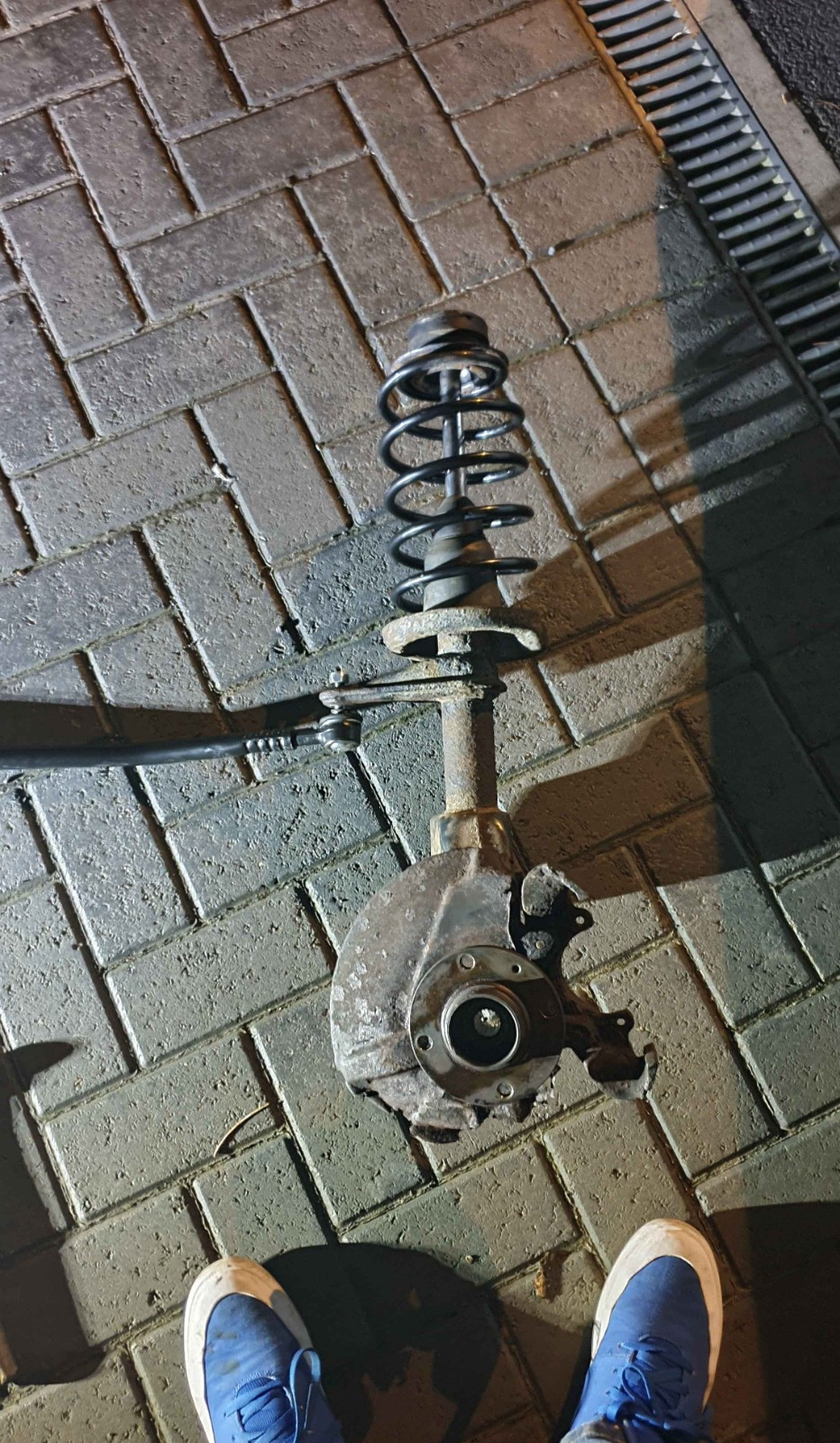

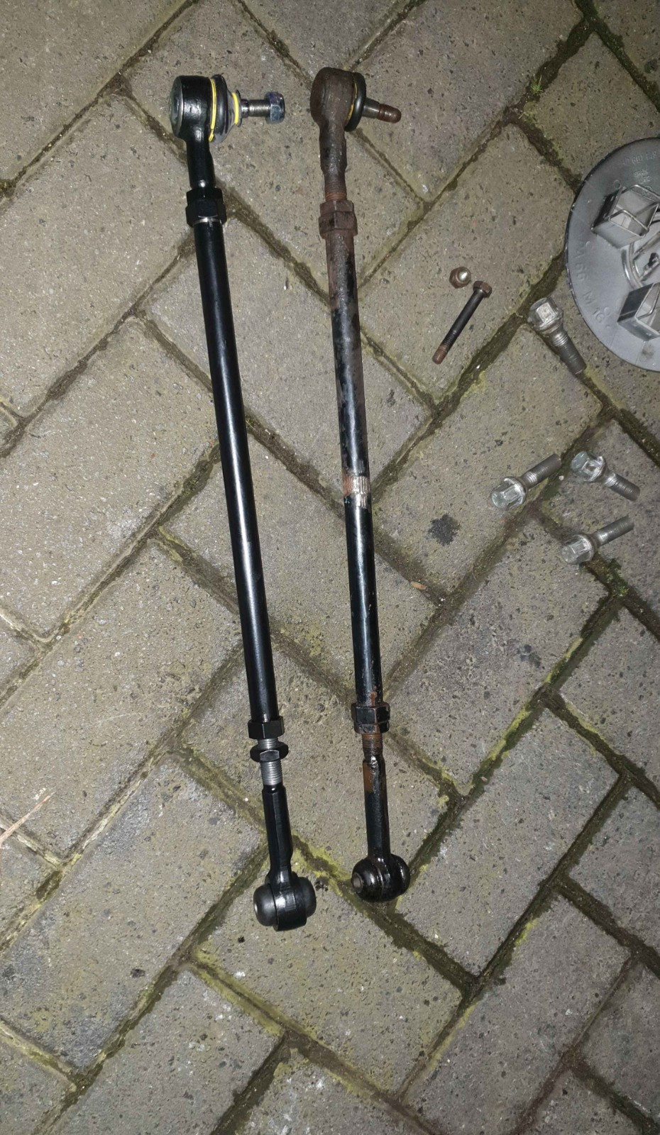

And so the work began! I took my time trying to remember how things went back together, and aligned the new steering arms with the old ones, and they went on with ease, in comparison to the old ones!
My old cat Diego really enjoyed the autodoc box
Somehow, some way I had done it, I managed to do what was once a daunting task, but now being more familiar with the quickest way to take the struts out (keeping the steering arms on the struts and unbolting them from the steering rack, instead of trying to get them off the struts), I thought it wasnt so bad!
A first test drive was in order, and all that hard work paid off! It drove fantastic!

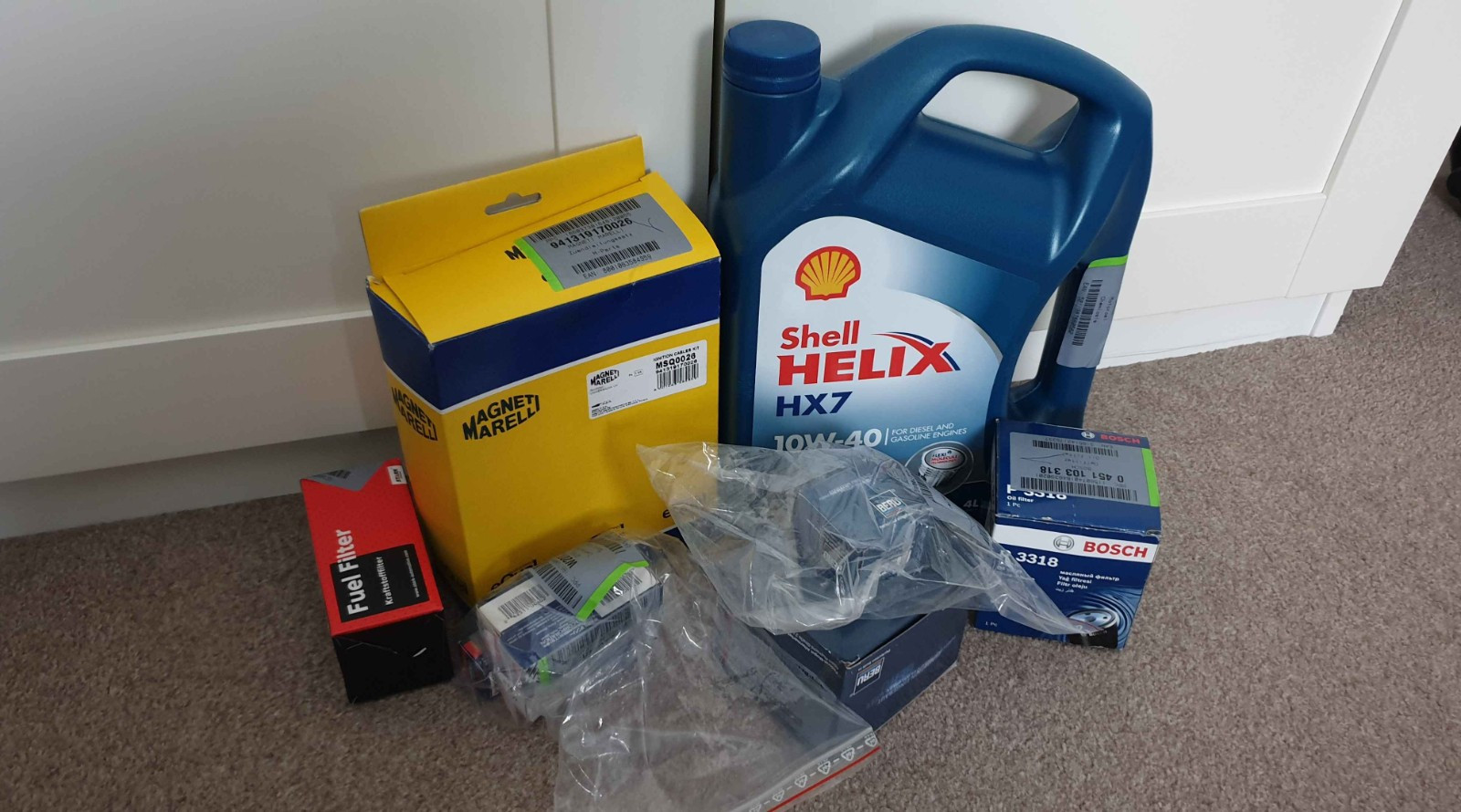

Ordered a few service bits (and the wrong fuel filter lol, which would come back to bite me much later on) and gave it the first oil change. It was so great to have the Polo on the road finally and MOT'ed

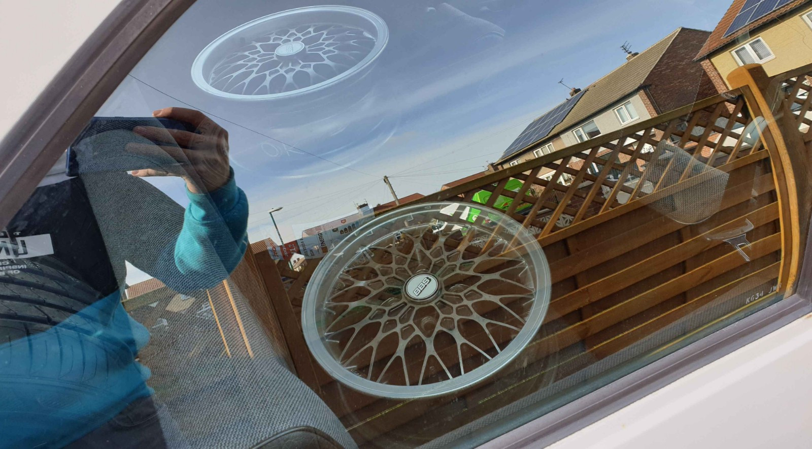

Ordered some MIM 1300 wheels for it, went to get some new tires fitted and they looked great!

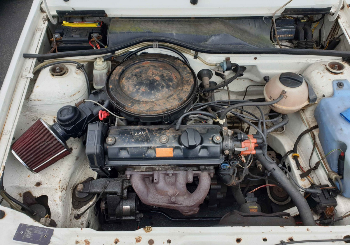

But, I wanted to dive even deeper. I knew it hadn't been looked after well engine wise, as I had to change a stuck thermostat before, and the coolant that came out was baby poo brown! So I set about doing lots of research on here again, and started gathering bits together to do the head gasket and just generally go through the engine and learn even more about how things work and go together. I even got a steal on a G40 rocker cover, so I was definitely gonna paint that up and put it on.

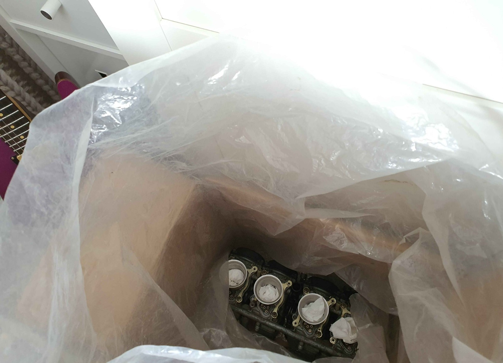

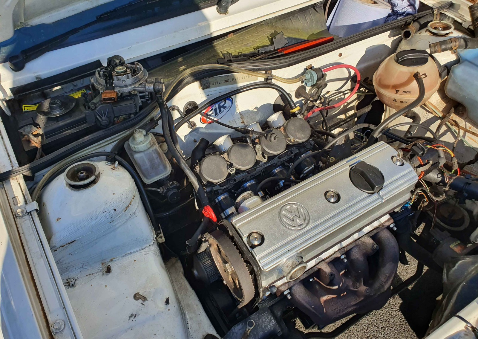

After a bit of looking on marketplace, I found a set of CBR600 F3 carbs for pretty cheap, the guy had them on a AFH powered MK2F Breadvan, so I boshed him an offer over, and before I knew it, these showed up.
Edited by Yak

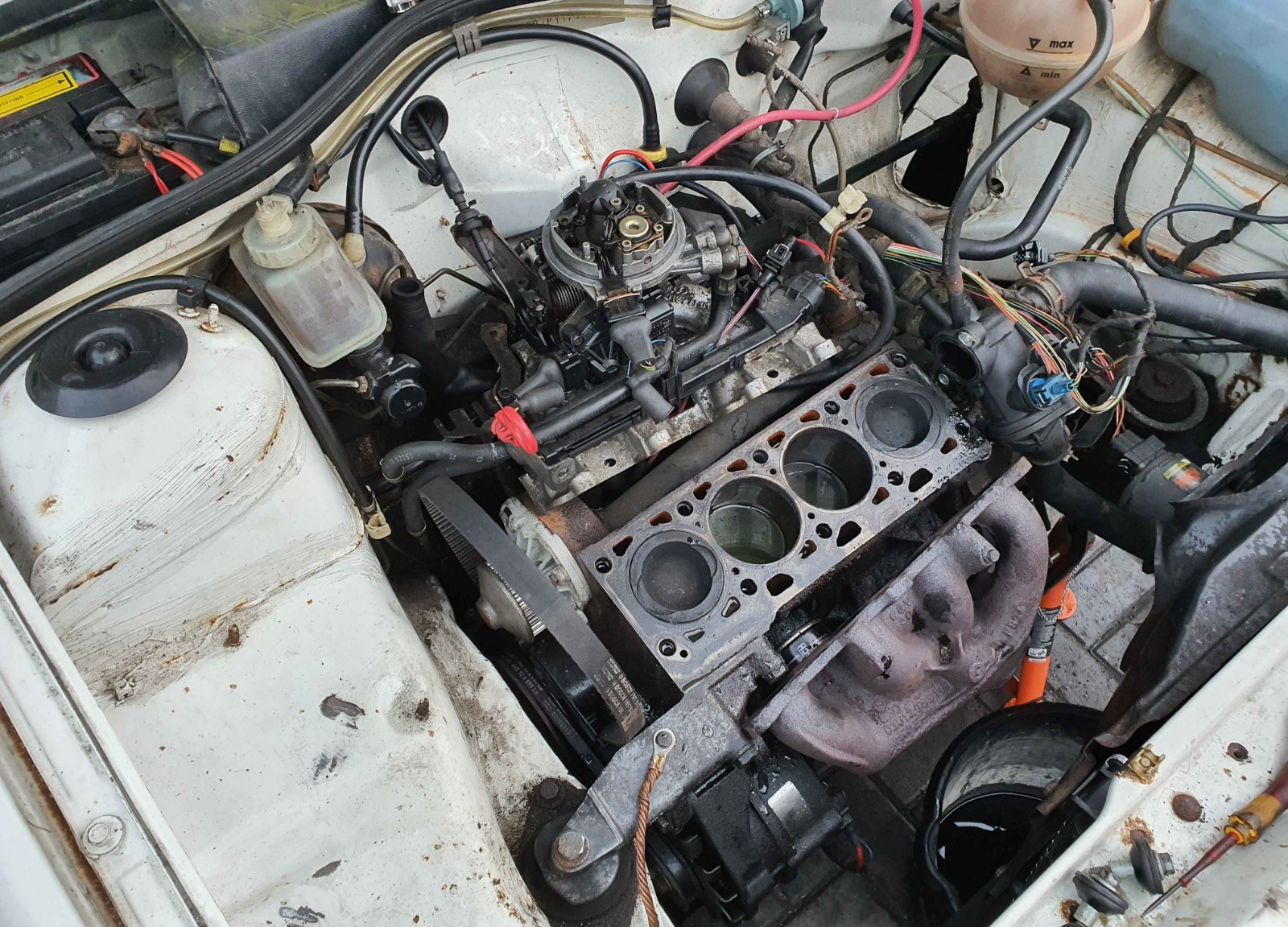

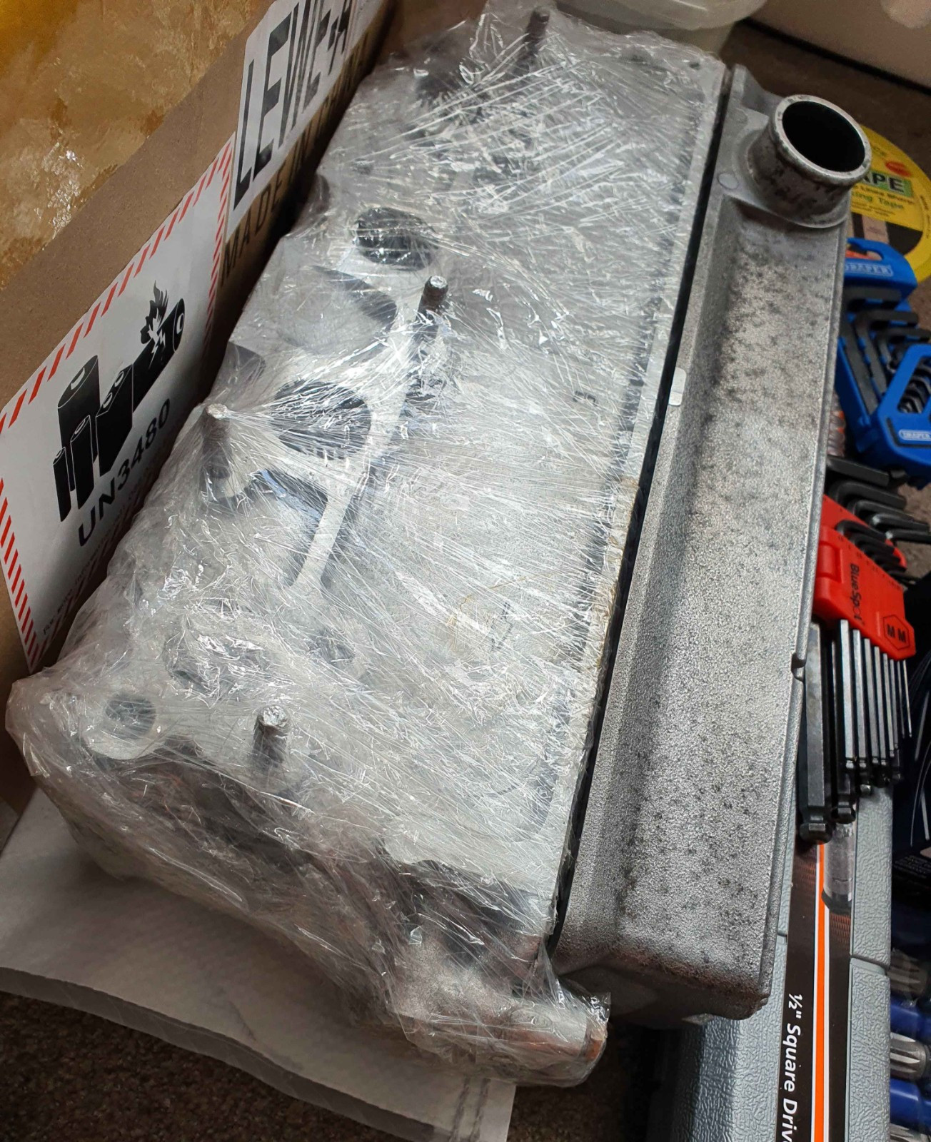

And so I set about starting all the work to give the Polo a bit of a refresh. Took the head off for the first time, did the timing belt, water pump, replaced the extremely crusty radiator. I had also found a ABD 1.4 head from a Golf/Vento with the 032Q cam that had just had a fresh skim and rebuild, so might aswell throw it on there anyways, as I had learned from here that the 032Q cam is a pretty decent oem contender for bike carbs.
After doing the research on bike carbs, and failing to get the thing running on the SPI due to forgetting to tighten down the ground that bolts to the head (something I didn't know was the cause at the time lol), I pulled the trigger and ordered a bike carb manifold, couplers, malpassi fuel pressure regulator to still use the standard fuel pump, and a throttle cable kit to get the thing to run on bike carbs instead. If there was a time to swap it over to bike carbs, it was now!

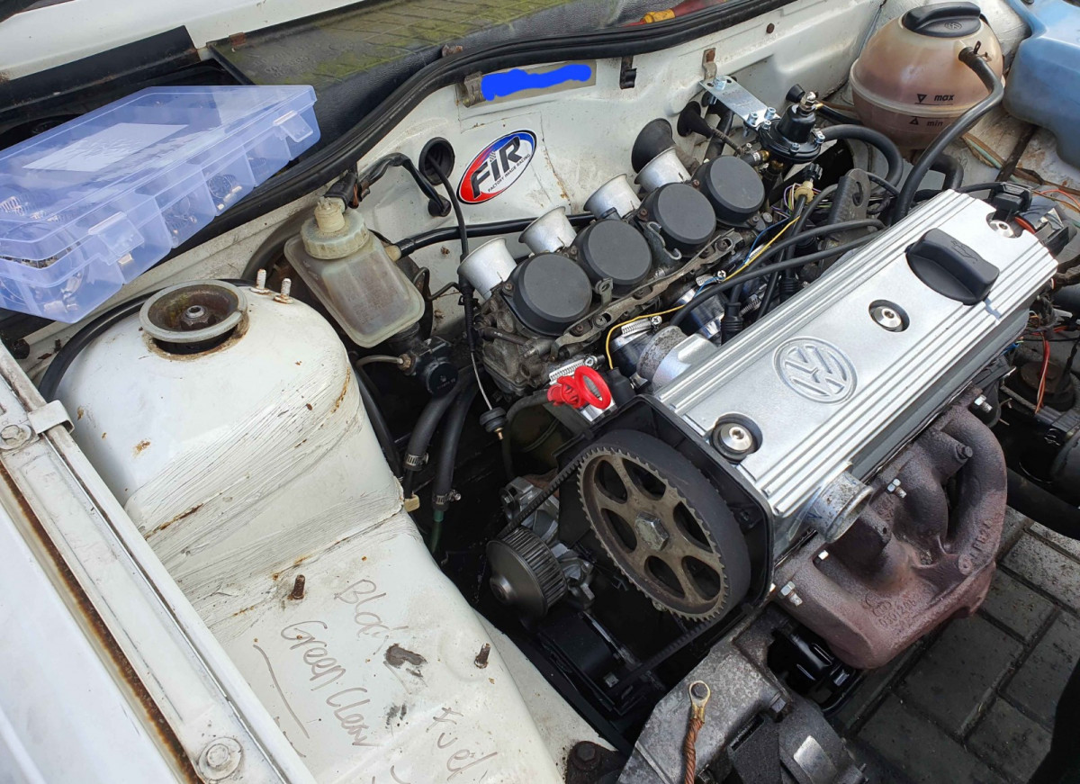

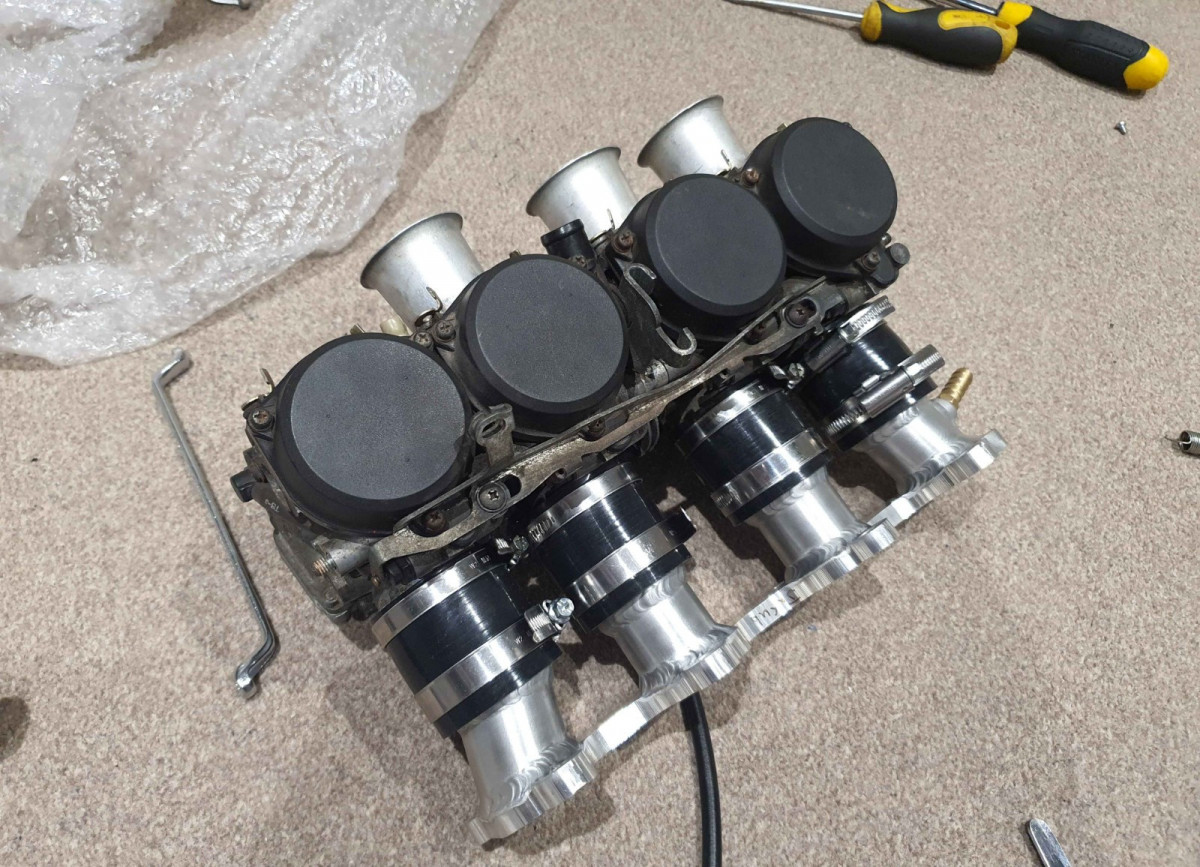

And so a week and a bit went by, and all the bits came. I put it all together and put it on the car as a mock up, to see what I was getting into.
Also got that G40 rocker cover painted up in high temp silver.
And so after the mock up, I plumbed everything in and gave it a go priming the system. Immediately I could smell fuel! As it turns out, the T piece o-rings that connect each pair of float bowls together were completely rotted and split, so I had to go through the ordeal of splitting the carbs apart, and what a faff it was! I bet they were never apart before, as it took me hours to get them to come apart, but eventually they gave in and let me win!
After splitting them apart and putting them back together with new o-rings, they went straight on and all seemed good.
I tried starting it, but it cranked, and cranked, and cranked, and cranked....
Hmm, something doesnt seem quite right. The carbs were spitting some blue debris out of them. Interesting...
As it turns out, the night before I had put blue roll down the intake runners to stop cack getting into the engine, but I forgot I put 2 sheets instead of 1 into 2 of the cylinders for whatever reason, and forgot to take them back out! I had to then pull the carbs and manifold off the car again, and basically with a pair of very long and pointy tweezers, grab all the blue roll out the sparkplug hole and intake runners and get it out. It had somehow wrapped itself around the valve of cylinder no.4! But I was very lucky, no damage was done, and once I put everything back together, the thing came right to life!
Was so chuffed I had managed to do it! And it sounded mint. Got a set of ramair filters for the carbs to stop stuff going in, and fitted up the throttle cable. Had to drill the throttle pedal pivot to get it mounted up, but managed to get it sorted.
After ALOT of woes trying to set the carbs up, I managed to get them to behave fairly well, I had 140 main jets and from what I remember I was still messing around with the idle mixture screws, so I had them at the base setting of 2.5 turns out.

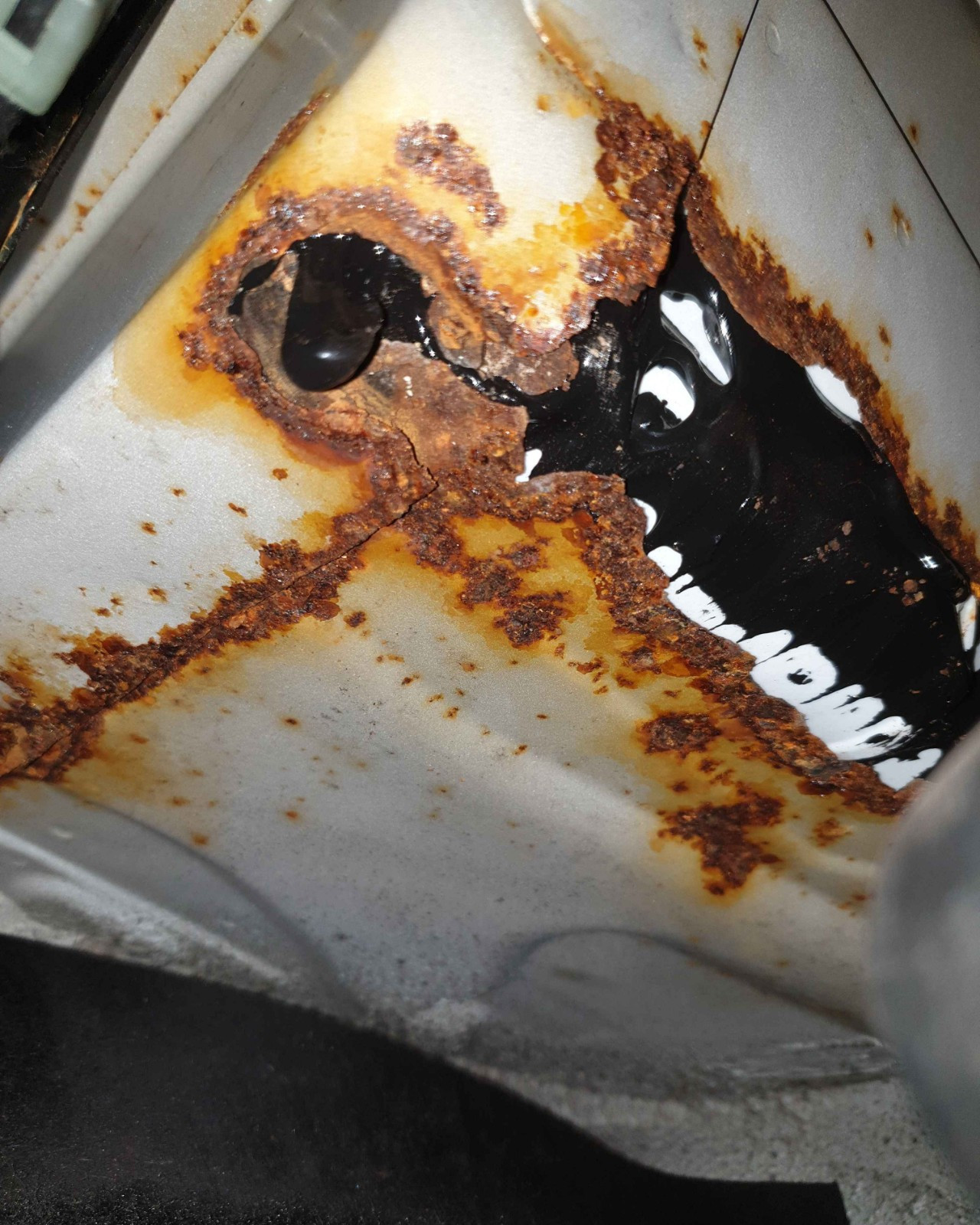

But it was too late.... One thing I had noticed when I bought the car was a little gap in the carpet in the corner of the driver side rear footwell in the corner. Through that gap, you could see there was some rust going on. I was always scared to check it out properly, but one cold day in the middle of January I had a proper look... Not good, not good at all... There was a hole in the floor, and underneath where the seat rail was welded on. I knew I could either leave it, or find out how bad it really was. I chose the latter which may've not been such a good idea. I started chipping away the sound deadening on the floor with a hammer and big flat head, and then I started poking at the rust, it got worse.
And worse...
And even worse...
BALLS!
I thought, what am I gonna do with this thing now! I wouldn't want to see the Polo go to the scrappy. My mates offered to help patch it back up somehow. After I got a big sheet of roughly the correct thickness of steel, I packed it into the Polo and drove straight down to the shed, where ALOT of cutting had to be done in order to get rid of the rust. It had spread all the way down the sill but had been kept quiet thanks to the filler skimmed over the top of the rust, and a spray of black underseal along both sills.
A weekend later, the Polo was more solid than ever before! I couldn't thank my mates enough for helping get the thing welded up and ready to go again.

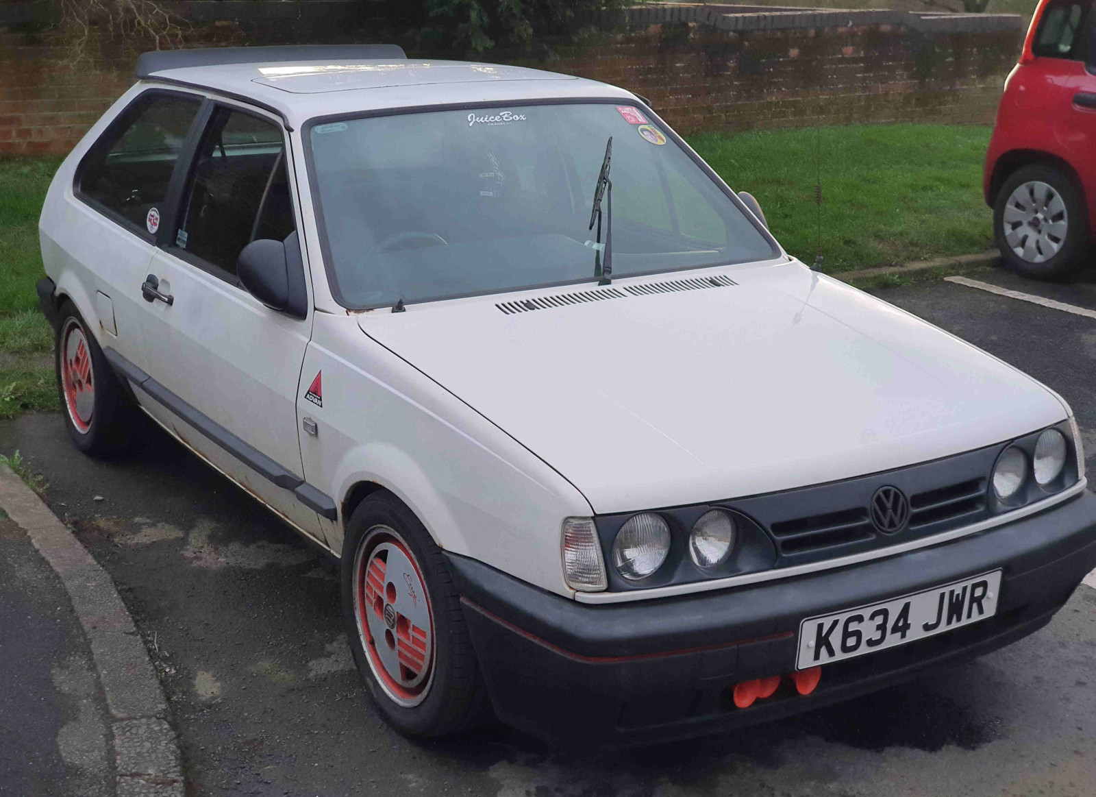

Have you got the morette lights fitted yet? Don't believe I've seen them fitted to a 2f

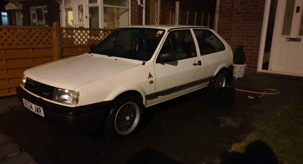

I do! Life got in the way of updating this thread lol.... I'll have to get this thread up to date someday soon when the Polo goes back on the road! Here's a pic of what the front end looked like before it went off the road last summer.
Mate, what a stunner!
