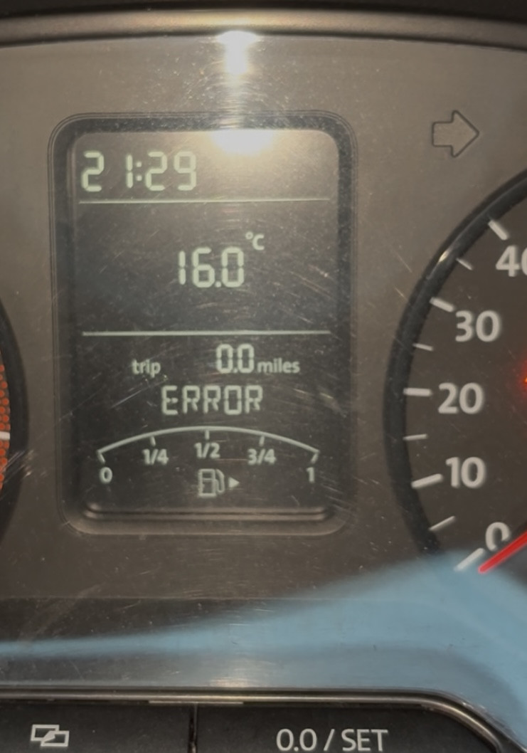

I bought my son a 1.2 2012 Polo for his 17th birthday in December. Seems a great little thing and he loves it.
However it has a few niggles, most I can or have sorted but this one is puzzling me
When you turn the ignition on, you get greeted with a message reading “Error”
No faults in the ecu when I scan it with a snap on diag. The only thing it misbehaves with is when you drive it for a while, the left hand indicator will flash fast suggesting a blown bulb, however all indicators are working
Any clues?

Is it not referring to the fuel gauge not showing the quality ?
That could well be an ECU issue, but equally a lot of things. How in depth is your snap on scanner going? It might be worth giving it a scan with something a bit more VW-specific, such as VCDS.
Edited by Yeti
No, I was just a bit eager on the photo and beat the guage to registering, the car has a full tank.
