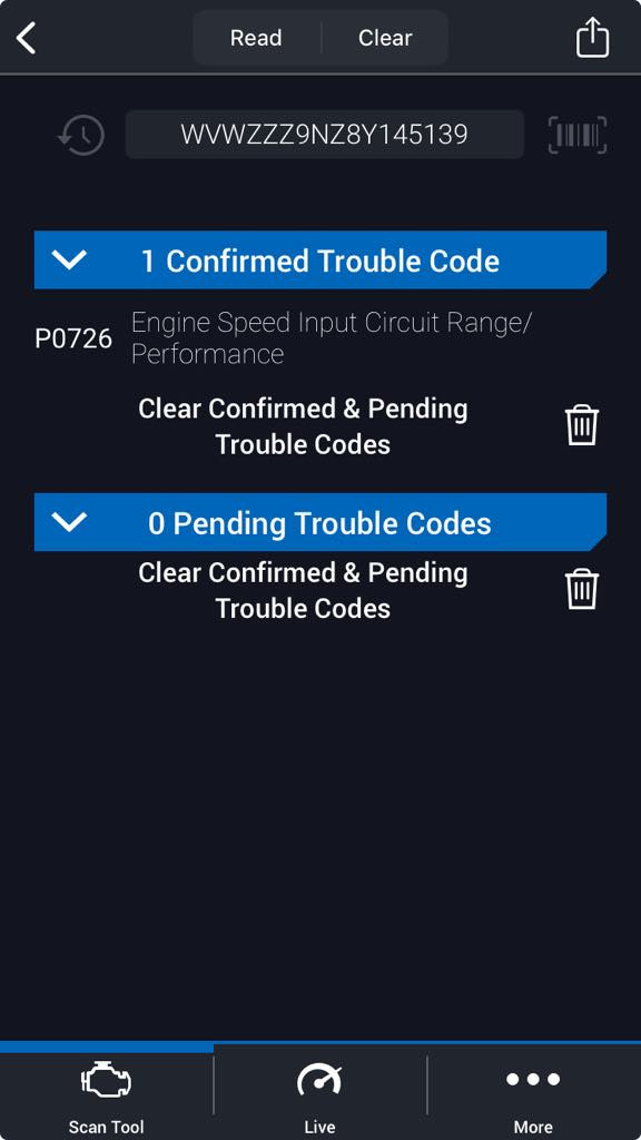

Bought this car a year ago, knowing it had a sensor fault. Vehicle was in limp mode, wouldn't allow me to go over 3,000rpm, and was slow(er) compared to normal. So, I got the sensor replaced promptly, and I thought the error had been resolved. Over the course of the year, I've had this fault come back again, and again. DTC shows P0726 as expected, glow plug & EML on. However, the car NEVER activates limp mode. Functionality of the engine does not change once this error triggers (no reduced power, no rev limitation etc.), and the only way to trigger it is to go above 4,000 rpm. It will NOT trigger any other way. While idling, at times (rarely), the vehicle can feel more "clattery", or to explain better, it idles rougher, and you can hear a change in the way the engine idles.

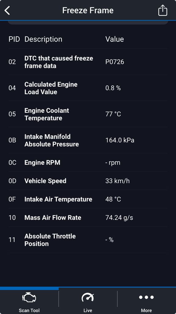

Has anyone came across these issues before, what the hell is the issue with my seemingly dying Polo? (Check the freeze frame of when the DTC triggered EML/GPL. No reading for throttle position or engine RPM's... (??)
