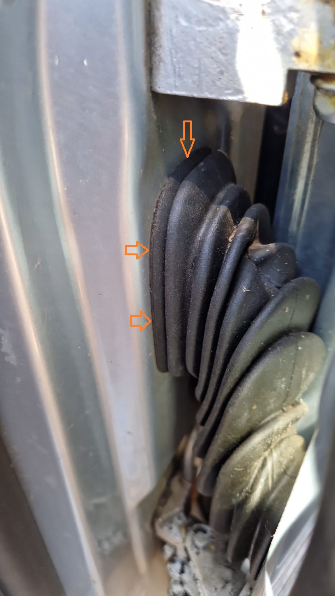

On the 9n/9n3 platform there is the following arrangement at the A-pillar to keep water out of the door loom connections (there being some plug/socket connectors under there, to be able to completely detach door loom):
To waterproof it well, that arrowed area needs to be snug-fitting up against the paintwork.
If never touched since built, or if the rubber has been removed and very carefully fitted back, it should do a great job of keeping wet stuff out of there.
There's a plastic fitting at each end of the rubber bellows that the rubber fits onto, and then that fitting snaps into place in the A-pillar.

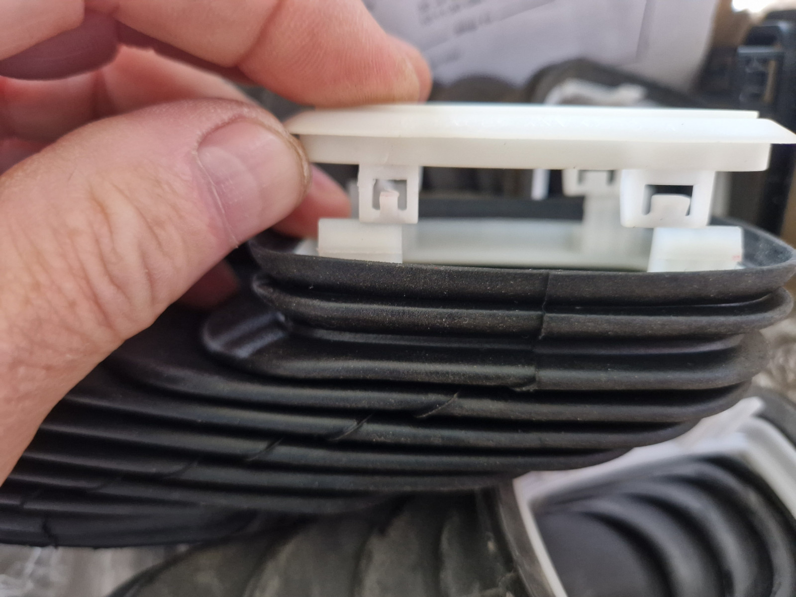

Here's an image of a bellows where the plastic frame has broken whilst being removed. It will no longer hold the bellows up against the paintwork. This is the A-pillar end, the fitting at the door end is different in shape and colour (blue).
If such breakage has happened, or the rubber has been poorly fitted back on the frame that has stayed complete and in position, leaks will happen, and the non-waterproof connectors under there will suffer corrosion damage.

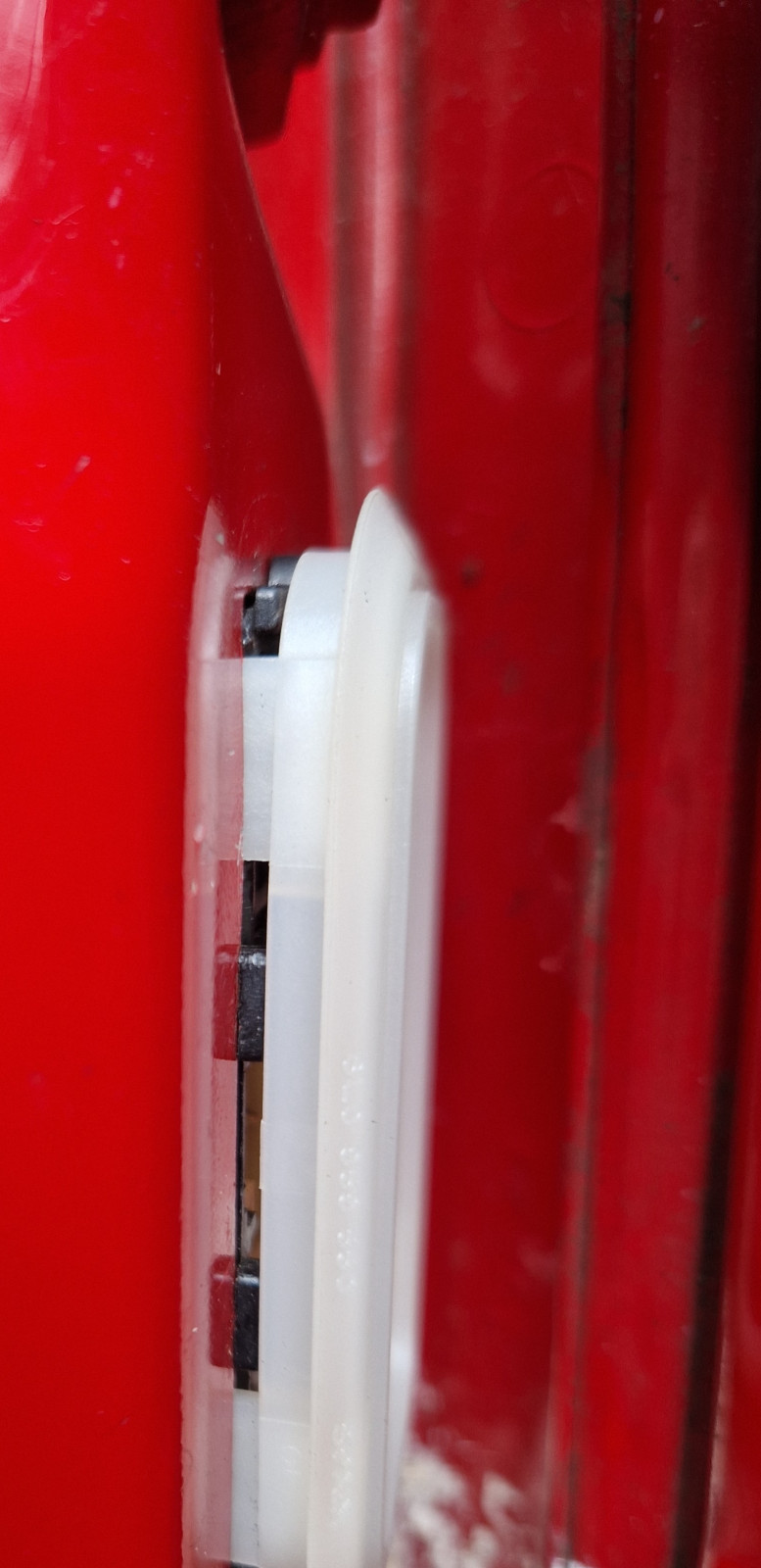

Has anyone near Swindon or Oxford got a 9n/9n3 with this problem? I'm looking for a car with a damaged plastic frame, and consequently a vulnerability to water damage, on which to test-fit a 3D-printed replacement part.
No cost to the first volunteer.
Pics of the printed prototype in the next post.

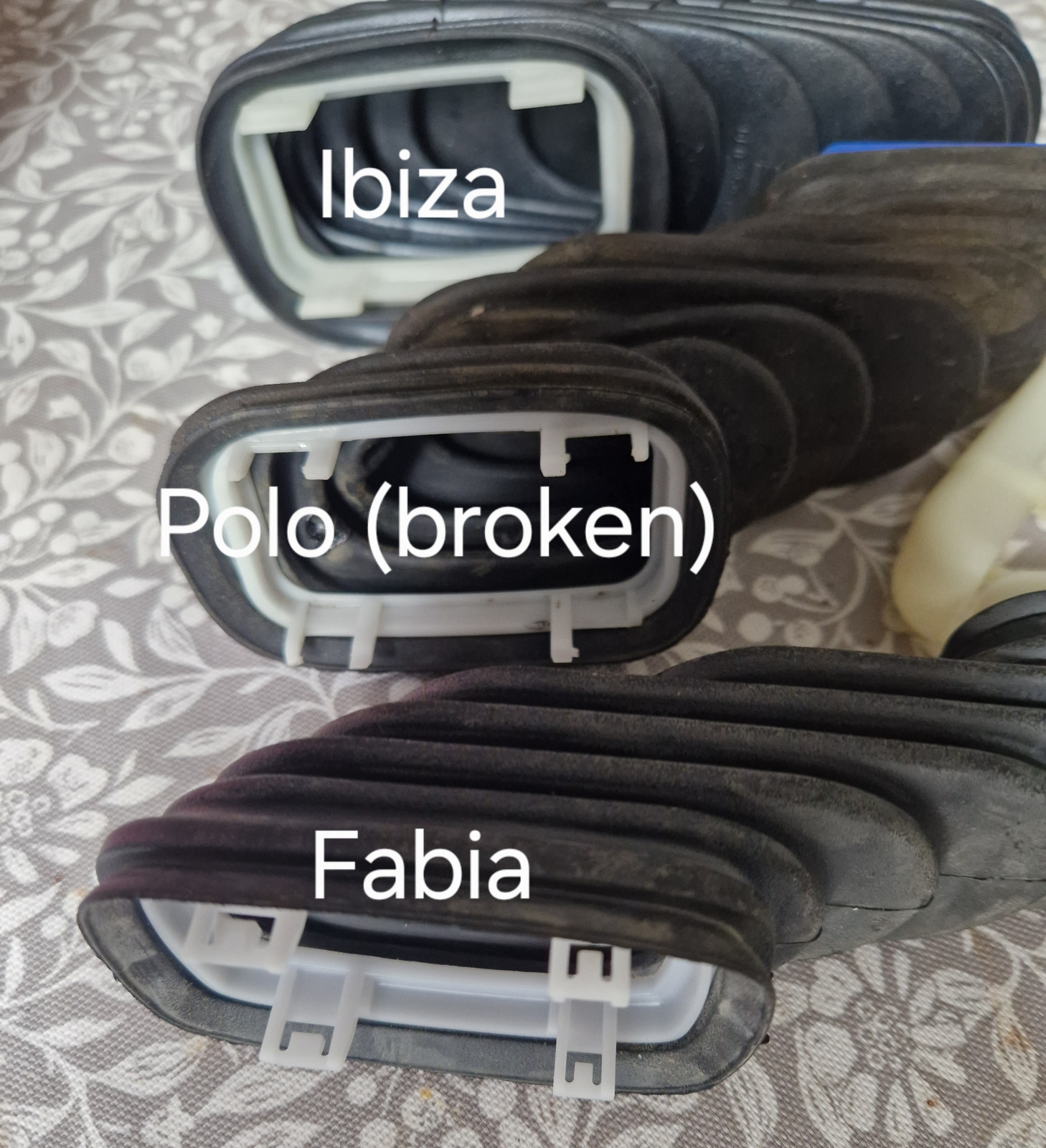

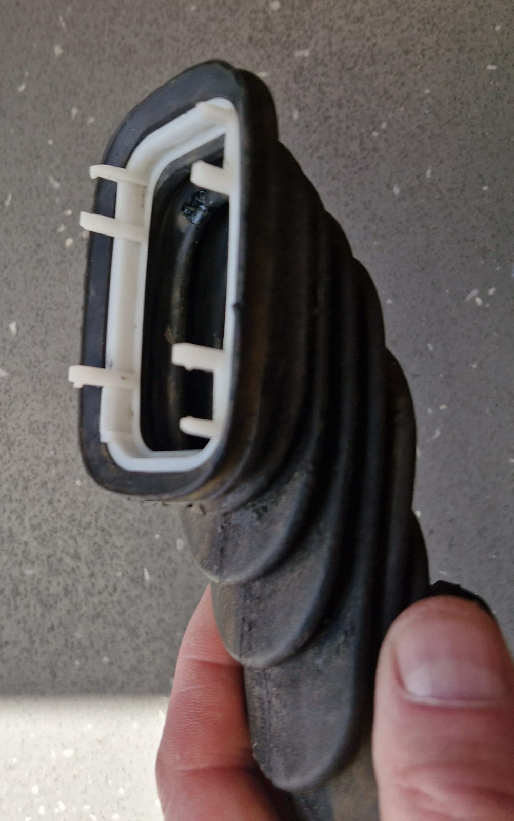

Well deutscheparts did their usual delivery magic via Ebay and got me an Ibiza bellows by yesterday morning.
Part number is 6L0959843, and is allegedly still available from Seat at only £6-£7 territory. Might order a few.
So the three sister cars have three different interpretations of this white clip part. 20250831_091215.jpg
Edited by Pete1
There are some dimensional differences, the Fabia being the obvious odd one out, with different clip widths top and bottom.
Shown against Ibiza one here.
The connector holder that sits in the A-pillar hole has reliefs for these projections/clips. The same connector holder is used in Fabia and Ibiza, but the Polo one is different (connectors are different that fit into it).
I think from looking at the three varieties, the Ibiza one will fit in a Polo, and looks to be the most robust of them all, in terms of being removable without breakage.
I will try to get the Ibiza one drawn up and printed, while awaiting someone with a Polo needing a replacement to test it, and my existing printed ones on. 😁

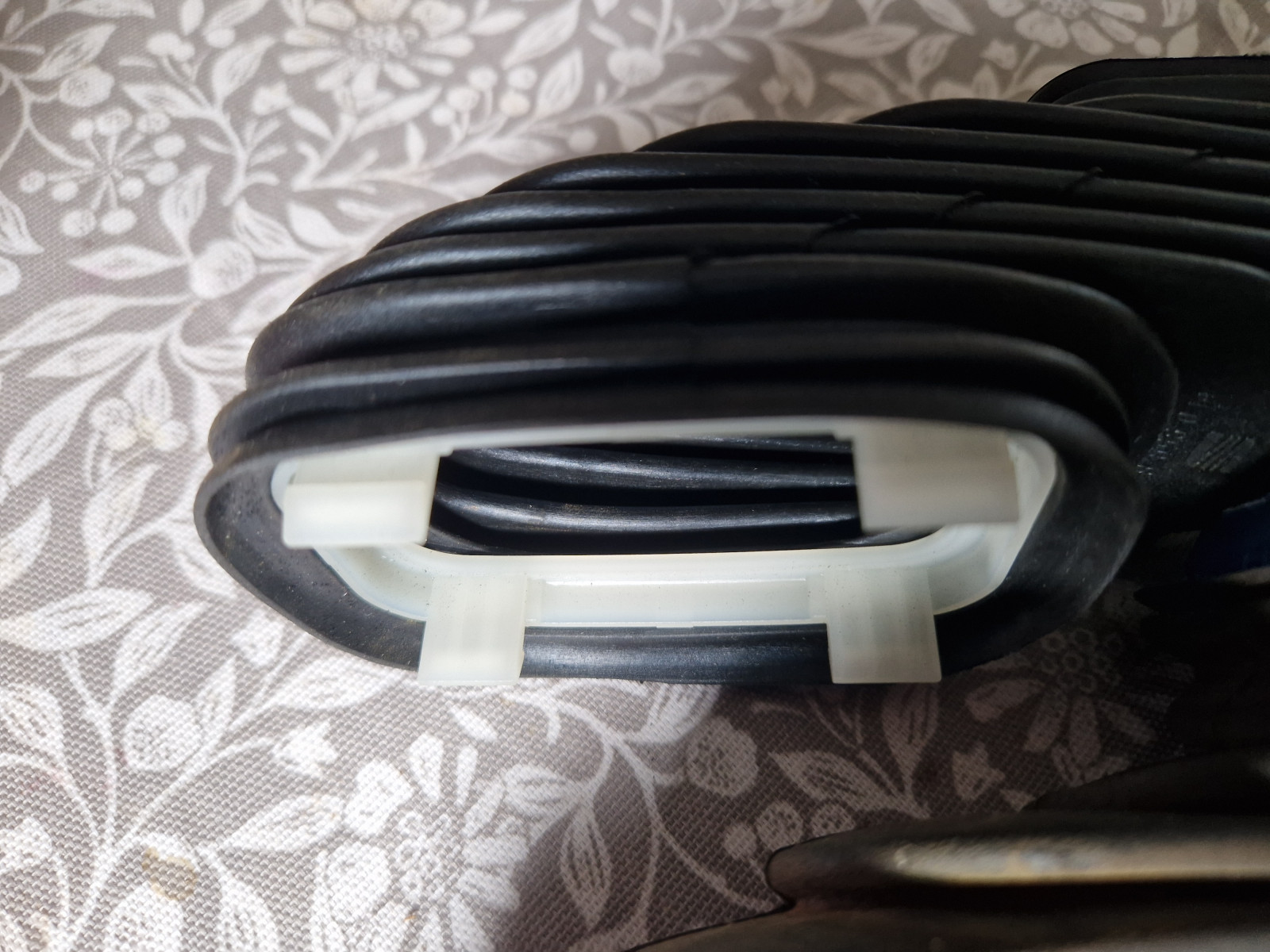

Edited by Pete1

Hi everyone,

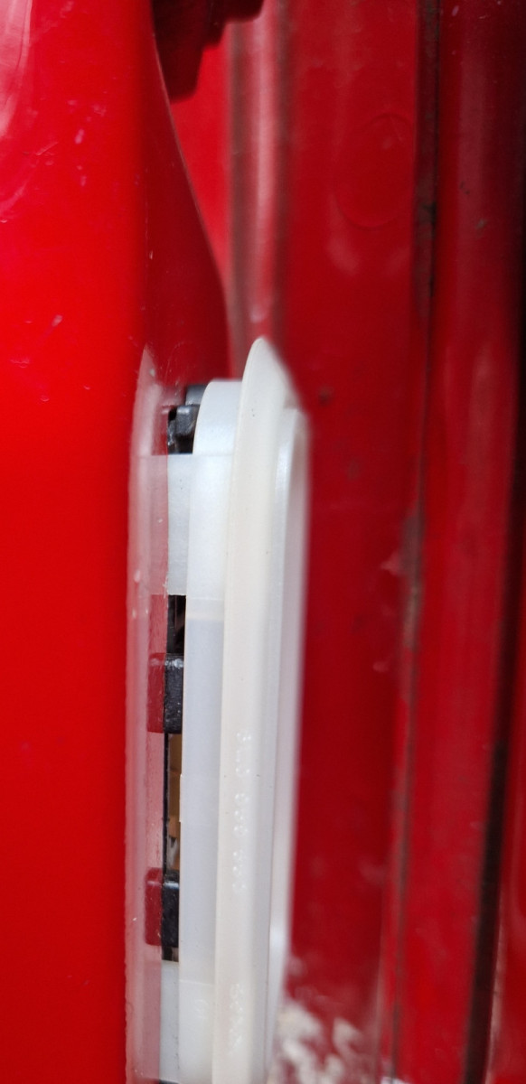

I wanted to share an updated version of the connector holder based on Pete’s original model.
It took me a few test prints, but I managed to improve the design by slightly enlarging the clips. This makes them more flexible and much less prone to breaking compared to the original part.
I printed it in PETG with a 0.16 mm layer height, and it fits well in my VW Polo.
Huge thanks to Pete without the original model this wouldn’t have been possible.
Hopefully this helps other Polo owners who are dealing with the same issue.
Files attached below.
